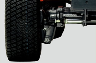

Made me go back and look again at the BX, can anyone tell me what these rod-like things are--axle? steering control arms?--and how sturdy? Whatever they are, they're gonna be in danger of hitting rocks, stumps, dirt. This is one thing I look at on every tractor.
