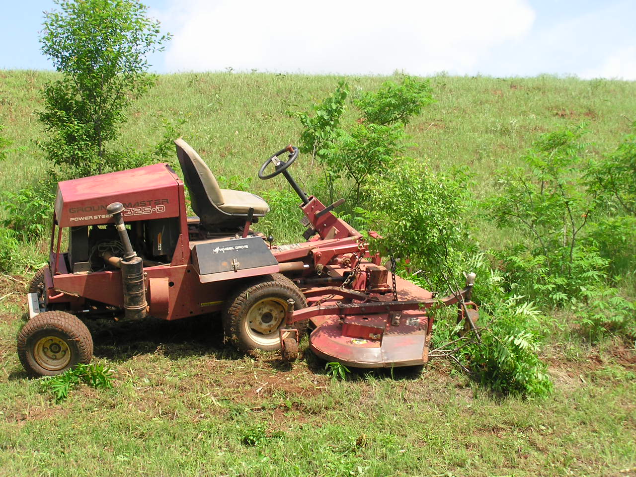

There's a lot of argument about how to go up and down steep hills. I go backwards uphill and forwards downhill. Going forwards up hill it's possible to flip the tractor over backwards. If you do the 3pt won't help- it does not provide down pressure. Instead the implement will be forced towards the driver area as the tractor rolls over it. If you back up the hill you can keep the loader low. If the tractor starts to flip the loader can help prevent it. Ideally you'd have something heavy and low on the 3pt as well.
Downhill the loader again can help out if the tractor wants to flip. If the wheels start sliding you can drop the bucket and maybe slow the tractor down. Don't forget to put it in 4wd before going down a steep hill. I did once. It was exciting and not in a good way.
I leave the loader and bucket on and keep it low.

No, I think you're right. I've scraped and crawled over most of this land with two Husqv's and have a pretty good "feel" for what's doable, which will help. But will have to figure out what this tractor can/can't do.
+1 on the z-turn. Wish list....
