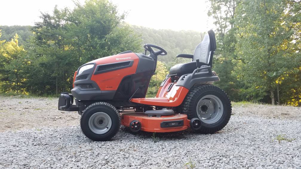

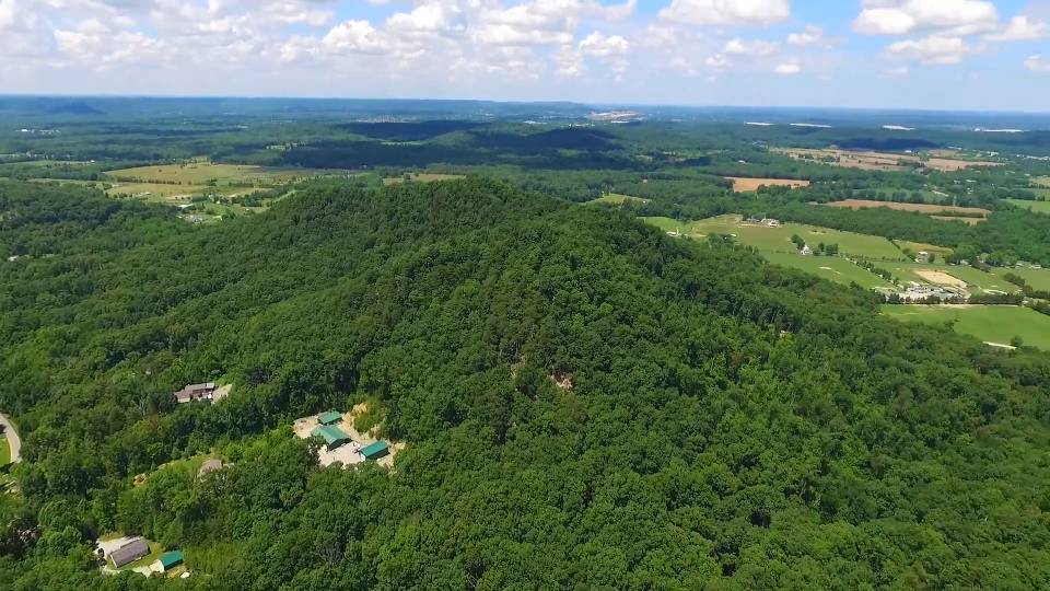

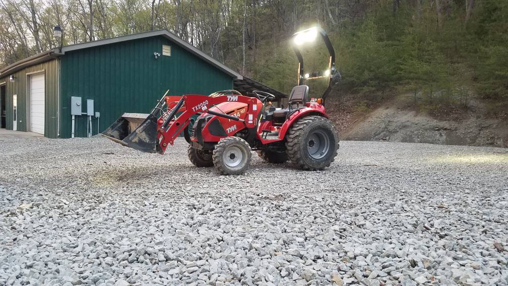

I didn't read all either...but my property is very, very steep and I'll share what I have. My craftsman dys4500 with the k46 and ag tires didn't last too long. I bought a husky ts354 with the k66 and it is amazingly awesome! Check out my property on my other posts. I'm tackling it with a TYM T234. Screenshot_20180106-121926.jpeg20180426_202523.jpeg20180708_201115.jpeg

Your property looks a lot like mine. :) And your Husky looks like a newer version of my 2016. Mine handles all of my property that CAN be worked with no problems. It's one of the larger, heavier garden tractors, and the large rear wheels and wider stance help a lot.
Nice tractor too. Haven't tried my new Mahindra on the steeper parts yet. I'm getting my "sea legs" doing easier things like the driveway. I want to be really comfortable working the tractor first.

Thx. Just remember to leave it in 4wd when on uneven slopes with a load. If the rear wheels come off the ground in 2wd....prob have a bad day. I've had some scary situations arise ....but have always had my grader box or loader quickly dropped to save myself.

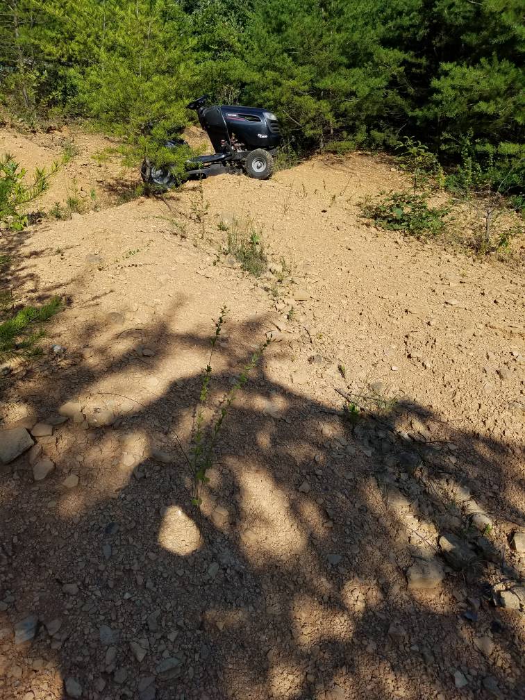

Prob rebuild the old craftsman trans...use it to bushhog20160829_181217~2.jpeg
