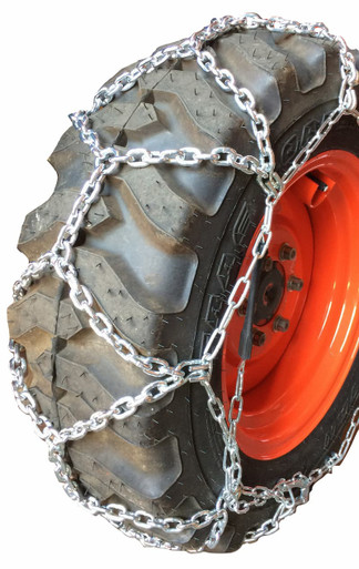

These are studded chains ... Trygg SMT Flexi Alloy Tractor Tire Chains | Tire Chains 'R' Us
There are more ... Tractor Tire Chains for Sale | Free US Shipping
I bought these for my truck from the same place, they are standard "ladder" chains, they won't provide as much lateral (side to side) traction as the first link, although studs will help, so will "V-bar" cross links ... But if you can make pickup truck chains fit, they are not bad price ... Well, I just checked when I got this link, and they weren't when I bought them this fall, now about doubled in price in two months!
I bought the optional "cams" to tighten them, this is open, or loose ...
By putting the included wrench in the slot, by twisting it 180°, and it takes up the slack in the chain and tightened it!
With the cams, I didn't really need the spider, and I only tighten two of the four cams!
These are "4 link" as in counting the side links, the cross links tie on on every fourth link, they make "2-link" which are better for smaller diameter tires, and smoother ... But heavier and more costly as they have double the cross links ...
