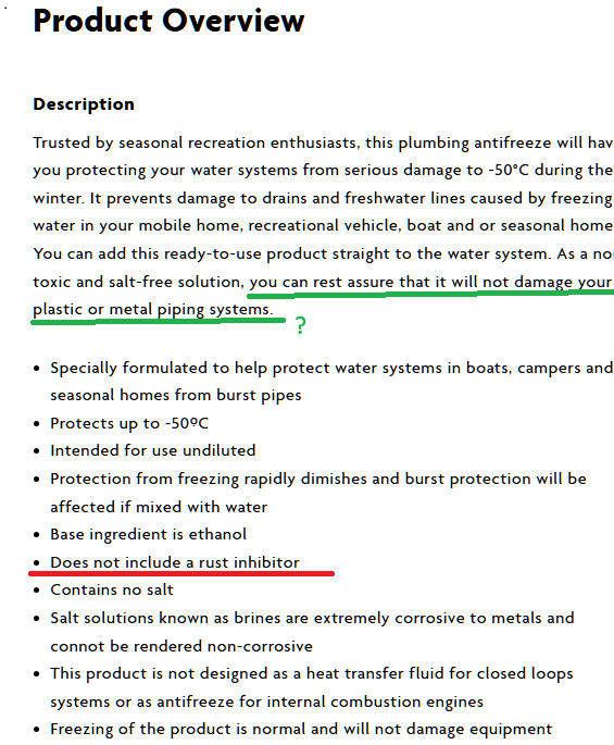

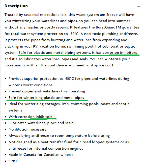

Something I just found out about RV anti freeze which I assume is the same as plumbing anti freeze just different description?
There are two different types, for plastic pipes only and for metal and plastic. The plastic only is corrosive to metal. I was wondering why the almost 50% more in cost for different brands until I noticed the description on one that noted "For plastic pipes only" I thought wth ohhhh crap.
Sure enough, it's what I use to winterize my pressure washer once I blow the water out of it. I just opened a new jug month or so ago and poured some thru the pump and I have a clear hose on the outlet so I can see the pump is full.I went out and looked, sure 'nuff the inch or so of fluid in the clear hose had turned brown with rust.
View attachment 4239957 View attachment 4239980
View attachment 4239981 View attachment 4239982
Ya, you definitely want the stuff with the rust inhibitors, which is the only reason I added some in with the WWF.

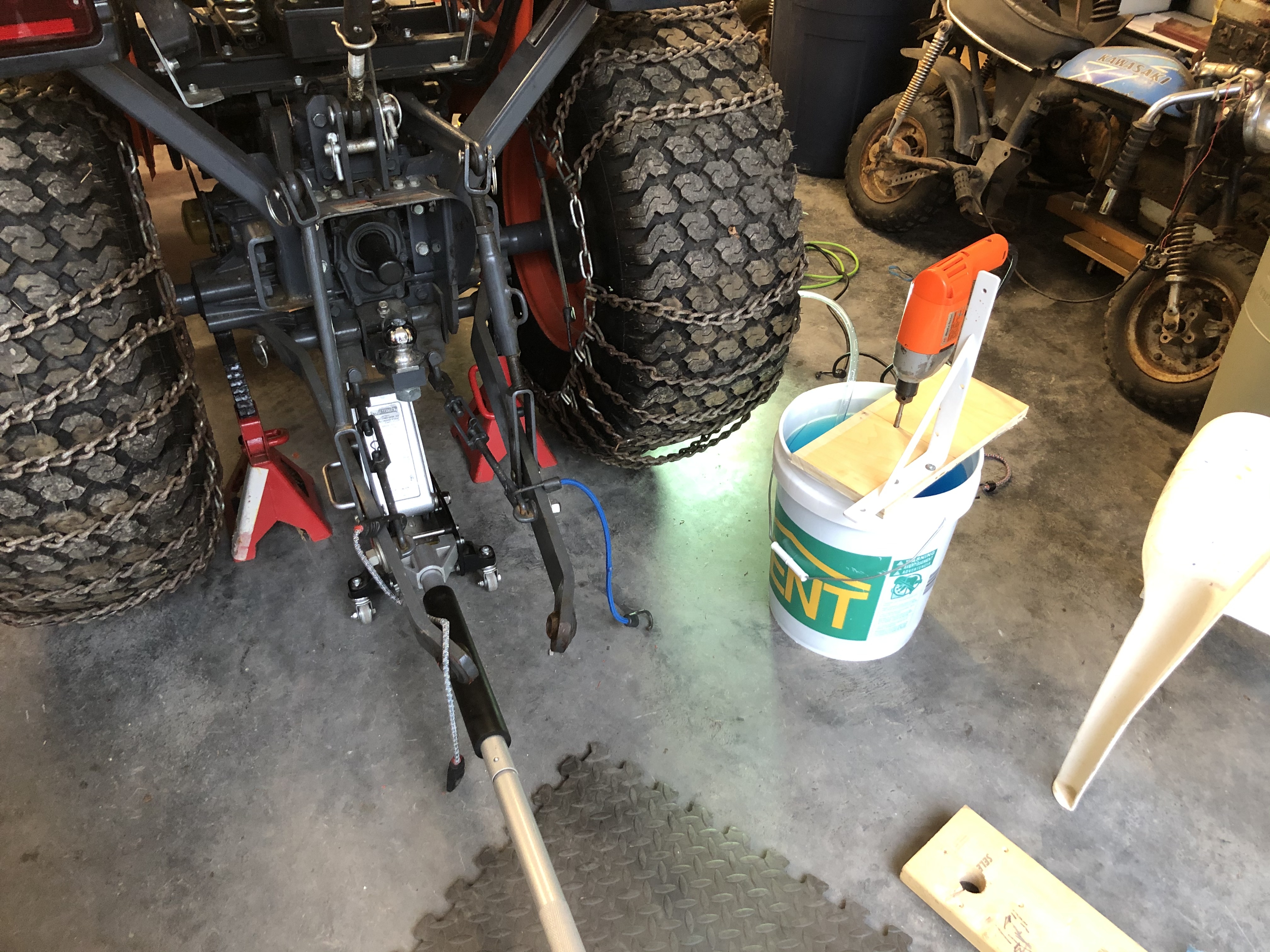

How much fluid burped out each time? That's what I wanted to contain, but maybe I was overly concerned about it.
Almost nothing for me. I shut the pump off, hit the burp valve and maybe lost half a teaspoon with each burp. You can see the burp valve button right next to the valve stem in the attached photo.
