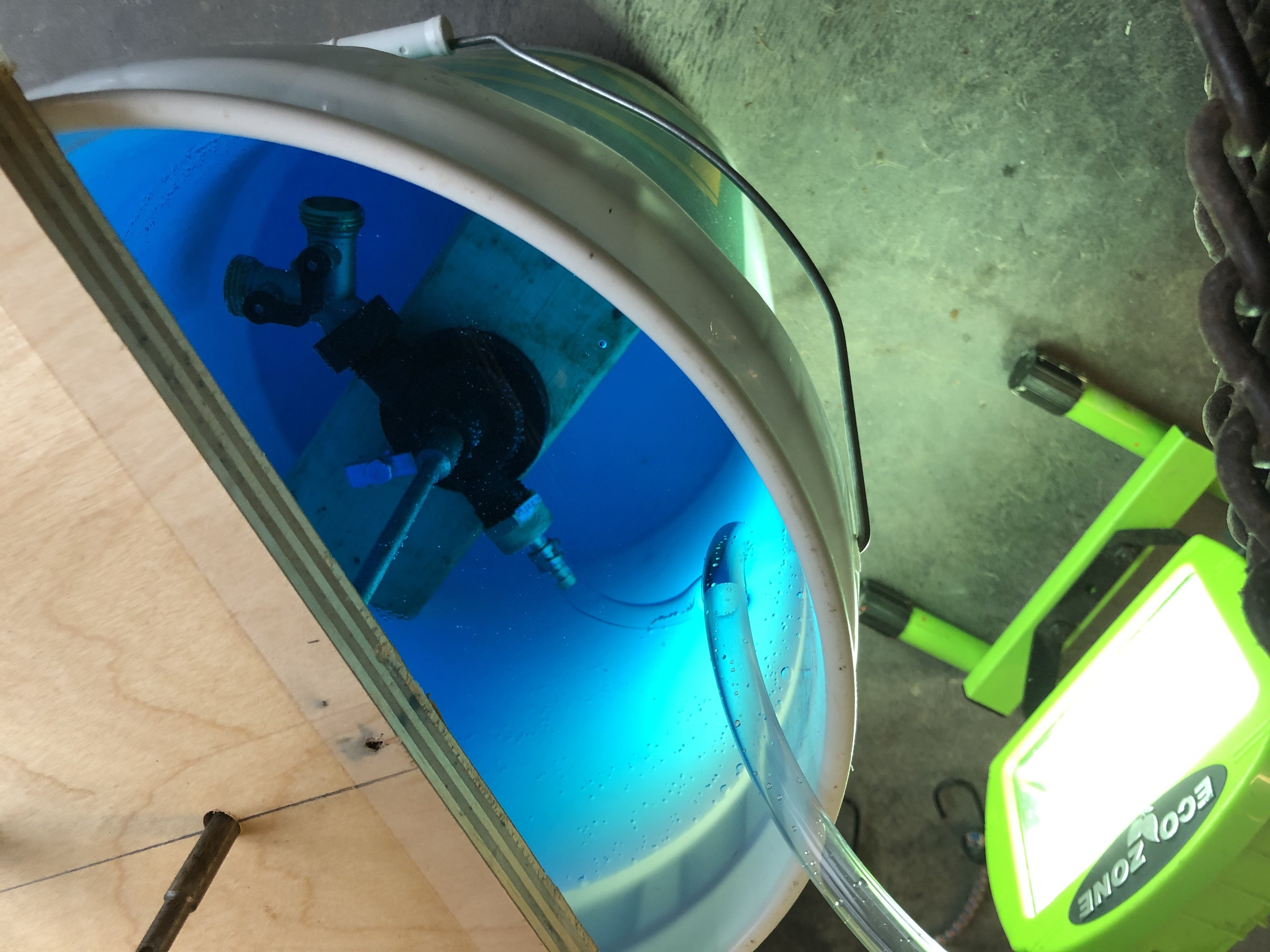

Filling tires with ballast at home.
   / Filling tires with ballast at home. #11
Living in the desert, freezing is not a big issue. It does get below 32, but it warms up during the day to above freezing. No issues for 20 years. I did add a couple of gallons of RV antifreeze to each tire as a little buffer for the colder days, and since water could cause rust in the wheel, I added 2 cans of auto water pump lube in each tire as it minimizes rust in the system and doesn’t hurt rubber.
   / Filling tires with ballast at home. #12
Thanks for the post - always interested to see how folks accomplish this task. Tractor owners have discussed/debated/argued/fought over what to use for rear wheel ballast for many years now. Rather than stoke those fires, I thought I would use the latest version of ChatGPT (AI), and I asked this question:

what's wrong with water?? now I'm in Australia before you shout dumb question
#14
Nothing at all. Best choice, as long as freeze protection isn't required.

   / Filling tires with ballast at home. #17
Does ballast affect the handling of the tractor?
Yes. Better stability, obviously, but also a rougher ride with much less compressible air volume remaining in tire. All of these liquids are non-compressible, from the practical standpoint of tire pressures.

   / Filling tires with ballast at home. #18
How much did the antifreeze cost you?
I bought the little valve years ago and just never got around to filling them. It is something I still want to do. I am in southeast Tennessee and we rarely get temps below freezing for days on end, but it does happen. I think I could get away with a mix of water and some type of antifreeze. Interested to hear some of the responses as it has been a while since I have looked into this.
   / Filling tires with ballast at home. #19
Thanks everyone. I need to do this with my JD 2038R. I wonder how many gallons needed? An AI bot says about 35 gallons per tire. It has ag tires -- need real tires in the dirt and moving around in the foothills.
   / Filling tires with ballast at home. #20
AI is just an automated web search robot that doesn't know if its right or wrong.
Question... how do you know when you are at the level you want?
