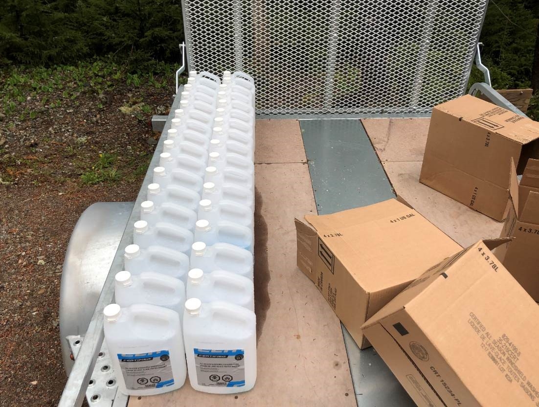

I found my notes of the details of the fill that might be useful to anyone with same tires. I filled my rear turf tires that are 33 x 12.5 - 15.
I did not fill to 75% because I don't like to accidentally inject any kind of liquid into my tire pressure gauges when checking air pressure. What I did was fill to where I had to rotate the tire to about the 2 o'clock position before the WW fluid started to come out the valve stem.
To each tire I added exactly 64 litres of WW fluid which equals 142 pounds. With my setup using a cheap drill-driven pump and a burp valve, I was able to fill each tire in 50 minutes and that includes burp time.
Of course the lads and Canadian Tire store thought I was nuts buying so much WW fluid.
