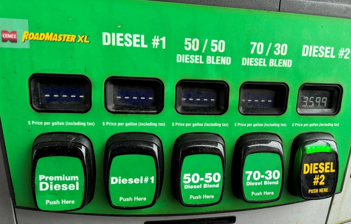

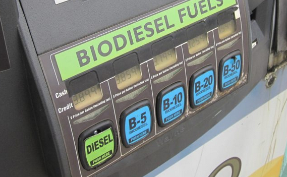

How do you know B5 from B100?
I never noticed on the pump where I buy my tractor fuel any "B" information.
