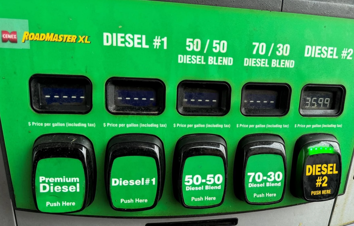

my Cenex pumps lists its choices.
My Shell station only list premium and regular diesel.
I guess its up to the station??
and what fuel you choose to use can make a big difference.
   / 9 Worst Things You Can Do to a Diesel Engine #32
Apears to be a canadian problem.
The pumps I go to offer diesel fuel, the pump next to it offers kerosene.
If I want gasoline, that is a different island and there are three choices.
#33
nope... not a Canadian problem as we don't have Cenex stations.
These are American pumps
I would guess coming to a station near you eventually as the laws keep changing on us.
