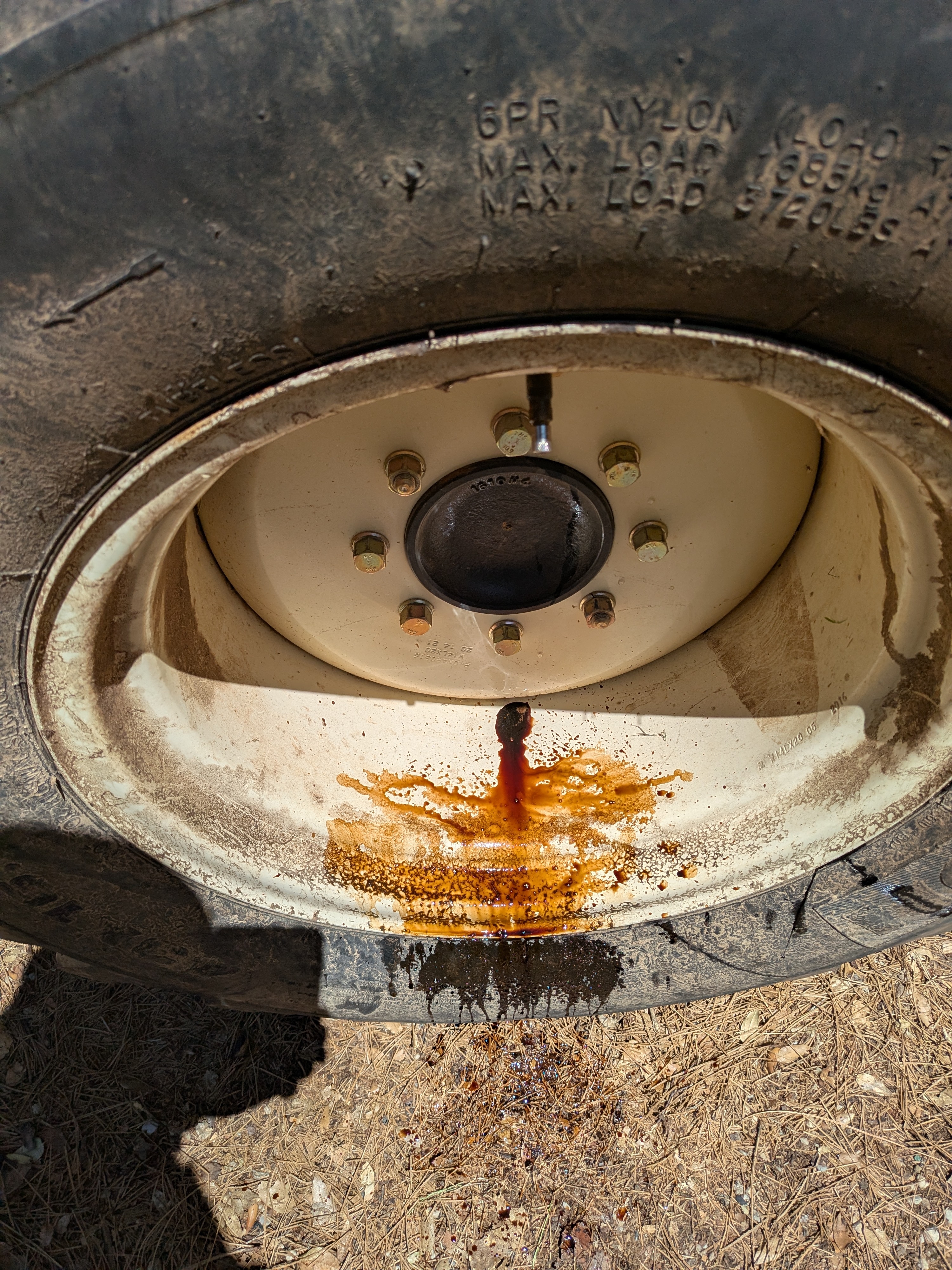

I went to check my rear - filled with scrumptious beet juice - tires.
I parked with the valve at the top last night. Today I figured, press the button to eject what little juice may be left in the valve, check pressure, then fill.
I got about half a cup and stopped.
Did they fill the tire completely? I thought they left an air space?
/ Checking filled tires pressure #2
There is supposed to be a little airspace but it could be filled slightly above the stem.
/ Checking filled tires pressure #3
Filled tires should be checked with stem on the bottom; which requires a different air gauge.
The normal fill is 70%. That is approx. level with the stem; completely filled is not good.
Jack up that wheel position, then check air pressure.
The usual air pressure is 18 PSI for a filled tire.

Mine did the same thing, mostly on one side. I let some beet juice out.
Even with the special gauge I find that I have to rinse out the gauge immediately or the beet juice will start drying inside. I carry a pan of warm water out to the tractor.

With the proper gauge it does not matter where the stem is with the proper type of gauge.
Yes, you must rinse the gauge thoroughly after use or it will become plugged up and useless.
If the pressure is low the weight of the tractor could squash the tire a bit causing the liquid level to be higher than the stem positioned at the top of the wheel.
With a standard gauge I would put some air in it and then to see if I could get it to stop squirting fluid and then let some air out if there is too much rather than try to check them if they could be low.

Tires should be inflated using the tire load charts for your anticipated loading.
Rear R1 tire pressure will normally run from 10-25 psi.
Here is a clip from Goodyear Titan for a 16.9-28 bias ply tire, with road speeds and loading. Also these are per tire so double that per axle.
Most manufactures will have these charts for your tires.
Also filled or not the pressures are the same.

What is a "special gauge" for filled tires? Link? Name?
/ Checking filled tires pressure #16
Do a search for gauge for filled tires. The ones I have are spring loaded plunger style so must take reading with gauge on valve stem.
Others have a gauge with a piece of hose between gauge and chuck. This keeps the fluid from getting to the gauge.

Milton model S-298 is designed for use on fluid filled tires. You do need to rinse it out with warm water after use or beat juice will set up and make it sticky.
