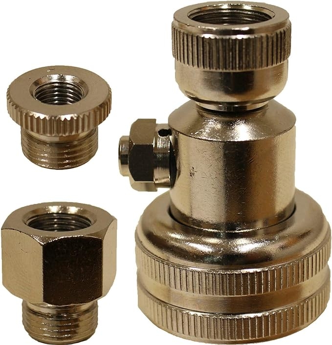

One of the rear tires on my old Kubota developed a leak on me today (it's only 50 years old, POS :)), tried airing up but it only lasted 45 minutes... The tires are old Bridgestone with all the weather checks but good tread of course (no lug separation or anything though). I think it's got a tube in it judging by the plastic nut on the valve stem, tire is filled, still has most of the fluid, doesn't smell like anything and clear, calcium?
How hard is it to extract the fluid from the old tube? Drill pump with the tire fill adapter easy or more complicated? I could rig up a venturi vacuum pump into a 5 gallon bucket, I is a redneck after all :). Possibly drilling out the valve stem and inserting a tube for a fluid extractor or something too...

Found a monday delivery tube, ordered some big patches with it, will stop at HFT tomorrow for a fluid extractor and drill pump to use with my liquid fill kit I ordered.

I would drain the tire, that is actually the easy part.
You should have a two piece liquid fill valve stem remove the small portion and using a liquid fill adapter.
You can drain it using air pressure, inflate the tire roll the valve stem to the bottom and the air pressure will push the fill fluid out, keep air air up as needed. It will get most of the fill out that way, if you allow the tire to flatten while doing so. If you can use a hill to help with elevation change once you get most of the way empty the siphon effect will get most of the last out.

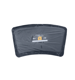

Then clean and dry the inside of the tire and patch and reinforce the bad area of the tire with "tire boot patches" they are stronger then tube patches and actually have cord and a tapered edge.
Blackjack actually has boots designed for sidewall application, to reinforce the sidewall of a tire and prevent the crack from pinching the tire or admitting debris in to damage the new tube.
Sidewall Boots Archives - BlackJack Tire Supplies, Inc.

That's the kind of patch I got, there's some 4x6" patches that should work good. I also got one of those fillers, the tube only has one valve stem.

I see what you mean about the two part valve stem now... there is a joint in the middle...
I have no doubt I could fix the tube unless the issue is at the stem which at this point it's better to have a spare tube just in case...

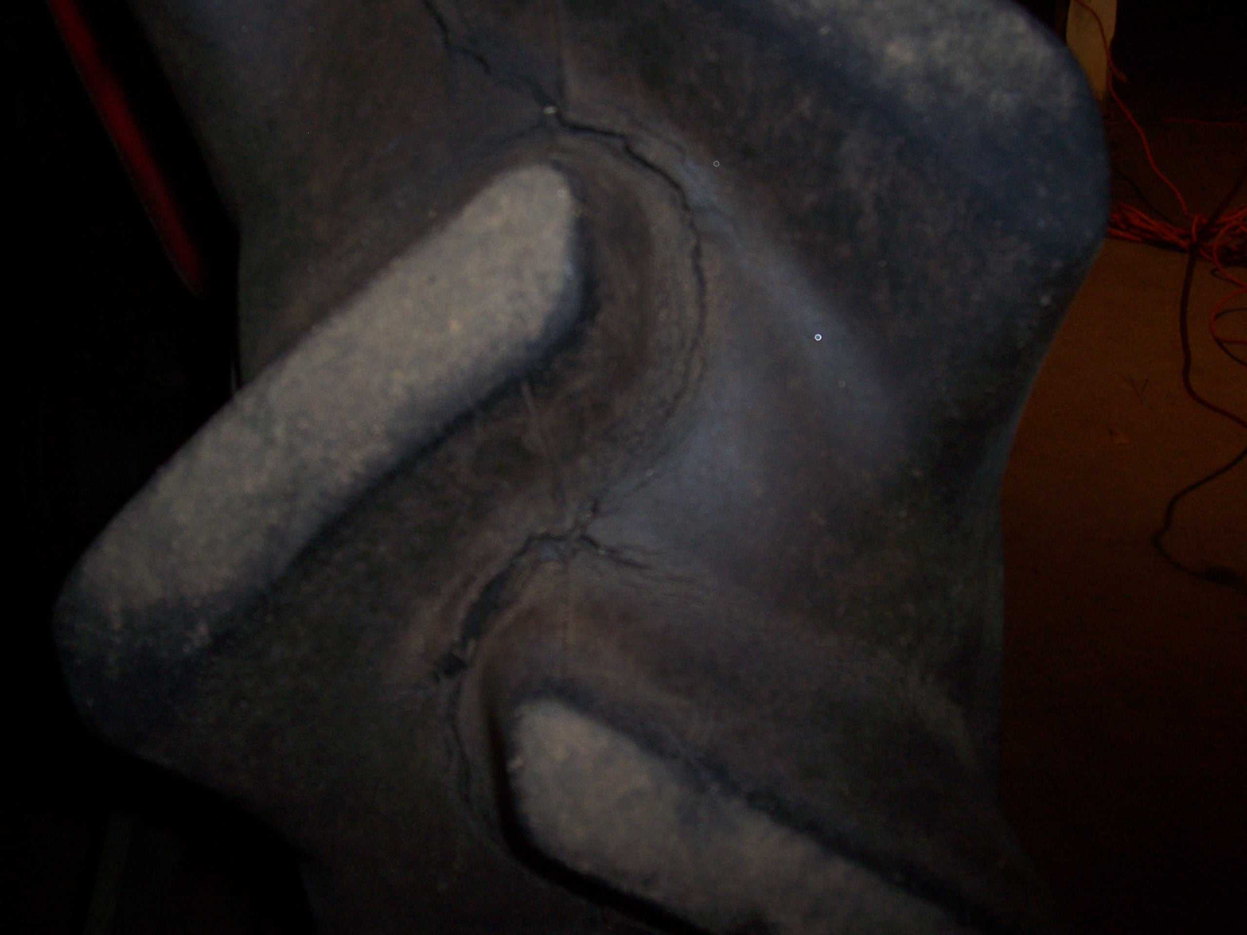

On my Bridgestone 9.5/9-24 on a 45Yr. old Yanmar. Which is basilcly my lawnmower also. I had dry cracks that started to split. Gempler has or did have a complete Full tire insert reline. New tubes !!
I really had no choice to repair or replace both. When I bought the tractor from a dealer he told me what to do if or when I have problems. Which I had to call back Yrs. later and ask where he got them:rolleyes:.
They was showing cracks at the lugs back then in 2008. Which are still huge. The reline was in 2016 Hundreds of Hrs on them and not the first complaint. Back then it was Real Cheap with the tire shop install and cost was less than 1 new tire. what they look like today. Covers the side wall also

Oof, haven't looked this close at the tires before... they're pretty cracky...
drained like 17 gallons out of the tire so it didn't lose much fluid... the inner bead broke easy, the outer bead broke me, I gave up for the day, I only have a 4 pound duck bill hammer handy and I went around the bead twice and it didn't budge so I went inside and bought one of the screw type bead breakers, will be here Wednesday... if I could move the tractor I might have tried the lip of the bucket but don't want to risk that mess while on jackstands...

Tire shop had problems breaking the bead. I had no choice at the time trying to repair it. They had the hammer out. Sure did! But hey they only had to break one so the Reline insert was easy! Esp. 1 piece.
