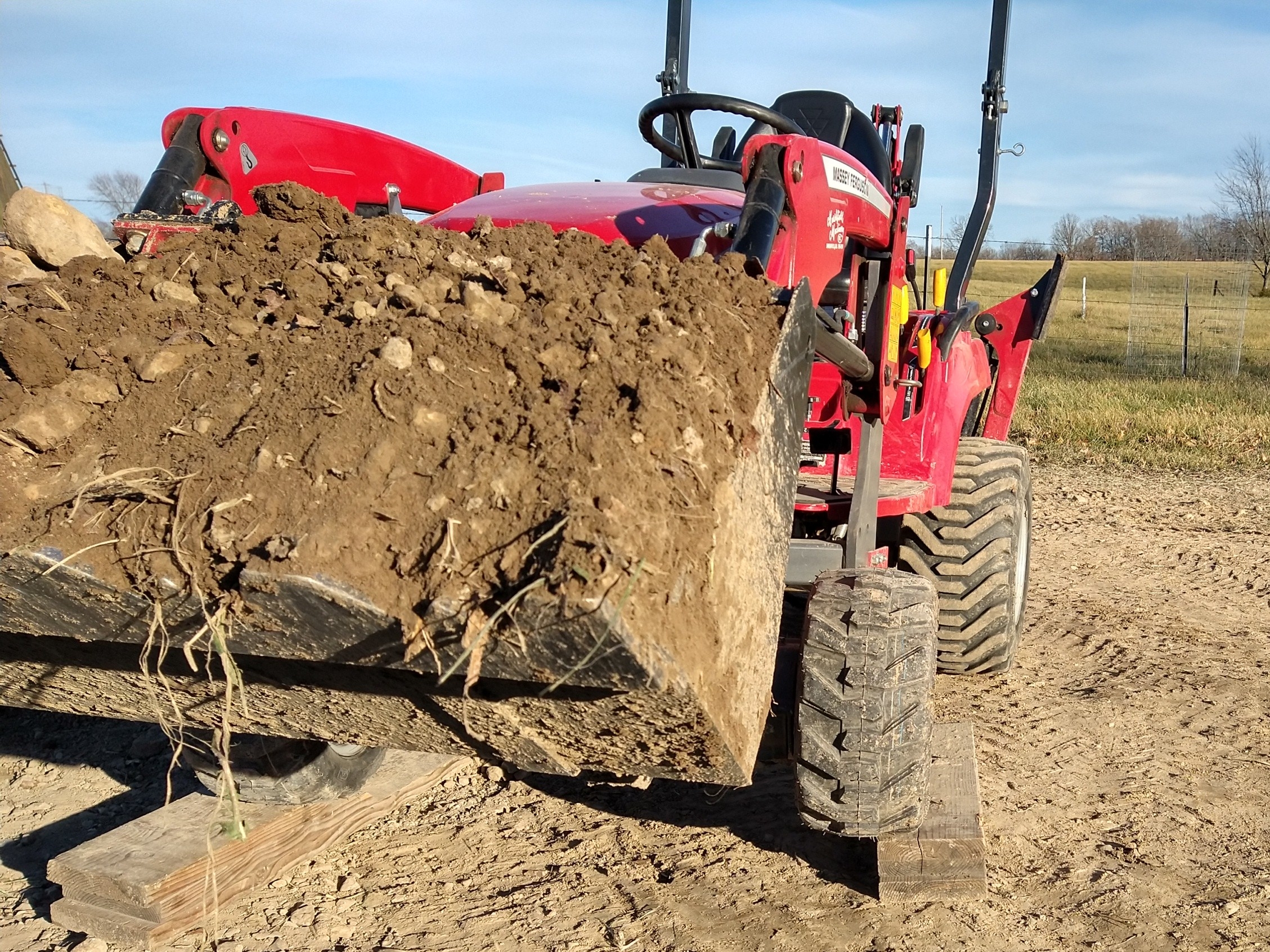

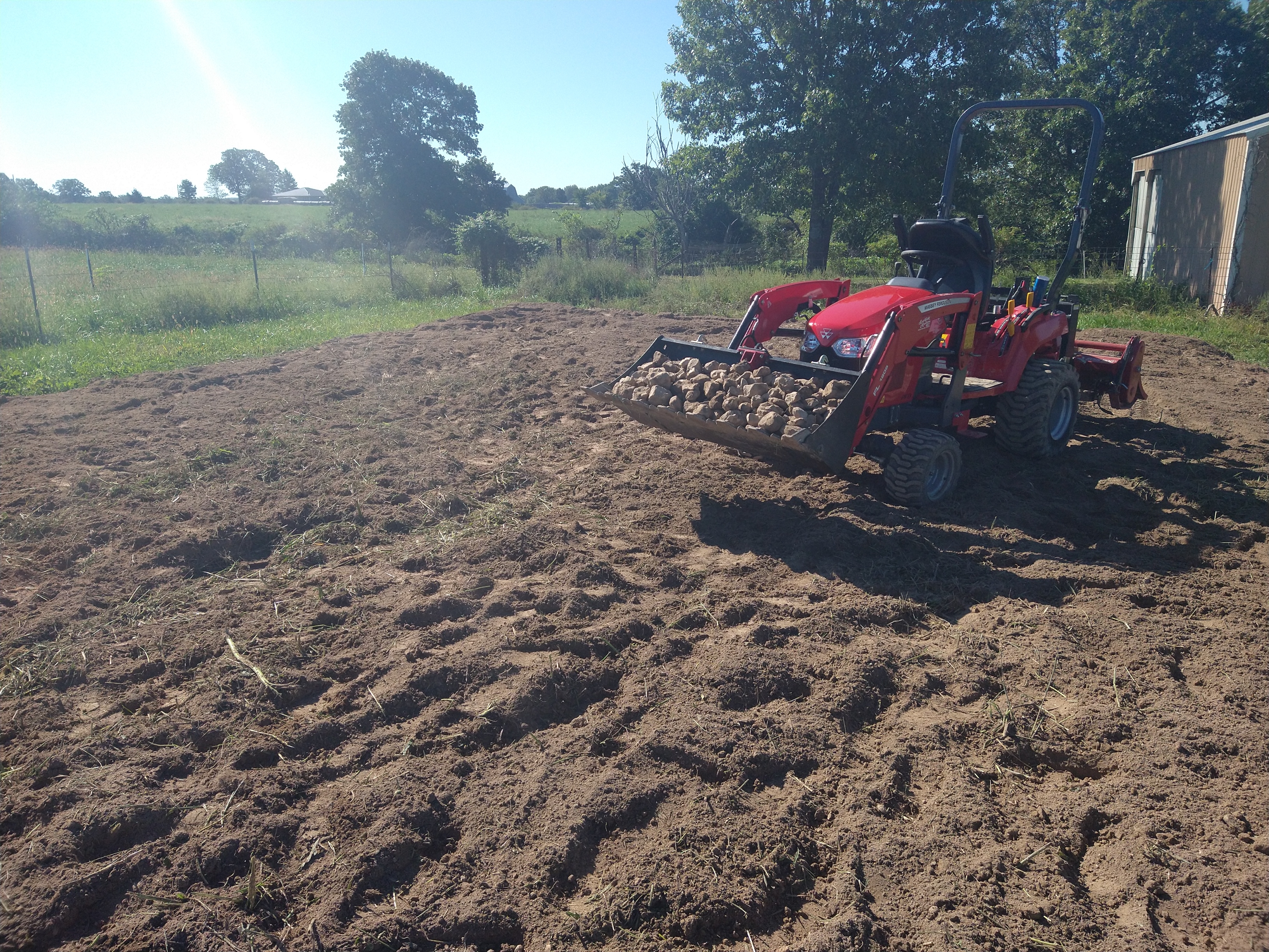

Front ballast is primarily used when lifting something heavy on the back, or pulling hard on something in the ground, like a bottom plow in a dirt field.
Here you can see that I added rocks to the bucket as front ballast to offset the heavy and long brush hog as I creep back into the creek bed, and want the front chained tires to pull me back up!

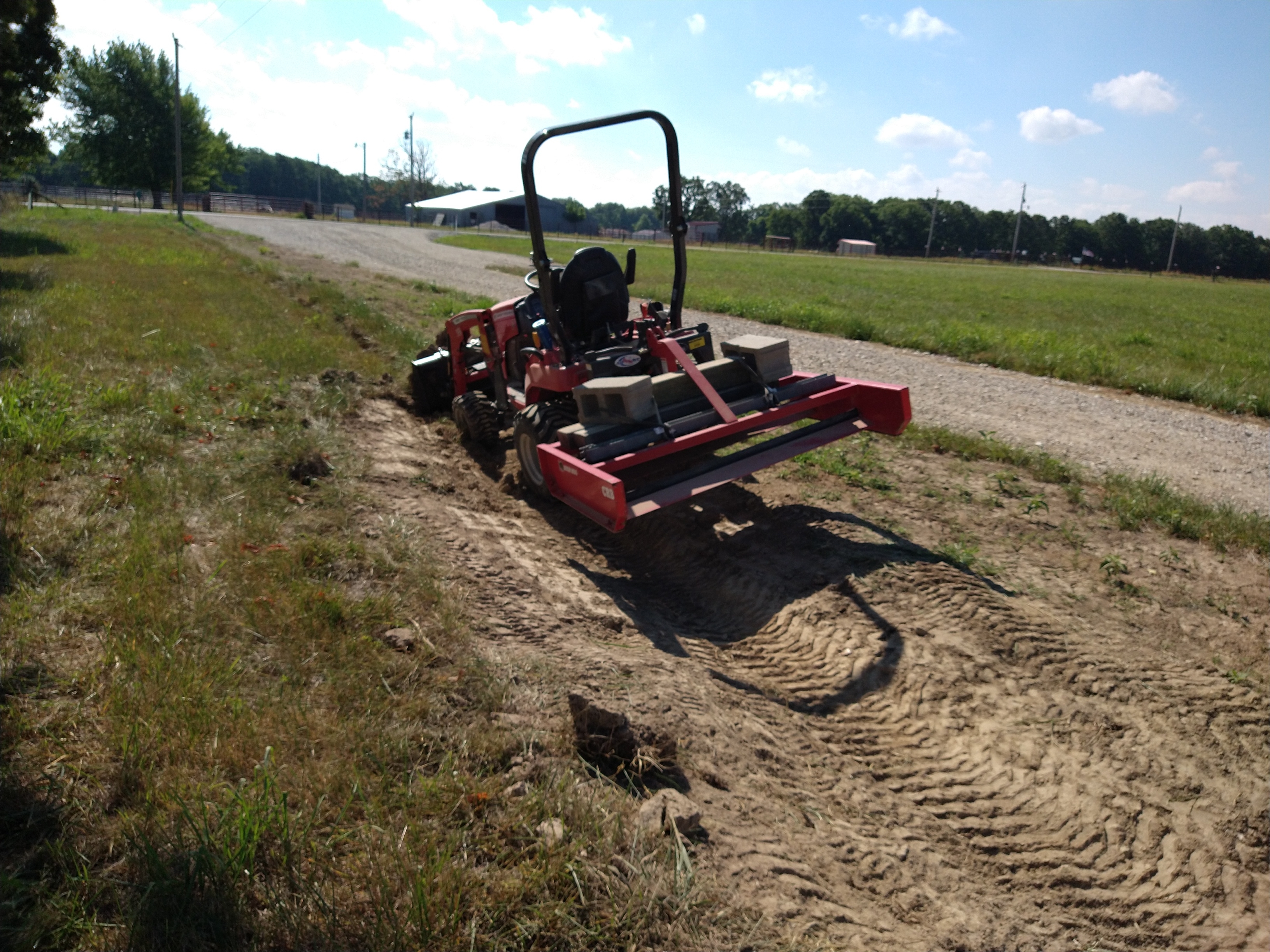

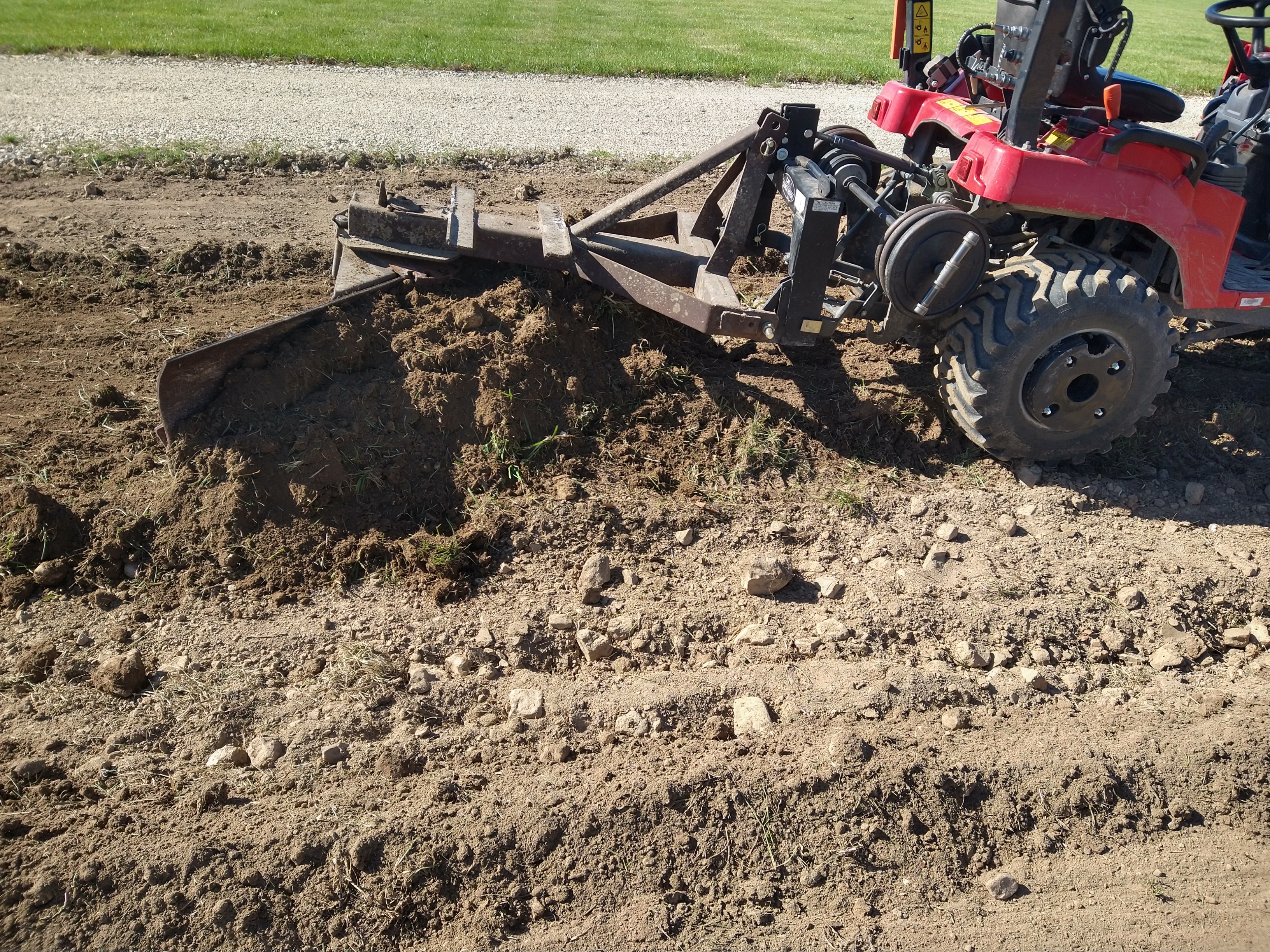

Tire/Wheel Ballast is primarily for TRACTION. (Sometimes confused with “rear ballast”)
Here I've added 275 Lbs of steel weight lifting plates to the BH frame to give me TRACTION ballast to assist the filled tires and steel wheel weights, while pulling a full load of dirt with the rear blade, since the weight of the blade is on the ground, it does help traction, since it's angled, it will try to push a light rear end sideways ... Not now!

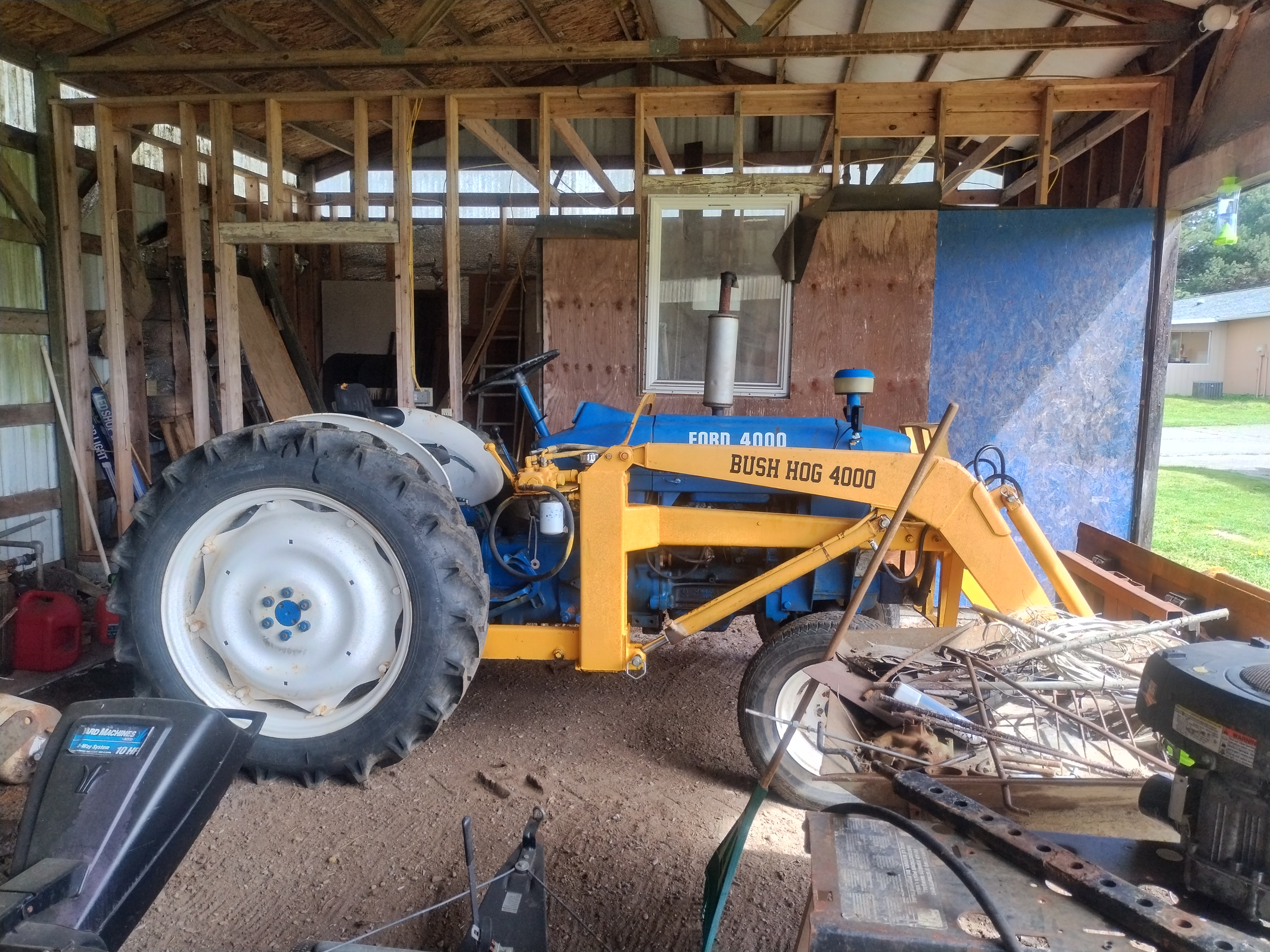

For example when I took off the BH (651 Lbs) to put on the rototiller … I thought that was fine, as I had an attachment on the back … rototiller weighs 351 Lbs plus the 69 Lb quick hitch … how much do you think this load of rocks that I hand filled the bucket with that I “harvested” out of my “garden” weighs?
Sometimes I used my land plane (285 Lbs), but added a couple of hardwood timbers, a steel I-beam and a couple of cement blocks… was it enough? No way! (Now I know!)

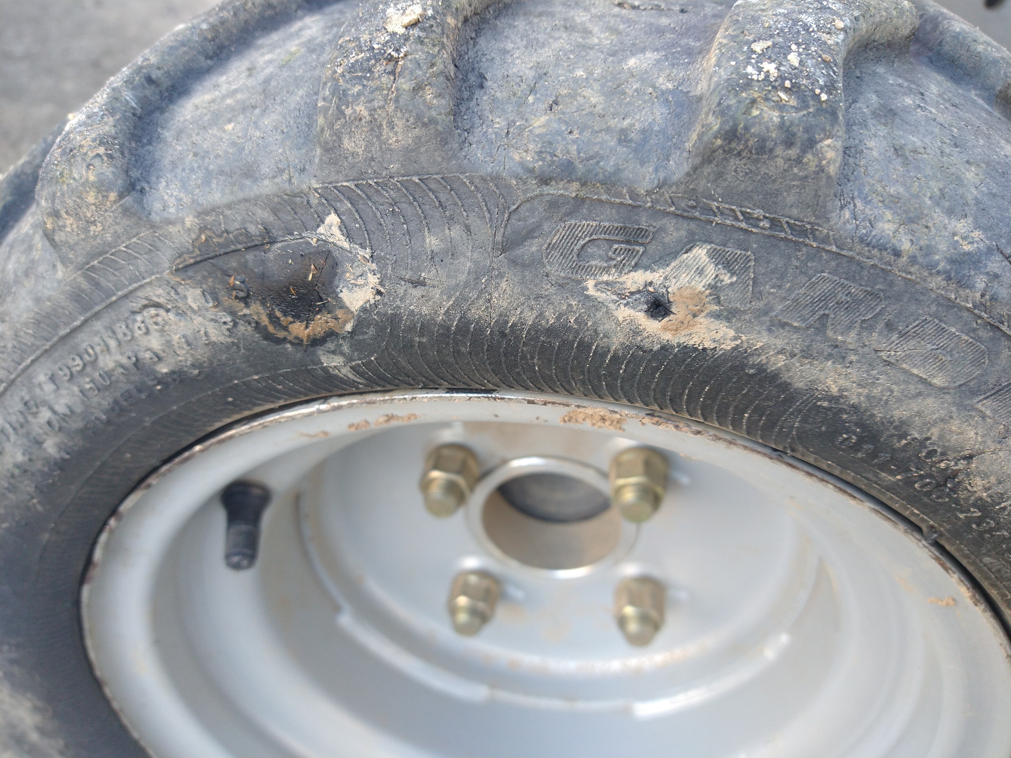

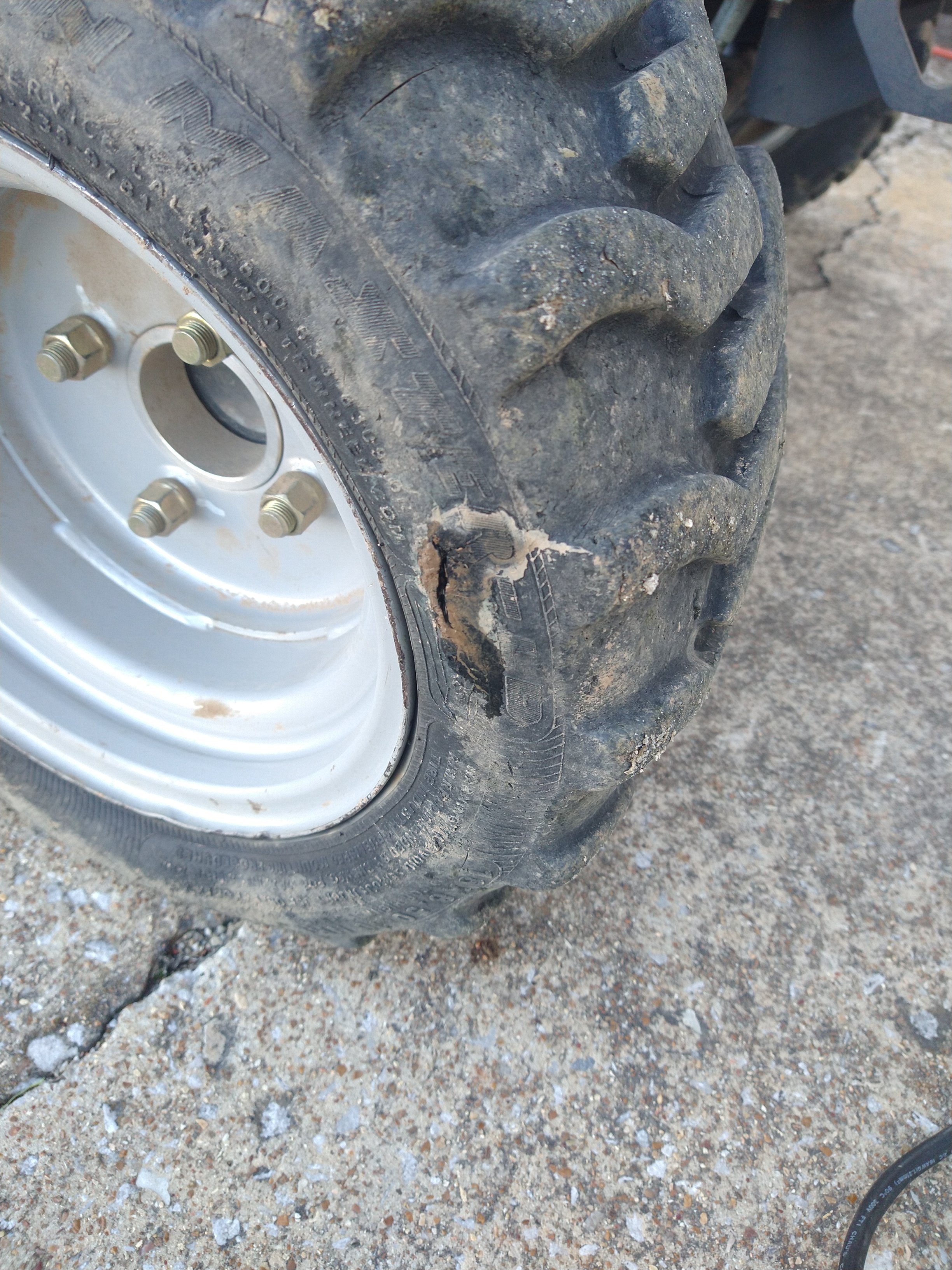

At 347 hours I had to replace my front R4 tires, as the sidewalls were getting “cut” or maybe just failing? I have lots of rocky ground where I live, and I had filled the front tires with windshield washer fluid, so the leaks were obvious!
I decided to replace the 4 ply rated tires with 8 ply, as even with the tractor manual saying to inflate to 22 PSI, and the tire sidewall said the same, the poor little tires would “squat” under a full load at 22 PSI, sometimes it looked like the rim was almost on the ground! I figured if the hydraulics would lift it, it was “OK”! I ran the 8 ply’s at 35 PSI, sidewall said Max at 44 PSI!

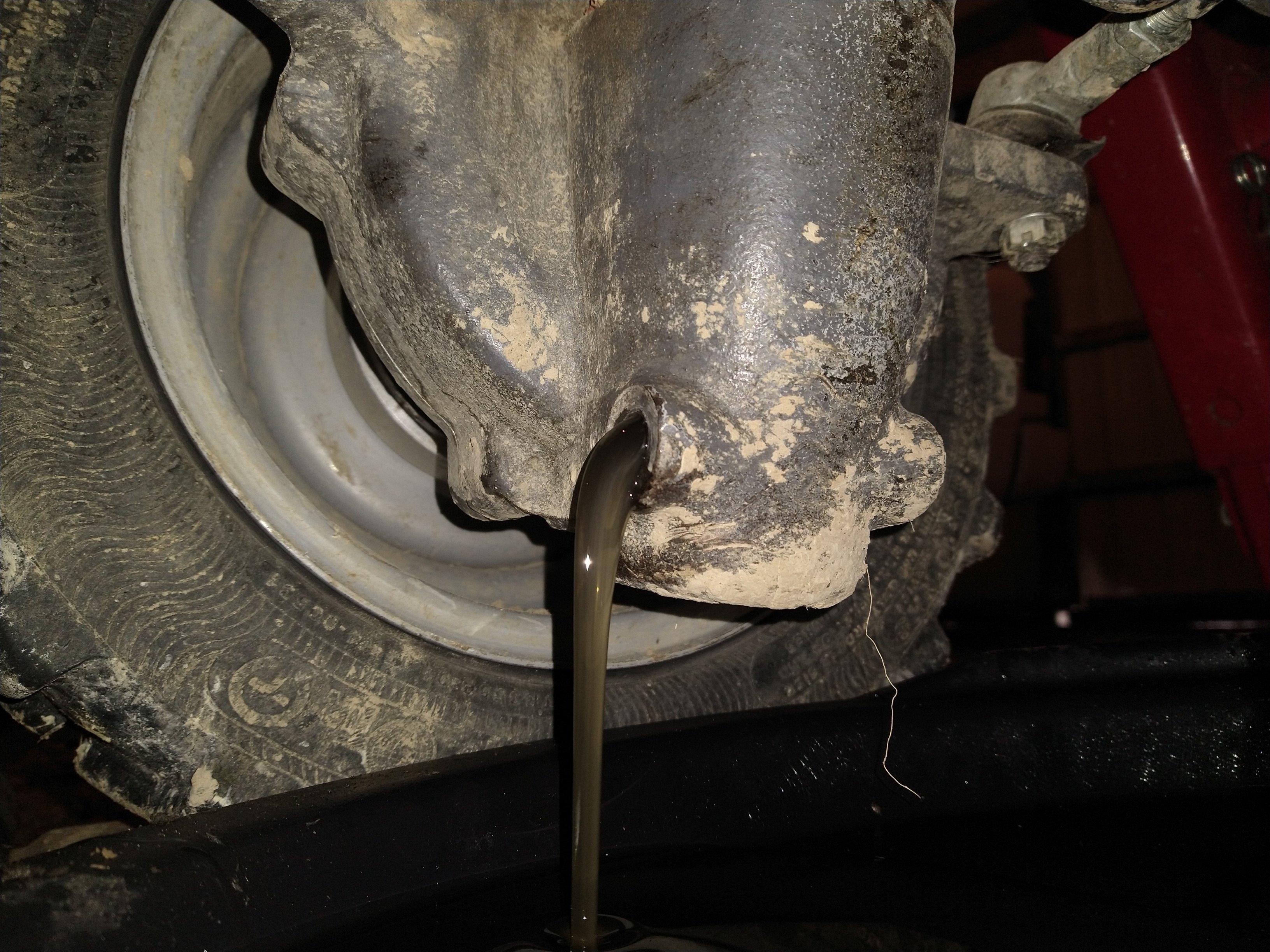

At just under the two year (bumper to bumper warranty) warranty was up, I had 385 hours on it … definitely “hard” hours … I took it in to the dealership for some recently acquired front axle leaks, both sides were leaking and so was the middle pivot! They fixed it all at no charge, but didn't ask me anything about it, or tell me to put more weight on the back …

Here's a few questions that may not have a real answer, but makes me wonder, did overloading the front axle cause my fluid to get “dirtier”? … the owners manual says to change the front axle fluid (hydraulic fluid) “every 2 years, or 500 hours” … I drained it at only 1 year and 244 hours, it looked like this!
I showed my dealer that picture, he said it looked “normal” !!!
Since my 8 ply tires don't squat like the old ones do, did that help wear out the seals, as there was no give in the tires? I've since reduced the front tires PSI to 20, and they still don't squat under a full load. (But I have more weight on the back now too!)

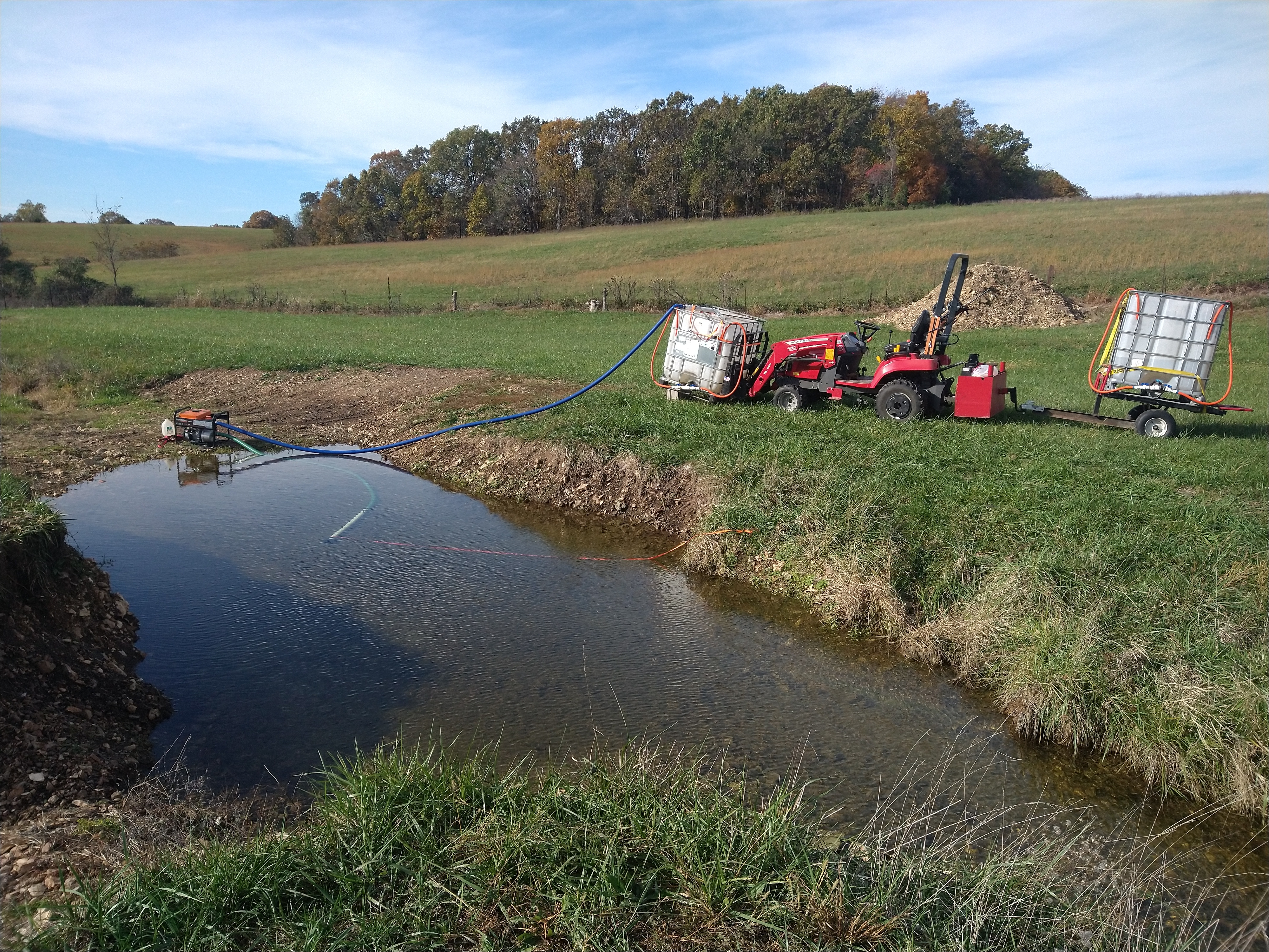

Here is a good example of "not enough ballast"!
It's the opposite of what most people with a loader experience, as I was short on FRONT ballast! Each front tire has 75 Lbs of liquid in them, since this I added another 25 Lbs to each tire ...
You can see I also made a provision to be able to add my steel weight lifting plates to it, but wanted to see how it would work without ... I'm in The "Show - Me" State!
It has a quick hitch on the back which weighs 72.4 Lbs, then a set 3pt forks which weigh 487.4 Lbs, and a 134 Lb 275 gallon tote, full of water which is another 2200 Lbs ... So 2893.8 Lbs!
The tractor is rated for 3860 Lbs lift "at the pins" on the three point, and 2980 Lbs "24 behind" the pins" ... Notice the square at the purple arrow, that is the "pin" that hooks the quick hitch to the lower arm, and about a foot forward of where the water starts! So this is pretty much a "full load"!
So I went up to the barn and loaded up the weight plates ... Still not enough with 275 Lbs on the front!
While I was draining some water out ... I decided to "experiment" I climbed onto the front brush guard, and my 195 Lbs brought the front tires back to the ground, I got off and continued to drain until the front tires were on the ground ...
I then tilted the tank forward to bring more water, closer to the pins, and was just barely able to steer!
But ... I had to cross the creek, and as I was pulling up the other side, the tote was leveling out, water had shifted farther back, and I did a wheelie!
So I stopped, and drained out more water ... Until the front tires were back on the ground!
Here is a short 24 second video of it "coming back to earth"!
Not enough Ballast!
After draining it down, it finally was able to handle 175 gallons ... I added another 25 Lbs to each front tire since, and will be shopping for another 200 Lbs of steel weight lifting plates ... And probably try only 250 gallons of water ...
