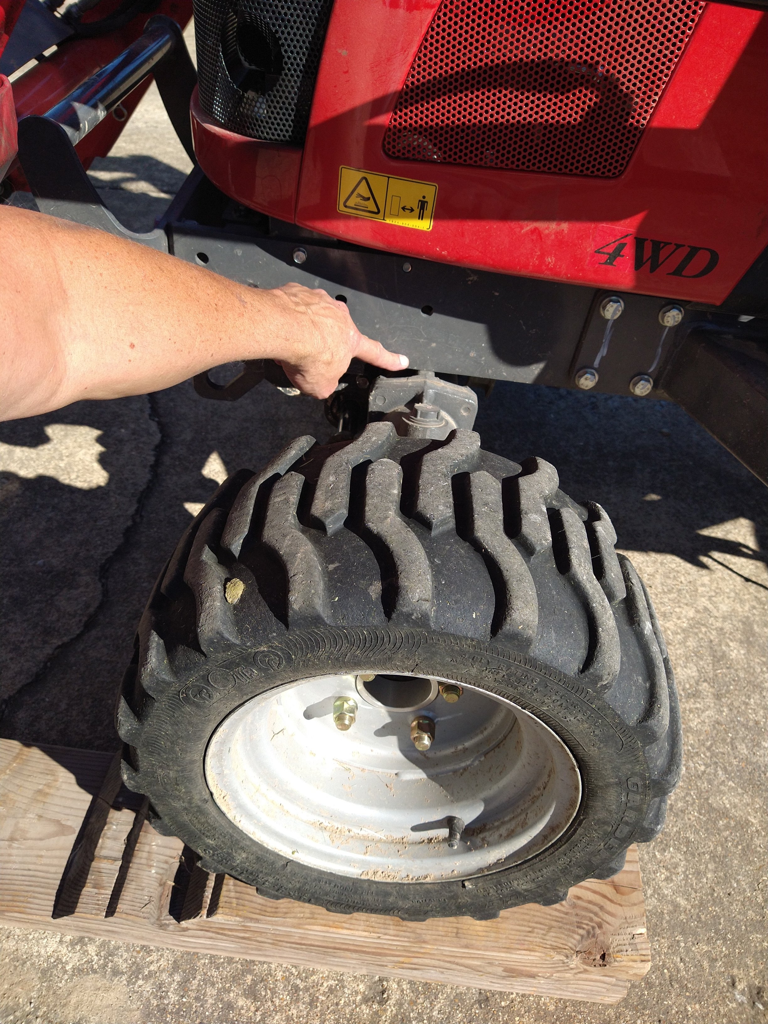

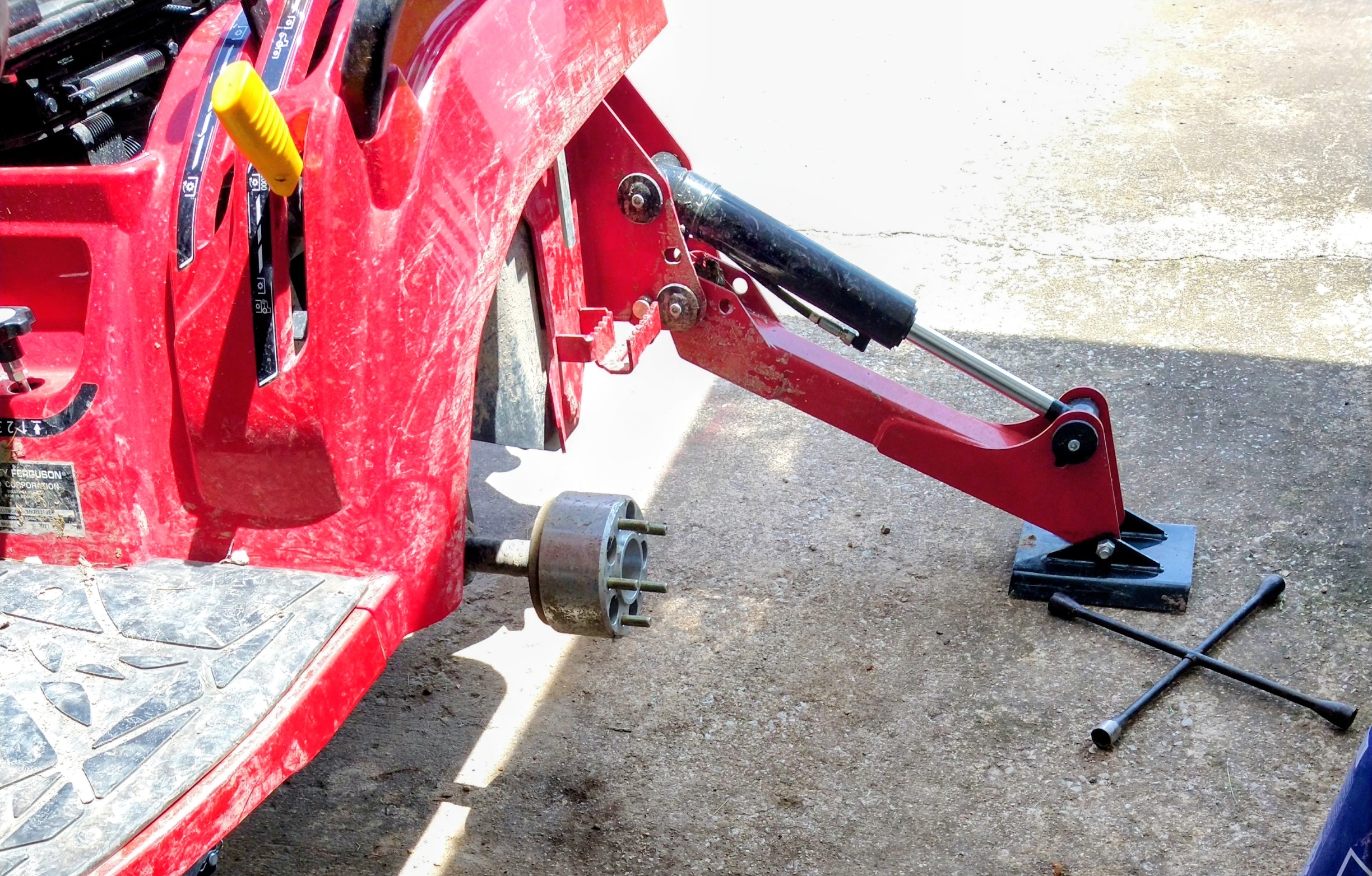

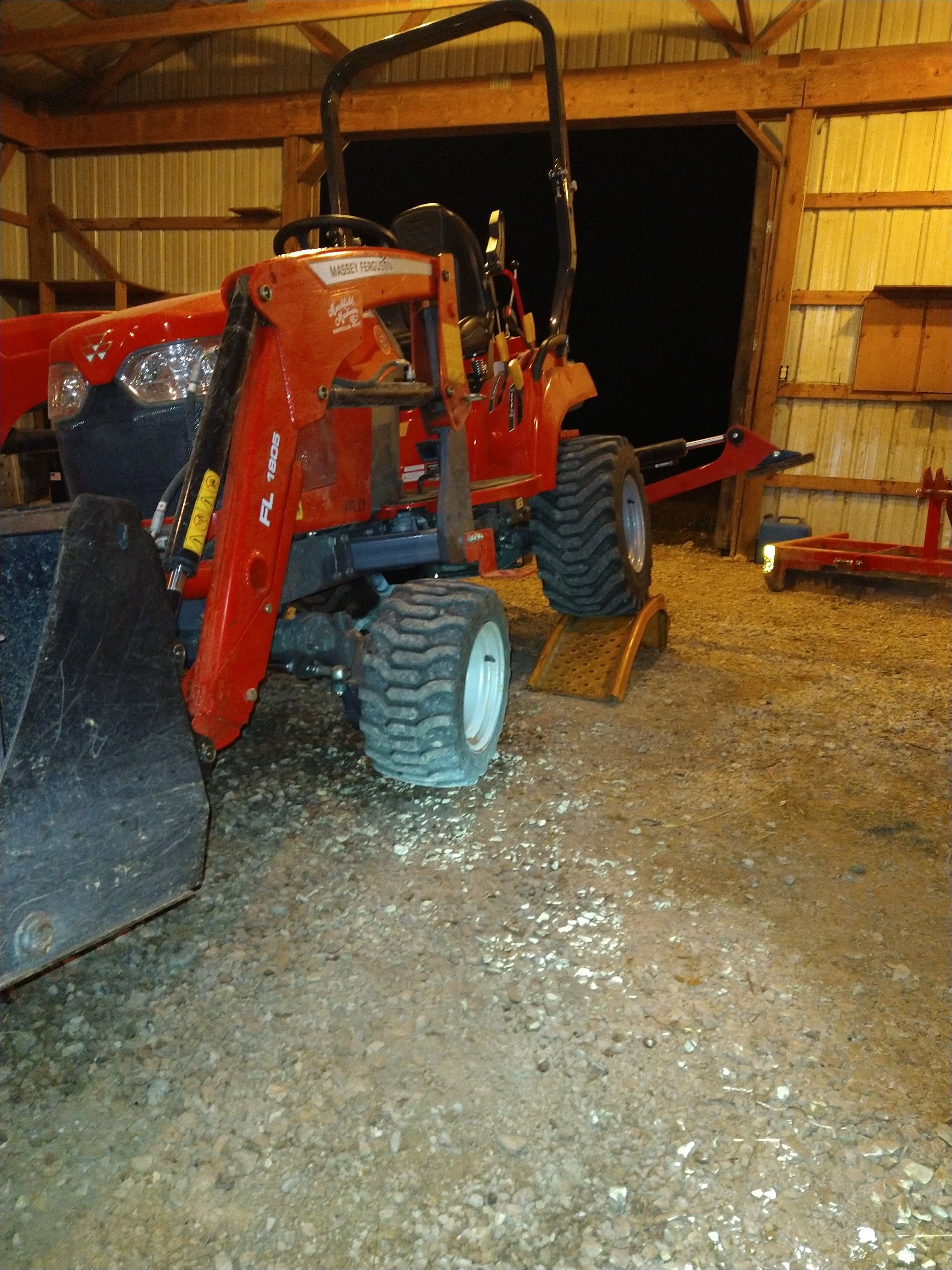

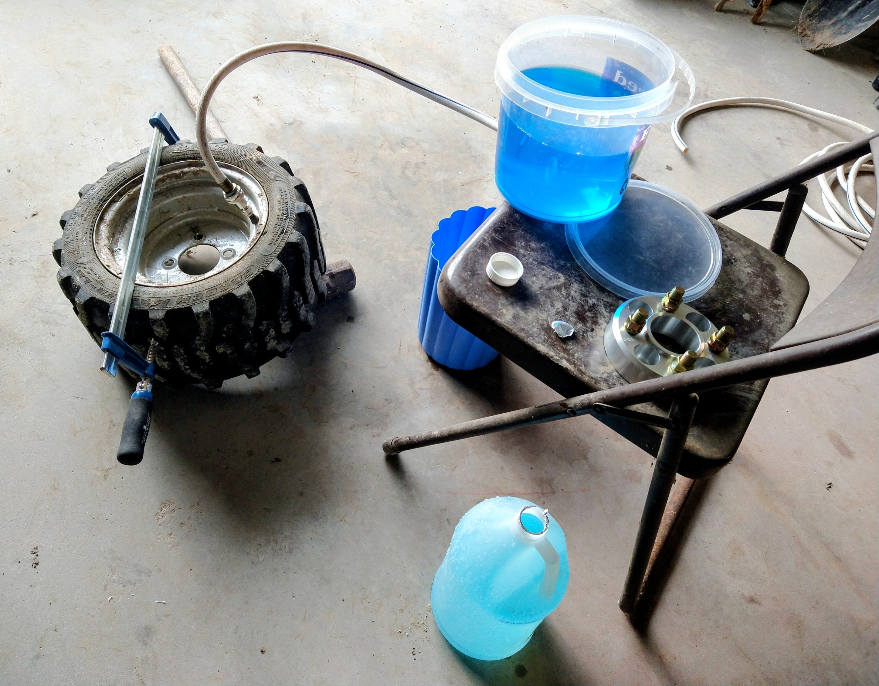

I added 1.3" wheel spacers to the front of my SCUT Massey Ferguson GC 1725 MB, and 3" spacers to the rear axle, also filled all tires to 75% full with windshield washer fluid ... For additional traction and lowering the center of gravity.

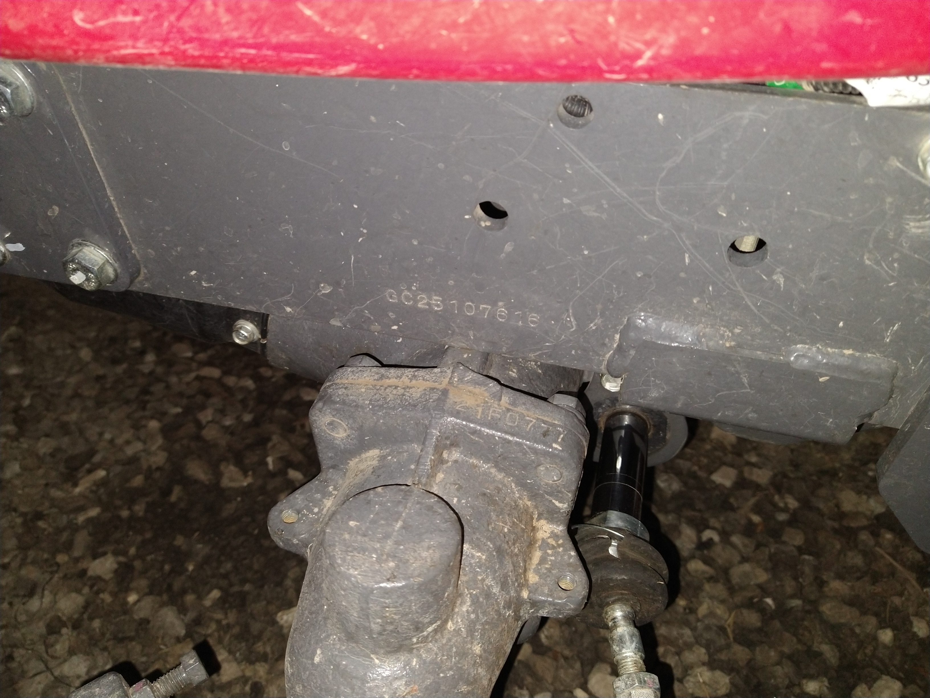

The FACT of the matter, is the pivoting front axle can only pivot so far, once it reaches that point, common sense just says it starts to provide additional support. (Some people say you're already going to be tipping over by that point, I didn't find that to be true on my tractor!)
Here is what I did, to prove to myself, with my own tractor ... You don't need to believe me, just try it for yourself!

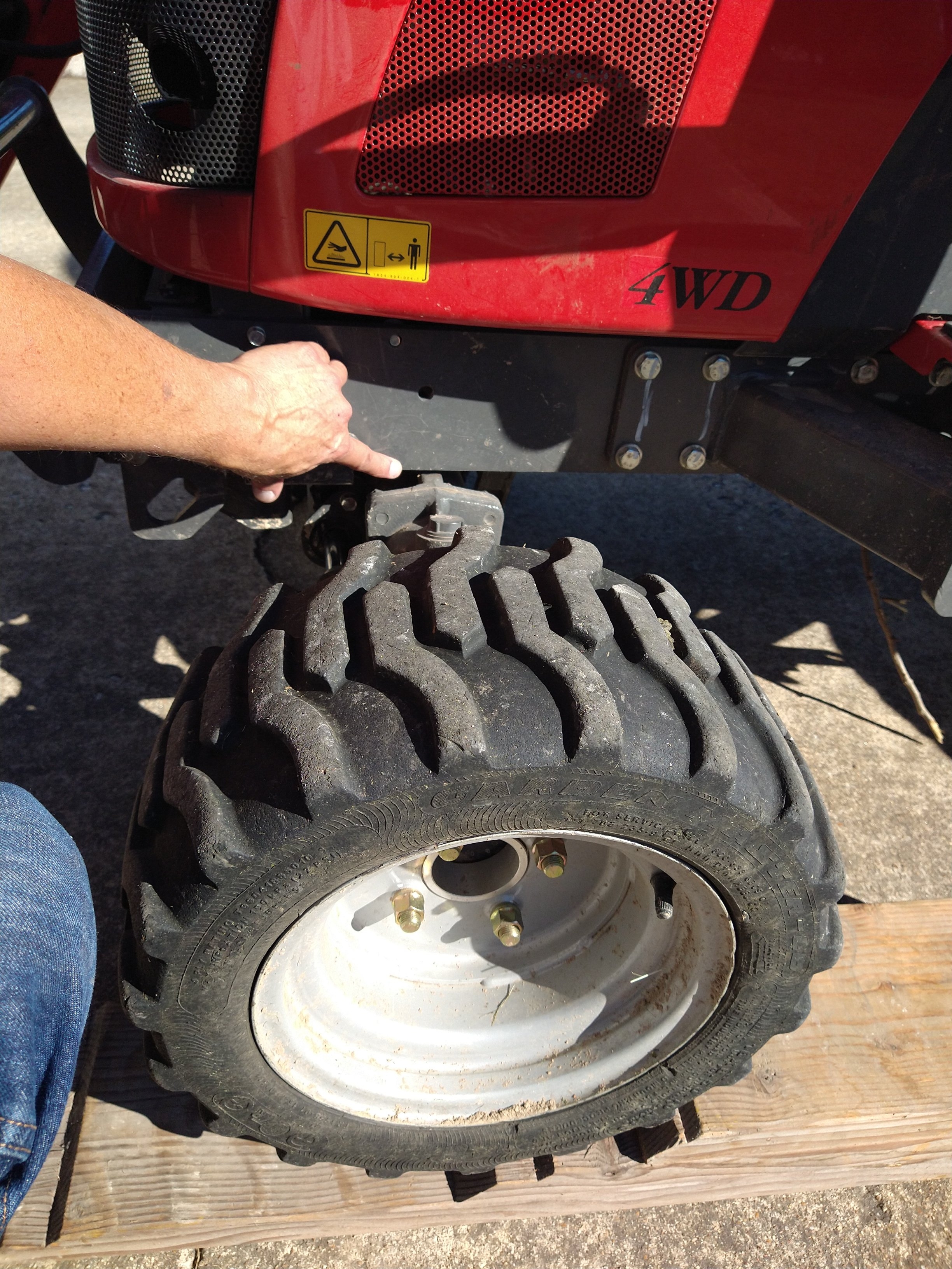

I had built some small ramps out of 2X12's which are 1.5" thick ... I drove the front tire up onto the second one, so three inches difference from the concrete pad I was parked on ... Still had a small 1/4" gap until the axle stop hits the frame ... No extra support.
Here I drove it up onto the third board, 4.5" of height, on a concrete pad, and look! Tractor is still upright, and frame and axle stop are making contact!
Someone more knowledgeable and experienced than me, on another forum said "you didn't do it right, you need to do the back axle" ... So I did! 😂

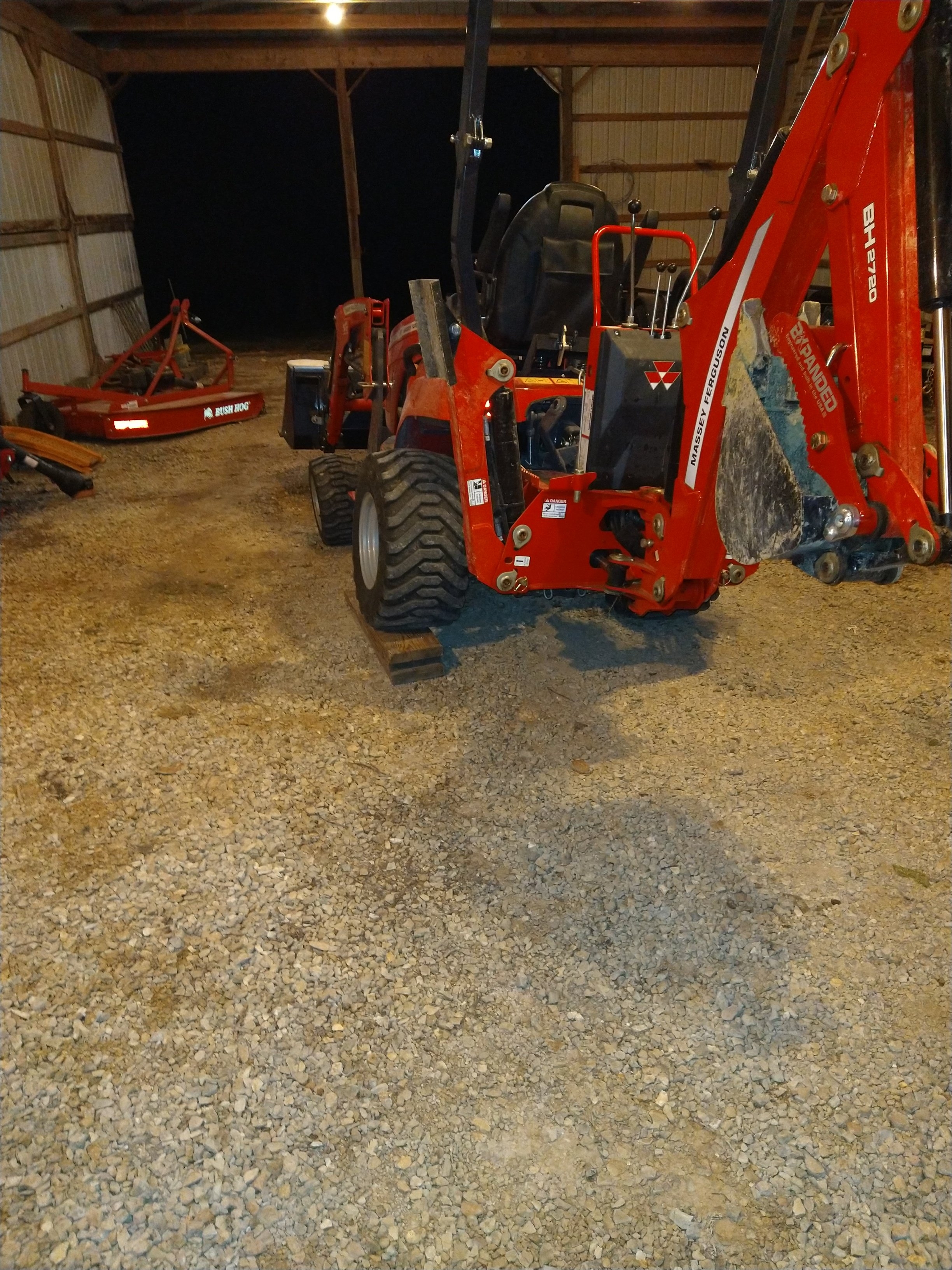

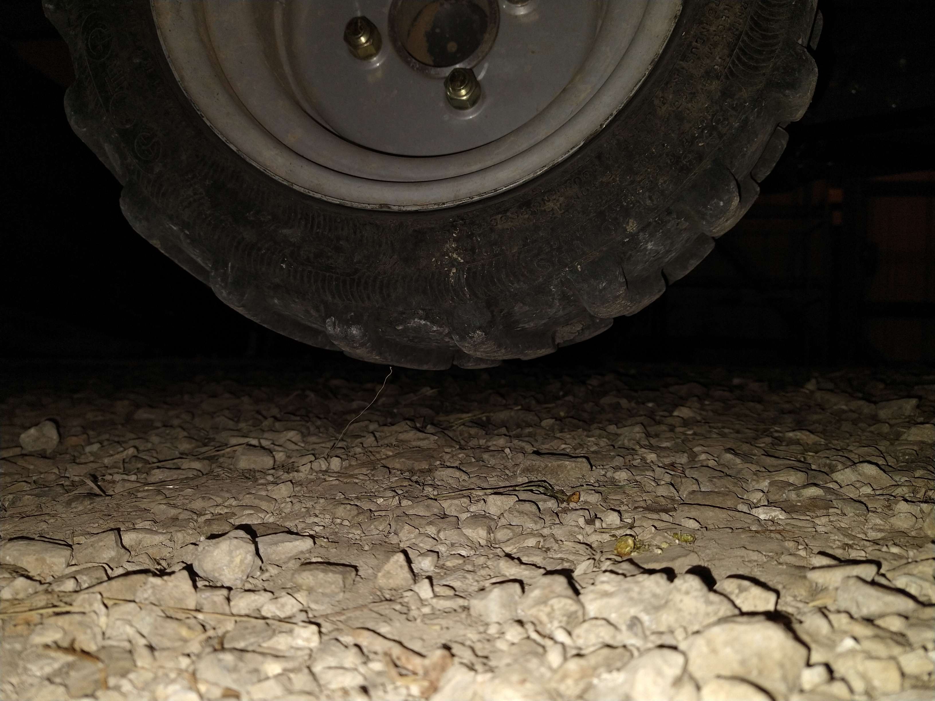

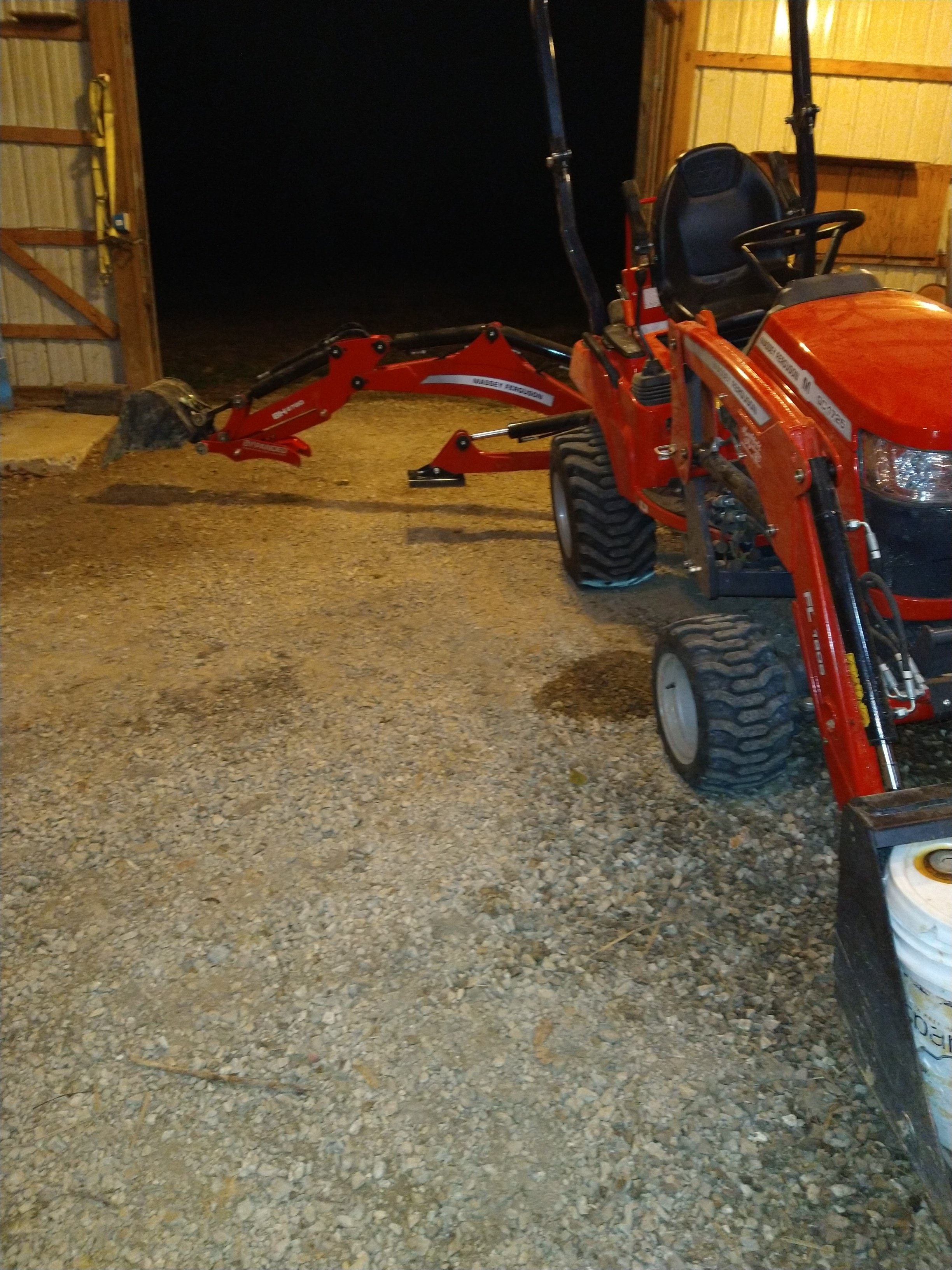

I had my backhoe (BH) on, and set it up to "catch me" if it should "tip too far"! I backed it up onto a 8" ramp! Notice the front tire is off the ground by over 2", and it's not tipped over either!
Look at the other side ... With that additional weight if the BH hanging off like that, it still didn't tip over! :rolleyes:
Look at the axle, it's bottomed out! Firmly planted on the frame rail!
I was told by the same person AGAIN, "that I didn't do it right"! As I should have used the same wooden 4.5" ramp ... So I did! 😂
Front tire didn't lift off the ground, but axle was touching the frame on the other side ... Sorry I seemed to have lost that picture ...

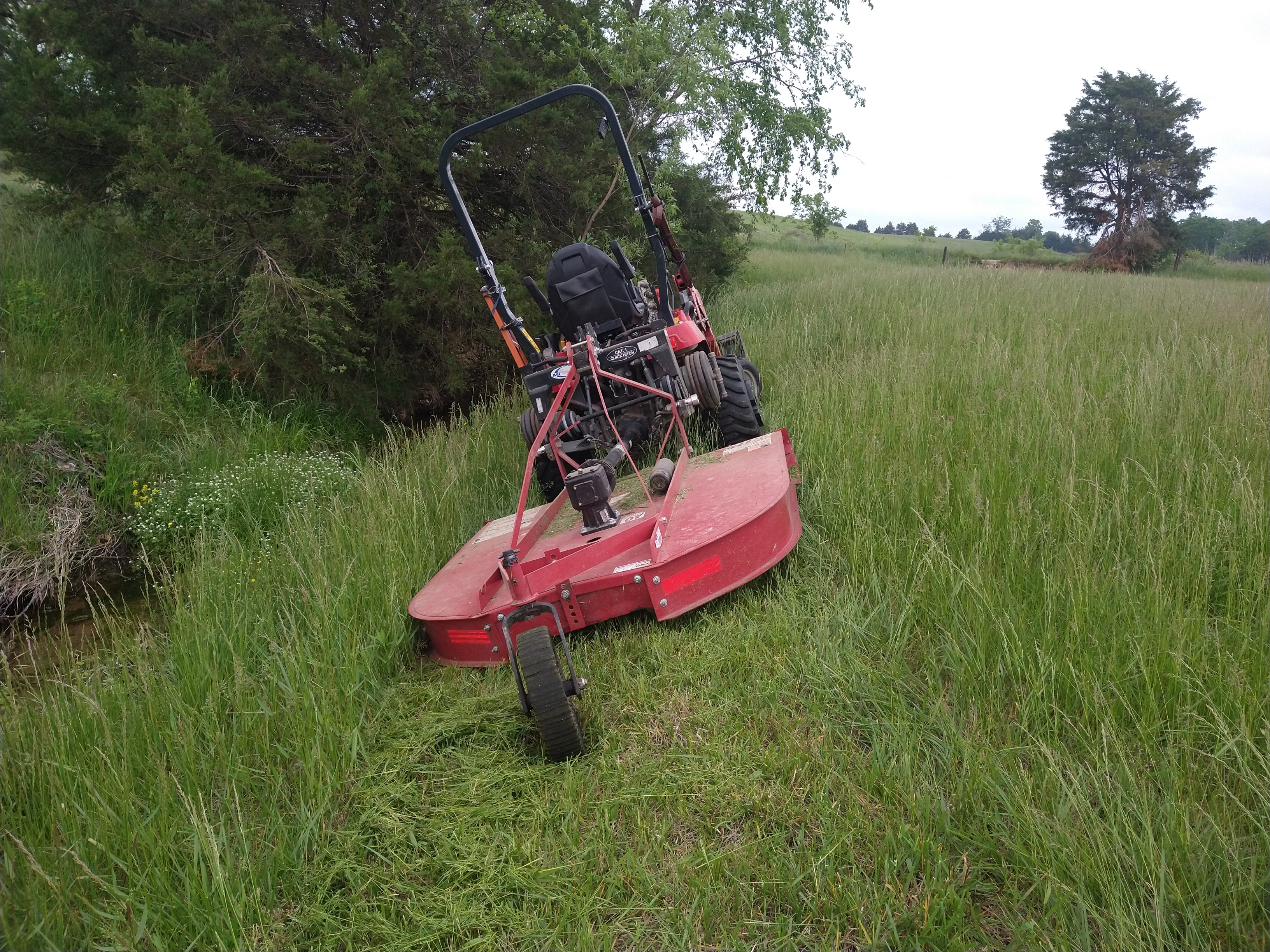

Now, like I said at the beginning of this post ... It will ONLY provide extra side stability under certain conditions!

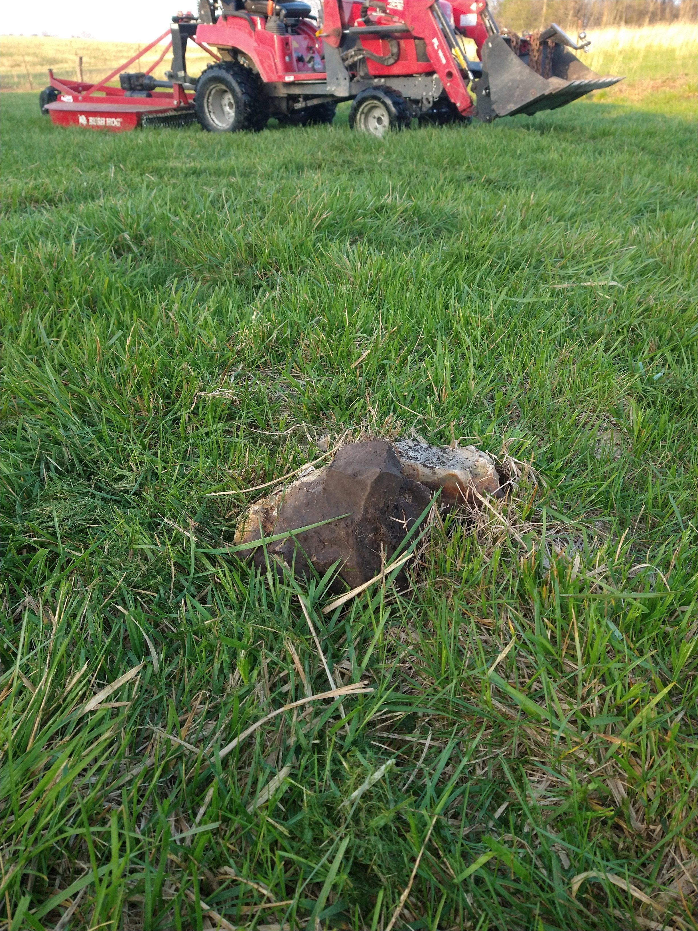

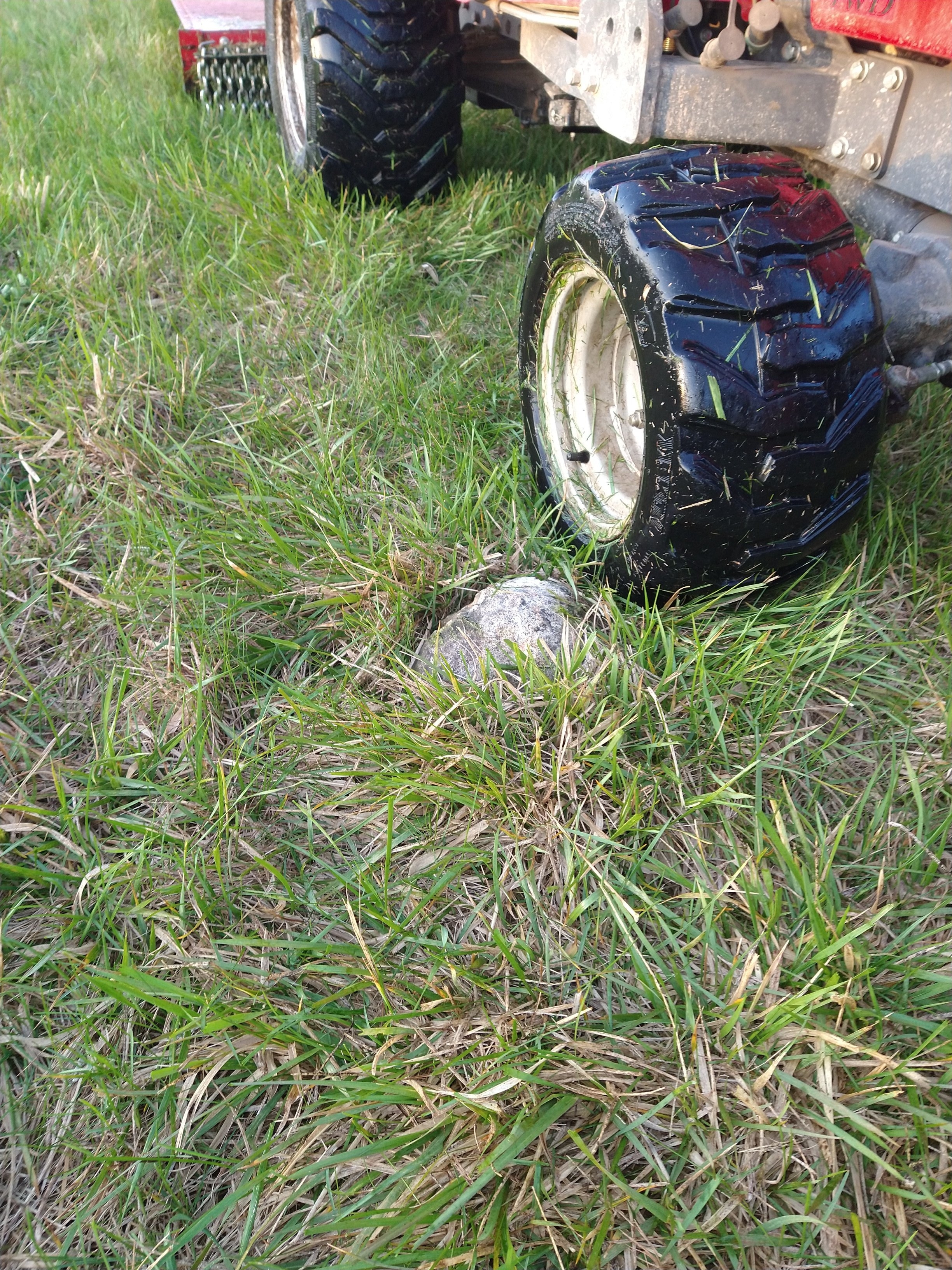

Here is when it will not help you! If your just going across a steep side hill, but ground is relatively smooth, no bumps or dips. (In my case a rock, root or dip of 4.5" will start to get extra stability benefit from front spacers) But like this smooth but side angle, will not gain any side stability with front spacers, rear spacers ... DEFINITELY!
I have quite a few rocks in places that jut up out of the ground, and my land isn't all flat ... So I have spacers on!
I currently have over 750 hours on these wheel spacers, no problems with bearings, nor have I ever tipped over, yet! :cool:
Once I retire in 23 months I plan to further experiment with actually seeing where it tips over (without me on it!) without any spacers, then only rear, then only front, than both front and rear spacers ... But, at this time as an over the road truck driver, gone most the time, I simply do not have the time to do this! You're more than welcome to in the mean time, let us all know what you find out! :)

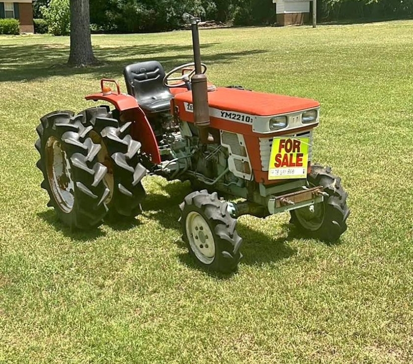

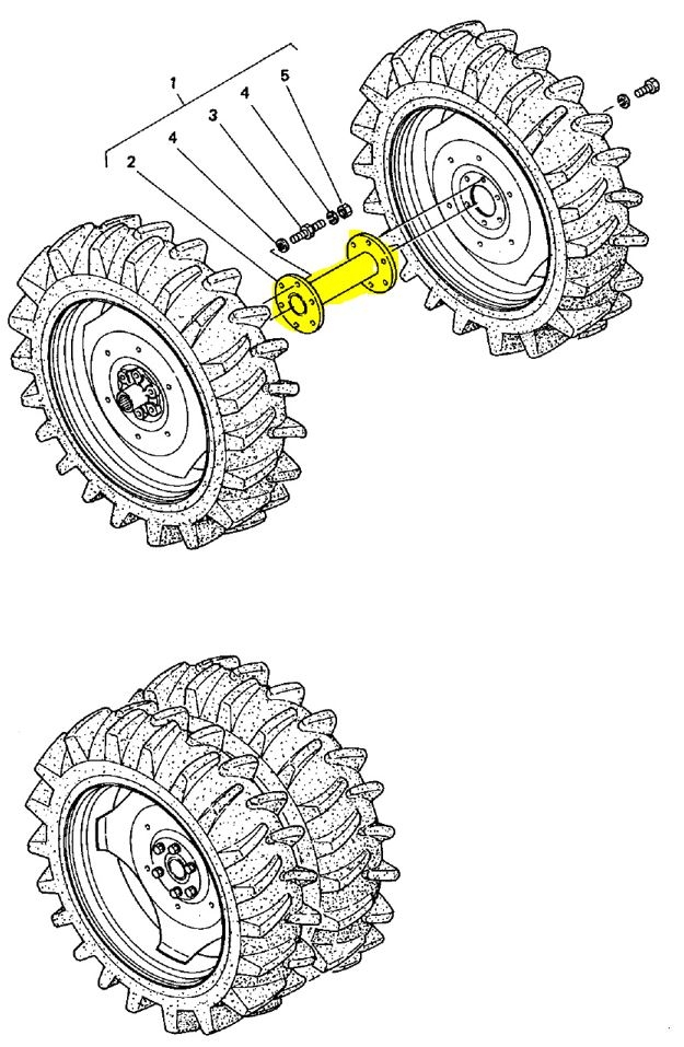

Depending on the tractor and the brand of manufacture, wheel spacer use would be defined in the OPS manuals.
Both Deere and Yanmar for their common machines provide size and material info for wheel spacers to use.
For CUT, Yanmar mentions not to exceed 100mm or 4-inches.
If you were to mow steep ditches or inclines, a dual wheel setup would be ideal.
