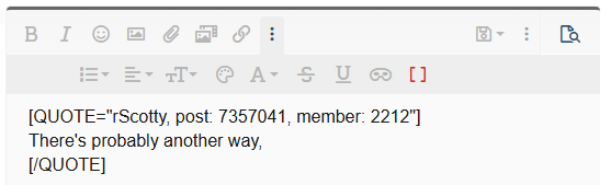

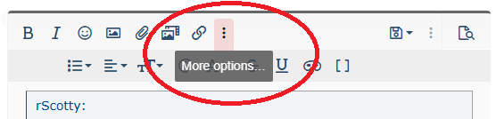

/ Wheel Spacers #14
There's probably another way,
Many different ways, but here's one of the simpler solutions:
Hovever your mouse over the three little dots in the top middle area of the response window:
Under "More options", you'll find a pair of square brackets "[]", with the tool tip "Toggle BB code":
Click that, and your window will change from rich text to raw Bulletin Board-style text:
You can see that anything listed between the "QUOTE" header and "/QUOTE" footer ends up inside the quote box, with that little bit of gobblety-gook "rScotty, post: 7357041, member: 2212" just creating a label at the top fo the quote window.
Now you can just be sure that what you're typing ends up below the /QUOTE footer.
