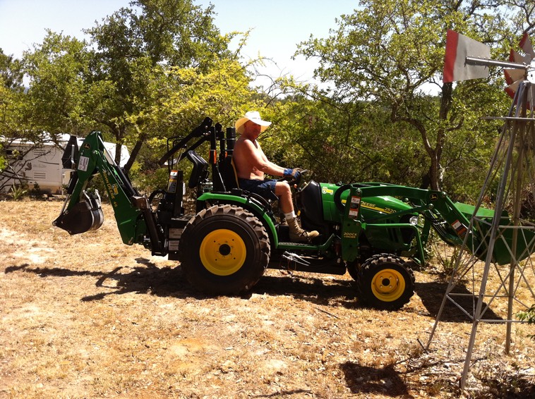

Steep, rough, off camber I got it in spades down here in the Texas Hill Country. I bought a JD 2520 abd while its a compact tractor its still a tractor with its HIGH center of gravity and I have 1 & 2 wheels off the ground so many times I cannot count, albeit I have never laid it over, but certainly been close. The tools I use most are my FEL, Backhoe and sub soiler which I use to clean out ditches and create ditches andtrailer hitch. Yesterday I pulled 3 different size trailers from 6 ft to 18 ft.
Ideally the setup would be a lower center of gravity, wide track front and rear and enough weight and HP to get the job done. I am not a farmer, have no row crops, I just work the land by clean, clearing, managing water runoff, moving rocks and tree debris. Hill Country has GOT rocks. On my place I have generally about 6 in of top soil and below that it's limestone and its limestone down a long long ways. My well is 728 ft and I know folks that get water below a 1000 ft. The ONLY flat ground on my place is where I have made it flat, otherwise none!
I have been looking at the JD 1 series, but my dealer does not take trade in's so I have not tested one out yet, but I am maybe at the stage that a 1series will do for me all that I need. I have been trying to get my land where I can mow it and I have been at it going on 7 years and now quite there yet. I want to be able to mow with a garden tractor set up and liking the Husqvarna TS348XD. for its maneuverability due to the many trees I have and I have been cutting down trees for 7 years, cut down 15 in the past 3 weeks between 30-50 ft tall and I still got a lot more to go. Bought an old cattle ranch that laid fallow for about 40 years.
As another poster said 'get to know your tractor' and I will echo that. Get to know the tractor, be cautious and learn and understand its capabilities or you can find yourself in deep kimchi real quick.
Also, ask yourself, what do you NEED to do with your tractor? This will really help you decide what implements you need to accomplish those tasks.
