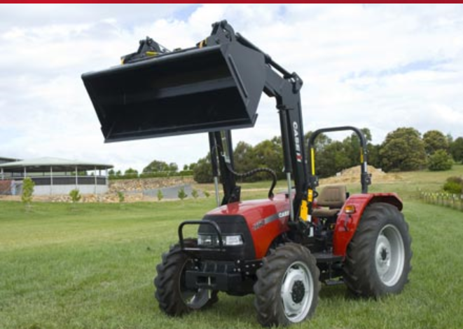

Thanks everyone for the helpful comments. We're getting close to a decision. So, because of our terrain, we're looking for a smaller tractor (22-24 HP) to get through tight spaces, but with enough weight and wide enough wheelbase to handle the grades, and enough power to handle our heavy clay/rock soil. FEL & BH. HST because accidentally jerking the tractor is gonna hit a tree or put a wheel somewhere I don't want it to go. 4WD of course. Cat 1 hitch. Used is not an option.
Tractors I have looked at so far:
1. Yanmar. Much cheaper than the competition but also lighter weight, less power, and no Cat 1 hitch. Not impressed.
2. Nortrac. Much cheaper than the competition and specs are good; heavy tractor w/ good power. However, no HST available, plus some concerns about maintenance/reliability.
3. Mahindra. Heavier and more powerful than the others; also lower and wider. The only 22HP tractor we saw that could lift itself off the ground w/ the FEL at idle speed.
4. Kubota, New Holland. These are relatively high, narrow tractors (not good for the hills), plus less power/weight than the Mahindra. I'm also hearing some RECENT issues w/ build quality & reliability.
5. PowerTrac. Small, low and powerful for its size. However, the bigger ones cost as much as a SCUT and are cash only. Extreme lack of ground clearance may be a problem too.
6. Simplicity Legacy. A kind of lawn mower on steroids. Has a lot of nice features and mows like a dream. But mowing isn't a priority for us; we live in the mountains and don't care about stripes, and when you add the FEL and BH it costs more than a SCUT w/ less power. Makes no sense.
7. John Deere. Saw these a couple days ago. I don't understand these new JDs. Extremely high tractor, no Cat 1 hitch, less powerful than the competition. Huge bolted metal plates everywhere, which make it look way beefier than the competition, yet it's a lighter tractor. How is that possible? True, there's a lot of flimsy plastic I could easily flex with my hand, and someone told me a lot of that metal is cast aluminum so maybe that's it. Probably the tractor least suited to our needs.
8. LS. Another high, narrow tractor. Good value though.
So, I guess we keep coming back to the Mahindra Max and eMax 22-24. I've looked at spec sheets till I'm dizzy and they just seem to beat every other tractor in their class for our specific needs.
I don't want to offend anyone with these comments. I'm simply a first-time tractor buyer with no brand loyalty, and these are my first impressions of these tractors (some of which may be wrong) plus "doing the math" based on spec sheets.

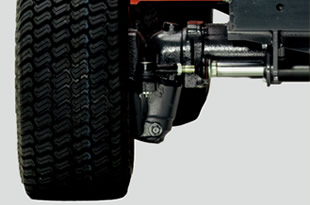

..... can anyone tell me what these rod-like things are--axle? steering control arms?--and how sturdy? Whatever they are, they're gonna be in danger of hitting rocks, stumps, dirt. This is one thing I look at on every tractor.
The shiny horizontal rod is the hydraulic steering ram (cylinder) with the steering knuckle on the end. Since they are near the center of the wheel, they are somewhat difficult to hit since the wheel will climb obstacles and tend to keep the ram/knuckle clear. But it IS possible to catch them on something like a stump or a rock that the wheel just misses. They are very solid but CAN be bent.

My advice if you are looking at a conventional tractor and have narrowed it down is to go back to the dealer and determine which is the best dealer. Tractors will be more or less the same IMO, but dealerships can make or break your deal. Tractors can and will break down. You will break the tractor, and you will need parts and service. So look at how well stocked your dealer is and how they deal with service. Call people who use the dealer (try and not get the dealers recommendations but just ask people as they show up). In the end it is the dealer that diffentiates the tractor, not the tractor itself.
Oh, and as for your note on ground clearance on the PT. You have that completely wrong. Sorry, not trying to pick a fight, the PT has a lot wrong with it, but your assumption ground clearance is an issue would be incorrect. The other thing is that the bottom of the PT is flat steel, not exposed drive train. Nothing to damage or hang up on.
