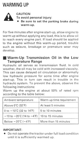

I understand many newer diesel applications have auto preheat setups. I know the 2017 diesel truck that I use at my nephews maple sugar operation seems to have such a setup. Insert key, turn, and wait for all lights to extinguish before it will start. But it will fire and run right away, with no hesitation.
So, this brings up another question, which I think I knew about, but really have not followed. Engine warm up...some of these times seem pretty excessive, but what do I know. I do know that diesel engines are pretty cold blooded. What do others do?

the warm up times in this chart are for the HST, not the engine. I don't know why it mentions the engine in the last sentence as the engine has nothing to do with it other than how long you are running it. As it says, running with cold hydraulic fluid can potentially do damage.
/ Glow Plug Use #12
I agree, that’s why I have heated silicone heat pads attached to oil pan and transmission to preheat oils prior to starting. Has really helped frigid winter operations for me.

X3 on the transmission / hydraulic oil warm up times. I don't follow the times Kubota has historically placed in their manuals though.
Below 15f usually 10m of warmup, otherwise maybe 5m. I have a 1500w infrared heater that I have put on the transmission case in the past for an hour or so, which heats up the oil very well.
