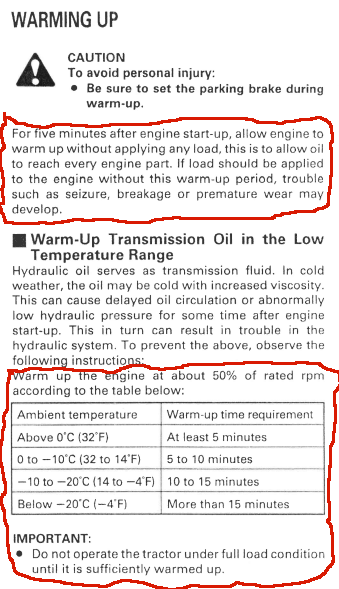

the warm up times in this chart are for the HST, not the engine. I don't know why it mentions the engine in the last sentence as the engine has nothing to do with it other than how long you are running it. As it says, running with cold hydraulic fluid can potentially do damage.
hube2: While you are correct about the HST fluid, you will also note that the first and latter part of the image specifically states "the engine"

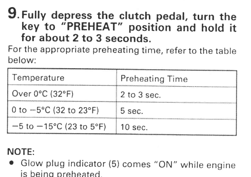

When using glow plugs to preheat for cold starts, does anyone have any better information or knowledge about what is the proper/correct amount of time to preheat before trying to start a diesel engine?
The reason I ask is this. After having had my B7300 for over 23 years, I had my first cold start issue this past week. In the past, it seems, I really have not had the need to start my engine in really cold weather. However recently, we had a couple small snow storms, nothing enough to warrant clearing the yard and drive, but freezing rain was in the forecast, and following that a much colder freeze. I decided to clear up what was down and around before the rain and freezing rain made a mess, and the forecast deeper freeze turning everything into a rutted skating rink.
As it was about 15F at that time, I put everything in neutral, depressed the clutch, moved the key to preheat, and held it there for 10 seconds, basically what the manual said, and has worked in the past, but I cannot attest to what the temps were when I did those cold starts. However, this time, the engine did not fire on the first try. So, I waited about 1 minute, and repeated the process, and once again, it did not start. So, I repeated it for a third time, and the engine started. I did my clean up and put the tractor away, but I got to thinking about this, as winter here is basically just getting started. I reread my user manual, and confirmed what I had done was what was prescribed.
The next day it was much colder, 7F, and I decided to do a test. I went out and began the cold start procedure, but this time I held the key in the preheat position for 20 seconds, and it started right up. I am now wondering if the user manual is being a bit cautious with the preheat time? Or if maybe there is a more widely used or accepted thought/theory/procedure ?

If your manual says to cycle the glow plugs for only 10 seconds I would be very hesitant to cycle them for 20 seconds. My concern is if you leave them on for too long you could burn them out. In cold weather I cycle my NH glow plugs for 5 seconds or so, wait a couple of seconds and repeat. I also give it a little throttle when starting. If it chugs and smokes when it starts I give it another shot of glow plugs and it smooths out in a couple of seconds. Two or three 10 second shots is kinder to your glow plugs than a single 20 or 30 second shot.
You might have a bad glow plug as well. Check continuity to ground of your glow plugs. If you have continuity to ground they are probably good. If you don't have continuity to ground they are bad and should be replaced.
