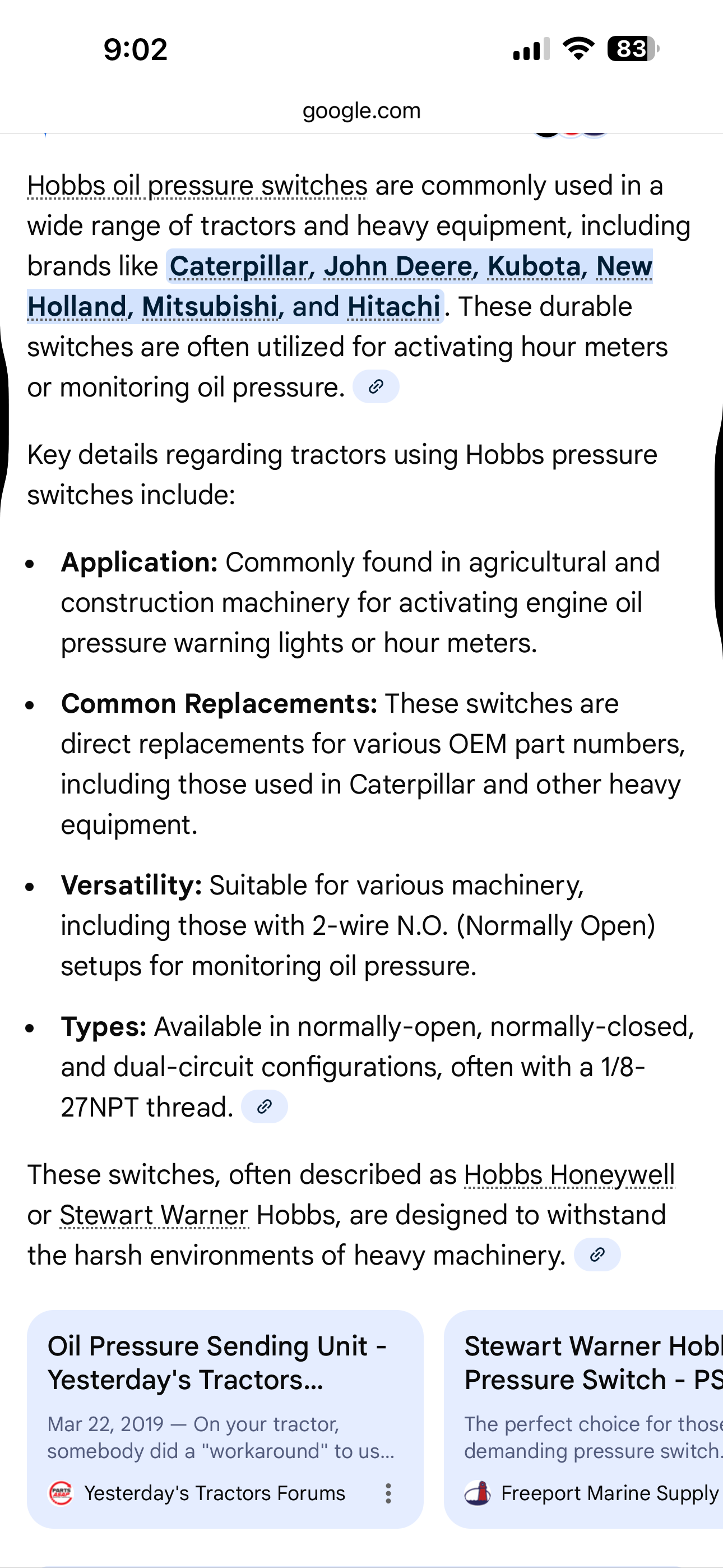

Hobbs hours are actual hours the meters are activated typically by oil pressure. Mechanical tachometer hours are average hours based on revolutions. Usually about 60% of actual.
Perhaps, and I do not work on aircraft, but I've never come across a Hobbs meter connected to oil pressure. As I understand it, oil pressure connections are an aviation use case, but again, not an expert here.
All the best, Peter
I agree with part of your statement.

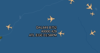

Today's screenshots are from FlightAware: One showing an aircraft ICAO type B752 (Boeing 757-200) at 40000ft (FL40) from Atlanta to Eagle County in CO and the other showing ICAO type E55P (Embraer EMB-505 Phenom 300) at 41000ft (FL41) from Salina Regional in KS to Raleigh Durham in NC.
[For those unaware, the first line is the aircraft call sign and type, the second line is the current altitude (or FL flight level) and current speed, third line is the departure and destination IATA airport codes and ETA.]

Go back and look you said 3.C under dry conditions.
FL 40 non existent, but you said 40MASL. That acronym is meters above sea level. Once you get above 18,000’ (FL180)it changes to flight levels which eliminates variations in altimeter settings, they all use 29.92 that keeps the spacing equal, plus those are all IFR flights. Altitude and flight levels are two different things. Altitude is expressed with either MSL or AGL. So to clarify 35000’ is a flight level and is expressed as FL three five zero, not 35.
