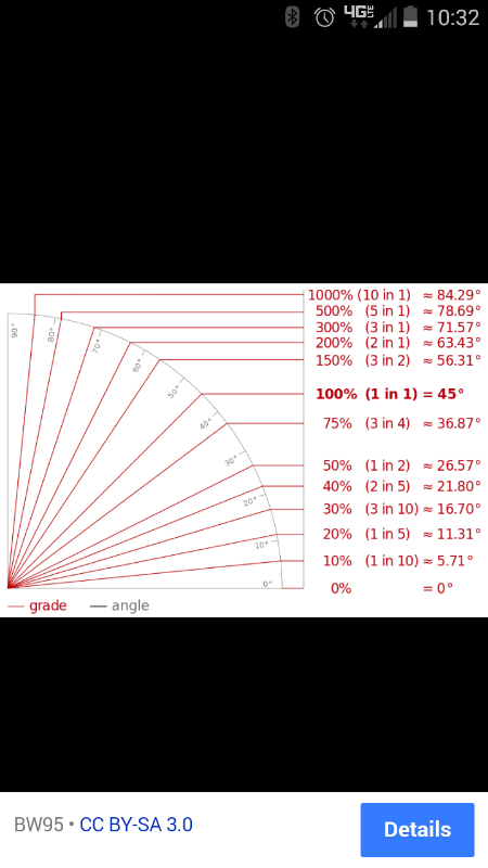

Here's a chart showing grades in red and their corresponding angles. I'm not talking a really big tractor, my friend has a 30 HP new Holland which isn't very big and he's got the rear tires quite wide on it. It would be very stable. Loading the tires makes it even better. The bigger tractors are likely more stable than the scut due to the larger foot print.
I'm sure there's plenty of people using tractors in your conditions, I would recommend sizing the tractor to the work you have and the implements you'd like to use rather than worrying about the grade, you have to operate a tractor safely on a grade no matter it's size, there isn't one that will do what an excavator will, just use basic common sense
/ Using a Tractor on Mountain Property #24
-not sure I understand how that percent grade thing is calculated.
If a slope rises 10 feet for each 100 feet horizontal it is a ten percent grade. You can easily mow a grade that rises 25 feet in a hundred or a 25% grade. It takes a very well set up tractor to mow the side slopes of a highway embankment which is a 50% grade. Most prudent people stay off anything that is 33% or more especially if it is uneven and might have an unseen chuck hole that would suddenly put you over the tipping point.
Thank you for the chart. I'm saving it.
Er, looks like I definitely understated the grades..... seems like I've been driving the Huskvee on a 40-50% grade. No wonder it keeps getting stuck.

The nice chart presented above is one of several on that same web page. Note the bottom line denotes grade and degrees, but the third column is not noted, it should be noted as SLOPE. A twenty grade is common in Kansas, but a 20 slope is way more steep. A thirty slope is easily crossed with most cuts or uts or small farm tractors, but a 30 slope is quite a different color of horse. A 30 slope is close to an angle of 57 degrees or more.
