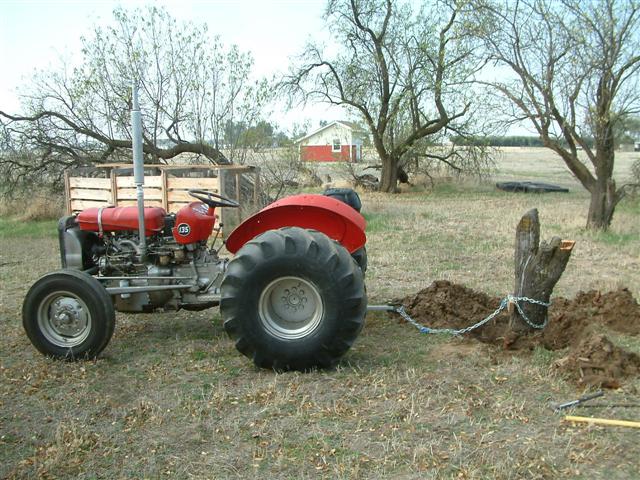

For low center of gravity, you want a straddle tractor like my 1964 MF135 diesel. Your legs straddle the transmission/drive train with your feet below the top of the transmission. The other type of tractor is the platform tractor that has the pedals above the transmission so you sit higher on the tractor making for a higher CG.
That 135 has been modified. The 28" diameter rear rims have been replaced by 16" diameter rims and the front wheel spindles have been shortened to keep the tractor level. The wide rear tires are 18-16 size.
Other older straddle tractors include the Ford 8N, Ford Jubilee, Massey Ferguson MF65, 150, 165, Ford 1000, 2000 and 3000 series.
The Case/IH JX is a modern straddle tractor.
Good luck and be careful on those slopes.
