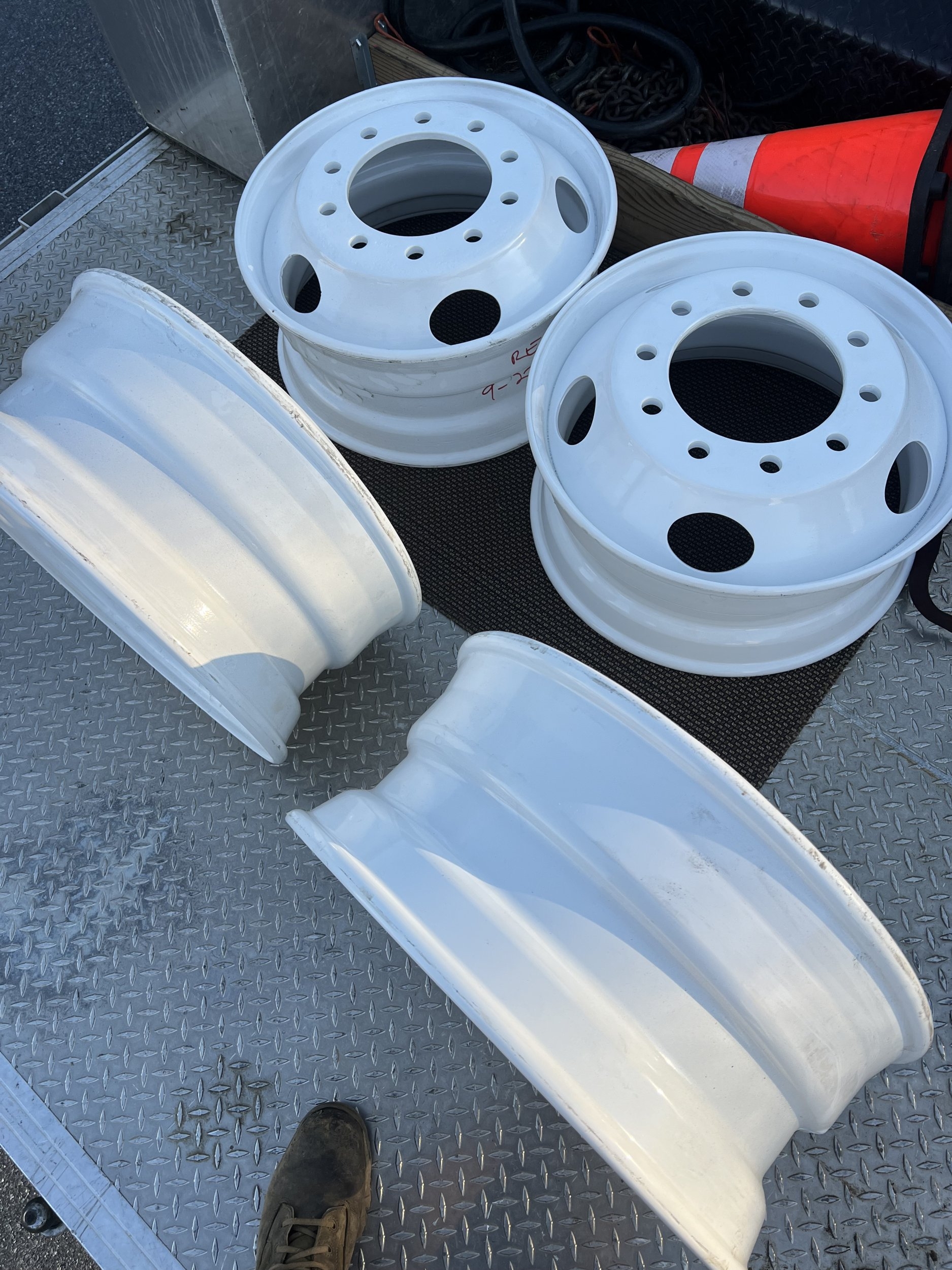

Here’s what $100 per wheel buys today.
Best price I could find new was $318 + tax.
I never knew how much heavier and heavier built a 9” wheel was compared to an 8.25” wheel. These 9” wheels will carry 10,000lbs per wheel. The 8.25” are rated at 7300lbs, which is technically, too light for my 30,000lb rear axle.
9” is always better than 8.25” (I know, that’s what she said)
Anyways, learning a lot as I go about wheels.
Next, need to find 12.25” front flotation rims with same 5 vent design.
