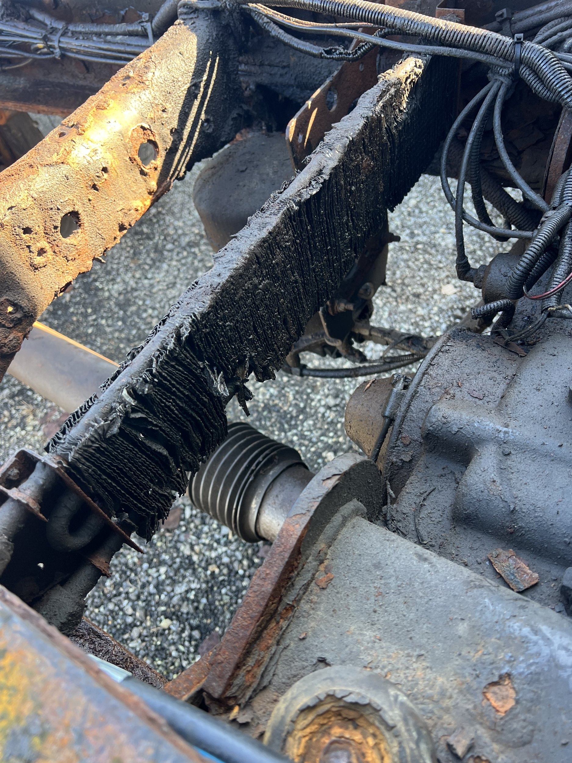

So yesterday, we finished the AC. Needed a compressor ($340) and a line ($100). Of course, got 3 of 4 bolts out and the last one was rusted and broke off. Drilled it out, but it took another hour.
The transmission cooler is toast ($495). New one will be here Monday. I can’t imagine why someone would let something get ruined like that and not replace it. Owner of the shop that’s doing some of this work says a transmission cooler isn’t really necessary for short hauls and no mountains around here, but I want to try to do this right with each step.

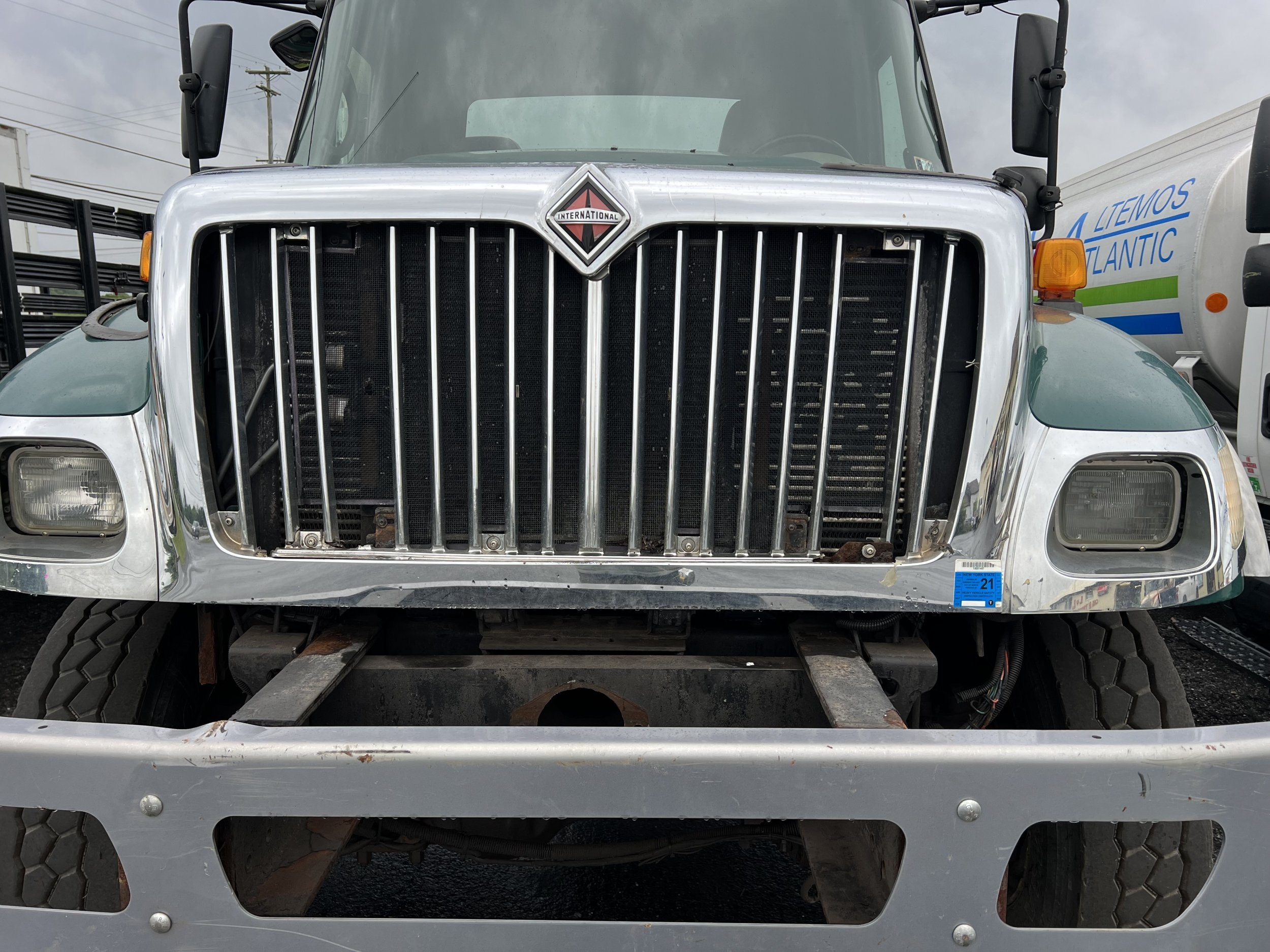

My grille looks pretty bad with the broken fins….guess how much new from IH?

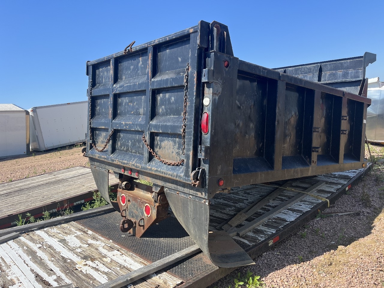

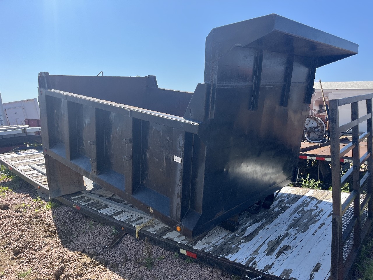

Anyway, here’s the bed. It’s ready to ship. Just trying to make final arrangements for transportation. I think it looks pretty good for $3,500 (+ tax) lol.
Looks like they are including the pintle plate, pintle hitch and mud flaps.

I would definitely keep the transmission cooler as you are likely to do a fairly high amount of low speed high load off road work in soft ground that will drive up transmission temperatures.
   / New (used) IH 7500 Dump Truck purchase, modification & fix up
#275
Yep, I was thinking same way. Reversing with a load get’s em hot, too. Never really a doubt in my mind, but the price of the thing was just crazy.

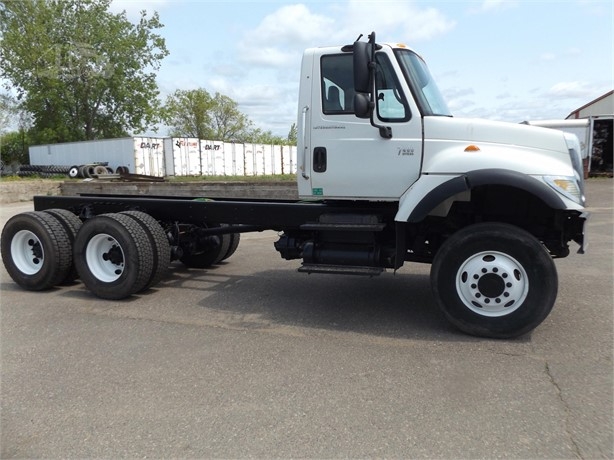

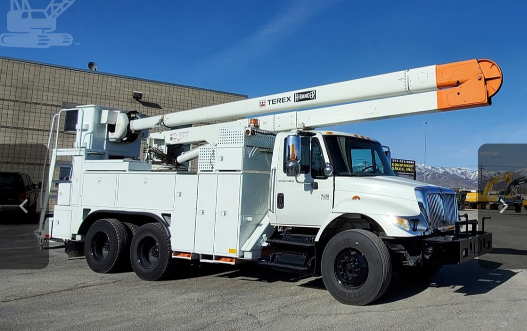

I am still looking for this exact truck
Possibly 6x6? 2003 4700 with a 530 motor, in SLC and has a bucket on it though:
A place in FL has 3 4700s with water tanks, but they have 466 motors, not 530s: https://www.machinerytrader.com/lis...nufacturer=INTERNATIONAL&Year=*2006&Drive=6x6
Aaron Z
#279
Aaron,
Hey thanks for those links. The pictured truck is a 6x4. I missed out on the one I showed a few posts ago. The pre emmissions 6x6’s with automatics and larger displacement DT/HT motors are a needle in a haystack.
The tell tale for the front driving axle/6x6 option is the big transfer case hanging behind the cab.
Seems like I’ll look for a few weeks, see nothing, then the week I get so busy I can’t look, one comes up for sale and is snatched immediately. lol

I booked the shipper for the dump body through UShip.
Should be here next week or the following week.
We are getting closer to a complete 4x4 12’ dump truck!
