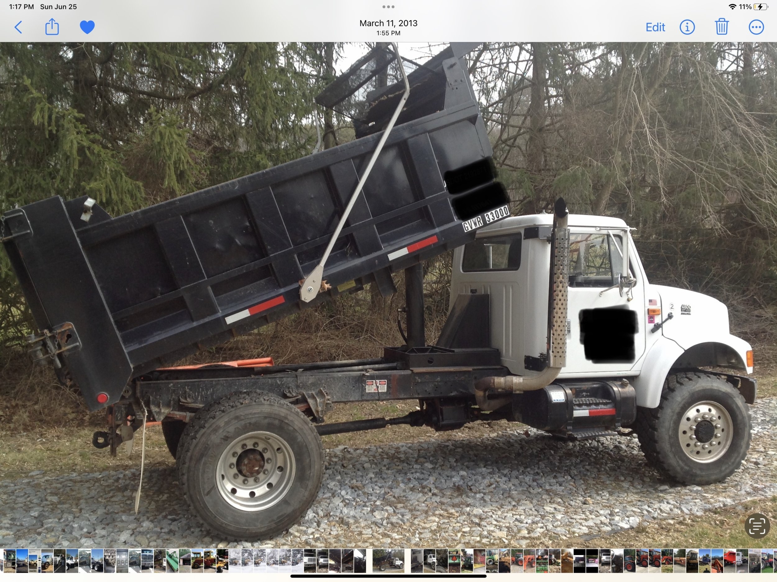

Here’s my old IH-4800 4x4 from 2013.
This one was 33,000GVWR. DT466@250HP, 7 speed manual. It also had a 12’ dump box.
I sold this truck to buy more farming equipment, but always regretted it.
Hopefully the one I’m building now will not only replace it, but improve it with more power, load capacity automatic and AC!

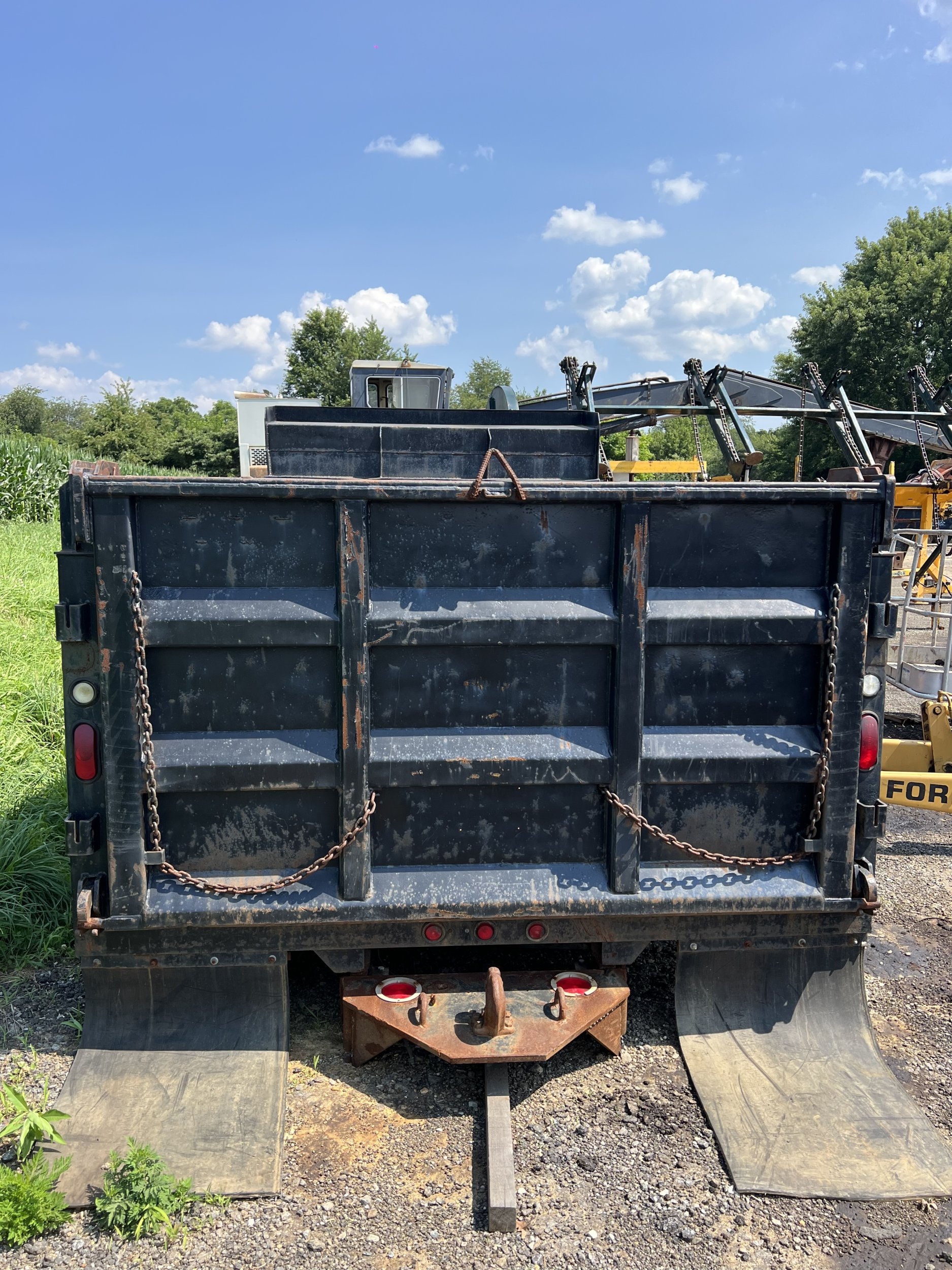

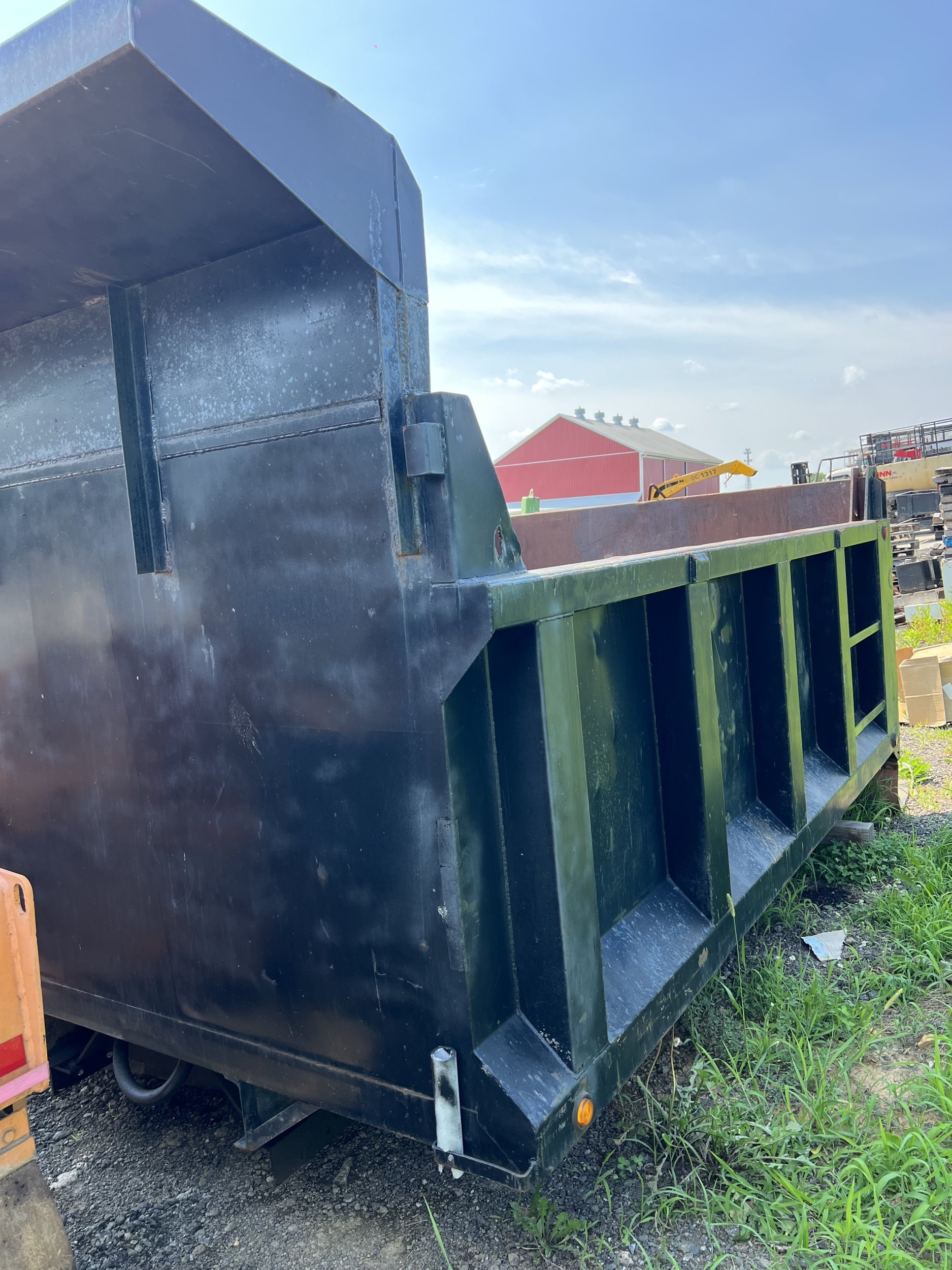

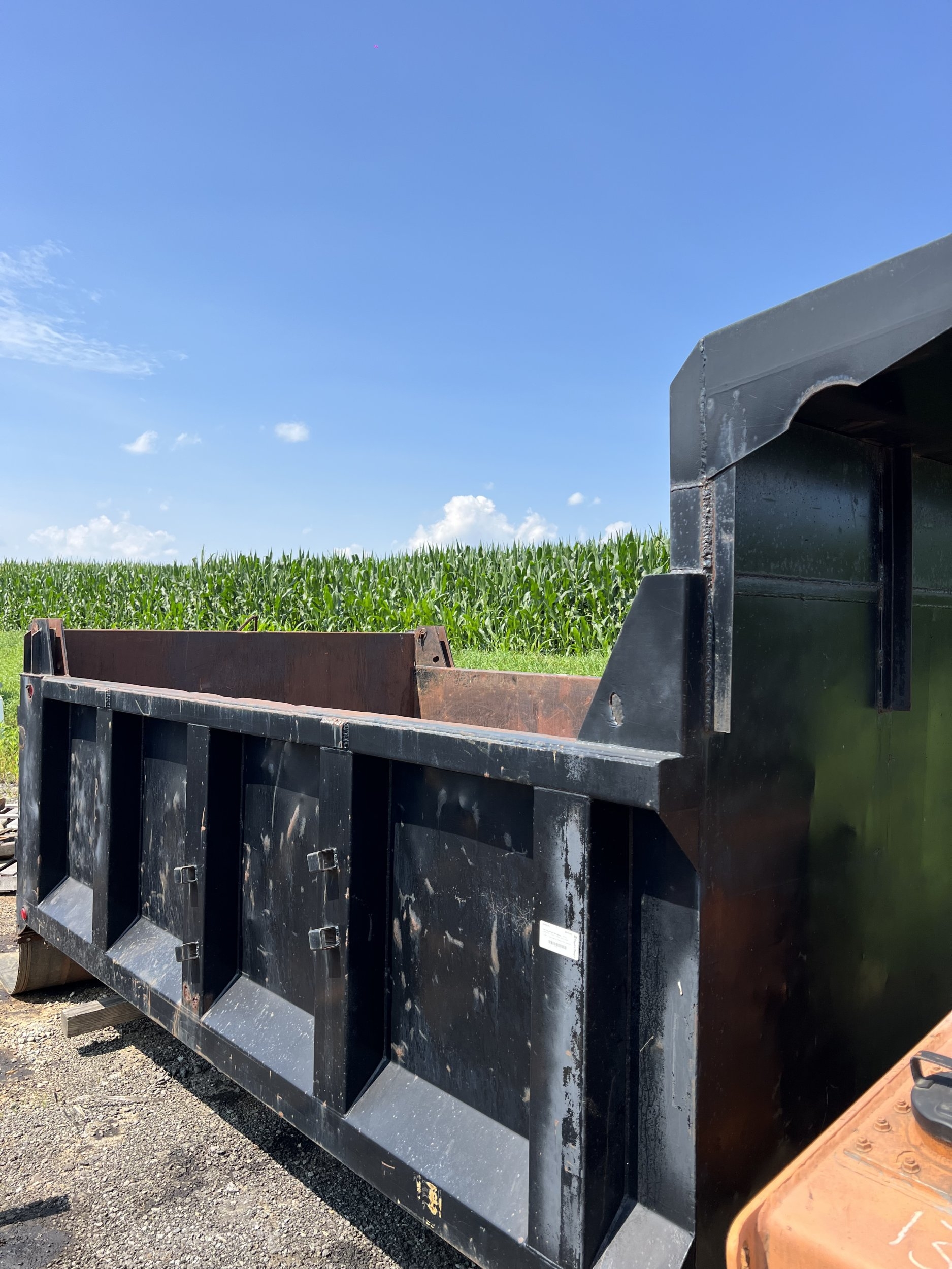

Finally got a look at the dump bed.
Mixed feelings.
Overall the size & look of it are just right.
Gonna need a few repairs.
Generally, it’s straight and the size/dimensions I was looking for. However, the floor has a few welds and one of the uprights is rusted through at the bottom. I didon’t pick up on that from the sellers pictures. Not a big deal to fix.
I can’t worry too much about being “perfect” on a 16 year old dump truck.
Outer Frame replacement starts next week.
