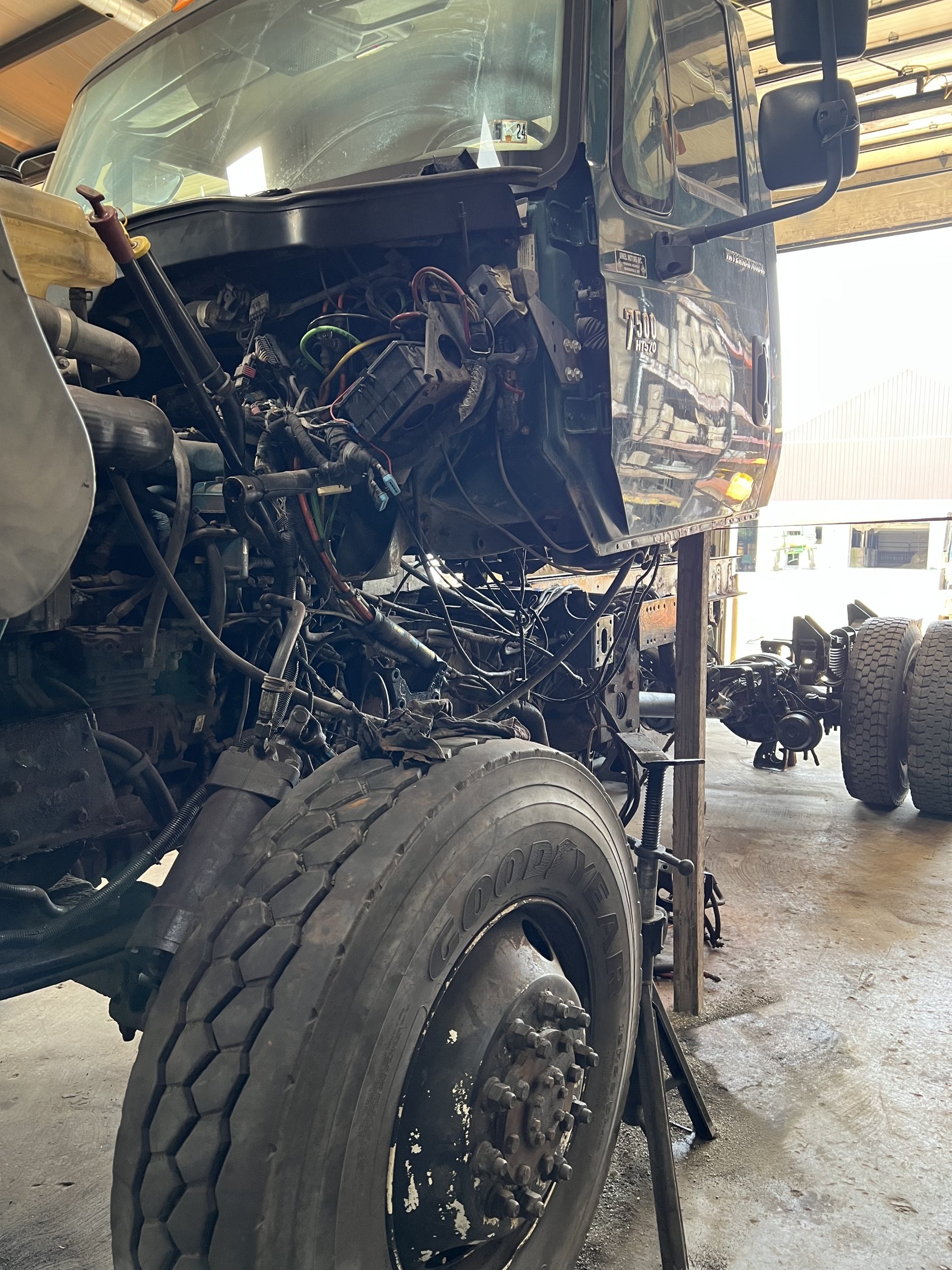

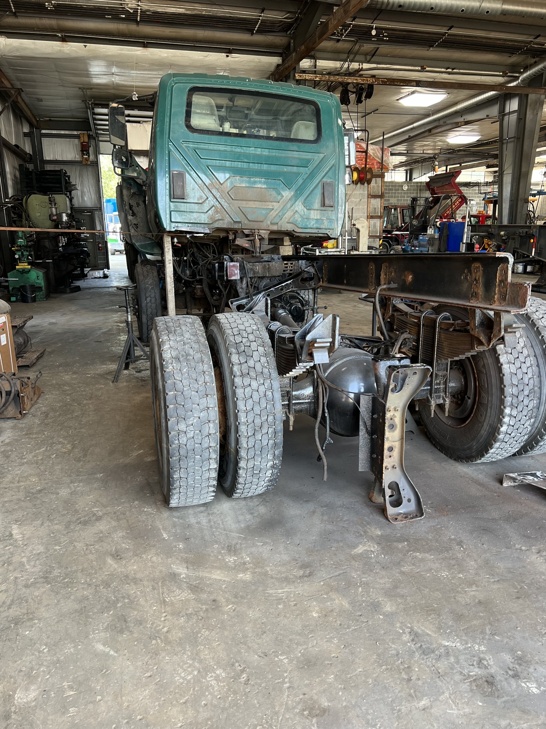

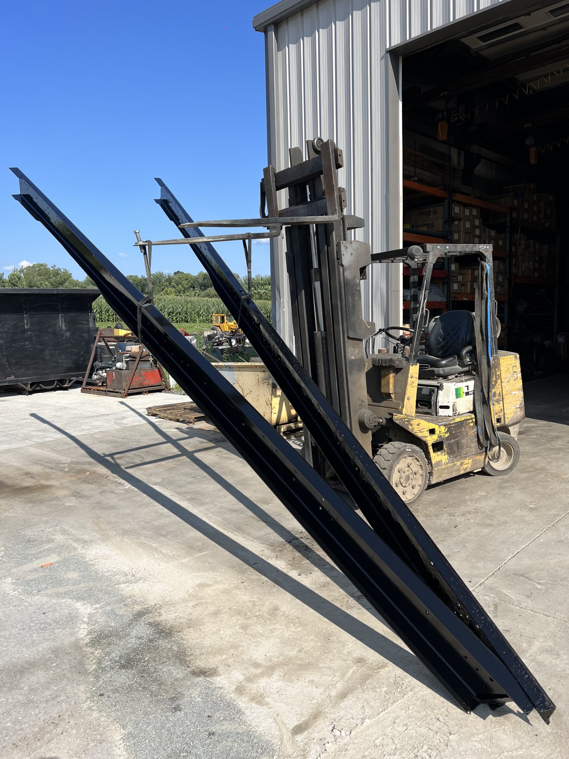

BIG BIG day today.
Drivers side frame(s) removed.
Passenger side being removed.
Here you can see the new outer frame on the left, freshly painted and the existing inner frame, repainted on the right.
The inner frame was used as a template to drill the outer frame, as you can imagine.
If all goes as planned, the new outer frames will make the truck look new & smooth.
Not sure if the juice will be worth the squeeze, but if I can keep total project cost below 60, my goals have been achieved.
New truck of this power with 4WD and a dump body would be $140K today.
