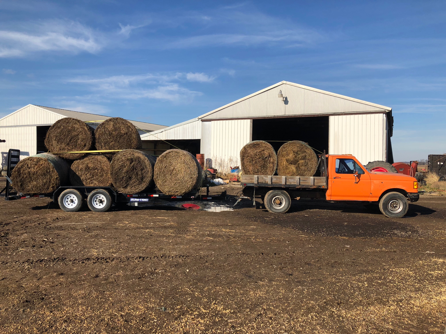

#104
Went from way overloaded at 4 bales to hauling 11 bales and staying legal lol.
But turns out another truck drove itself to my house to replace the orange one IMG_9251.JPGIMG_9253.JPG

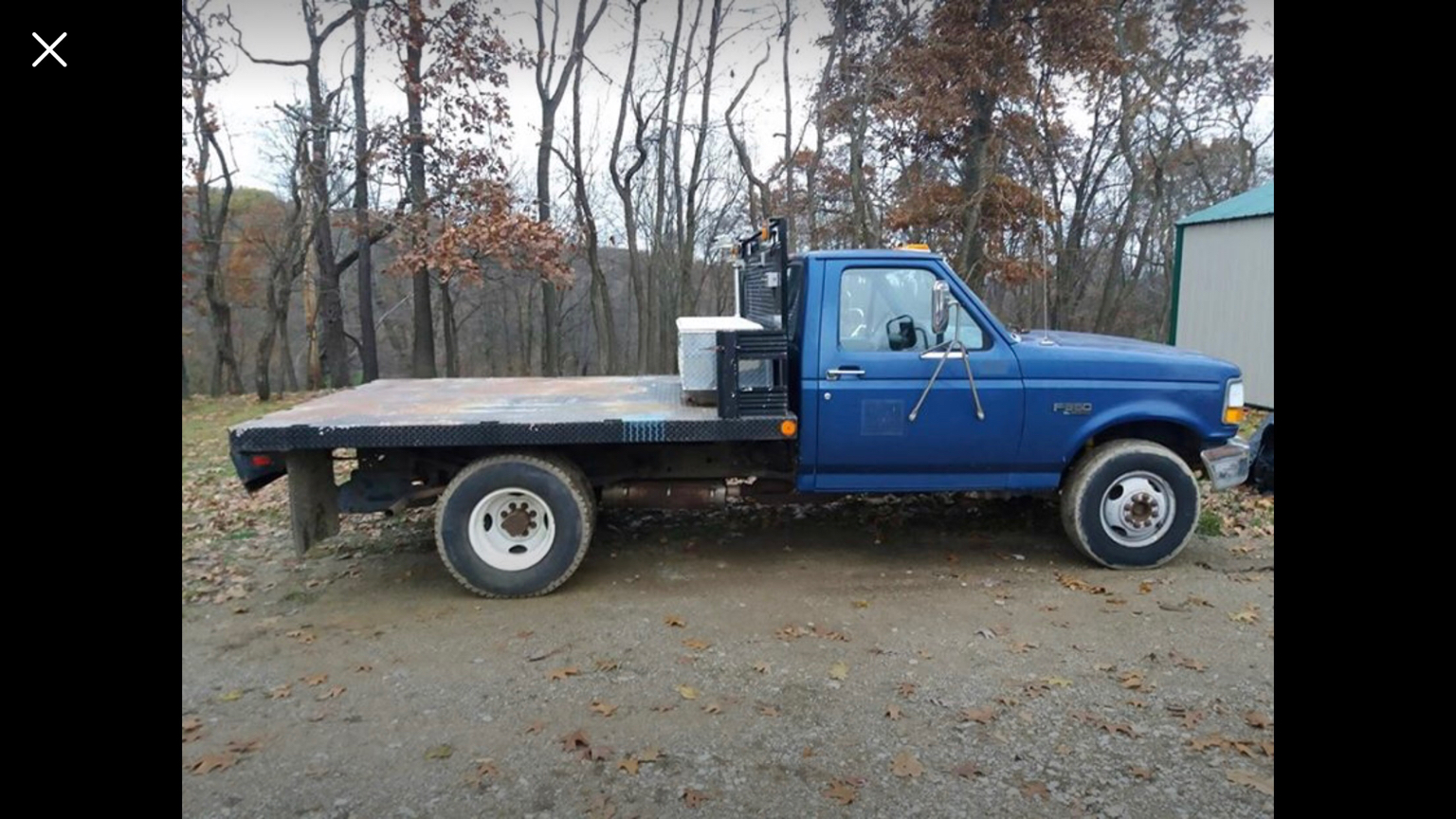

1995 F350 dully, 460 v8 with the 10.25 sterling with working limited slip rear, truck gets around SO much nicer than the orange truck, it won’t spin rear wheels for nothing. IMG_9271.JPG

Nice, 5-speed or auto?
Orange truck is a 5 speed with no parking brake lol.
Blue truck is automatic with working AC and the hottest heater I have ever felt in a truck lol. It was a city truck, has a hour meter on the truck also.
I have a hill in my back yard, my orange truck spins a wheel all the way up it no matter how hard you try not to, the blue truck didn’t even spin a wheel, it does a good job.
I’m into the orange truck $1400 as it sits, it’s now mechanically sound. I bought the blue truck for $1800, it’s got a few minor things but nothing to the extent of what I fixed on the orange truck. Hopefully I can sell the orange truck for around 2k or a little more.
