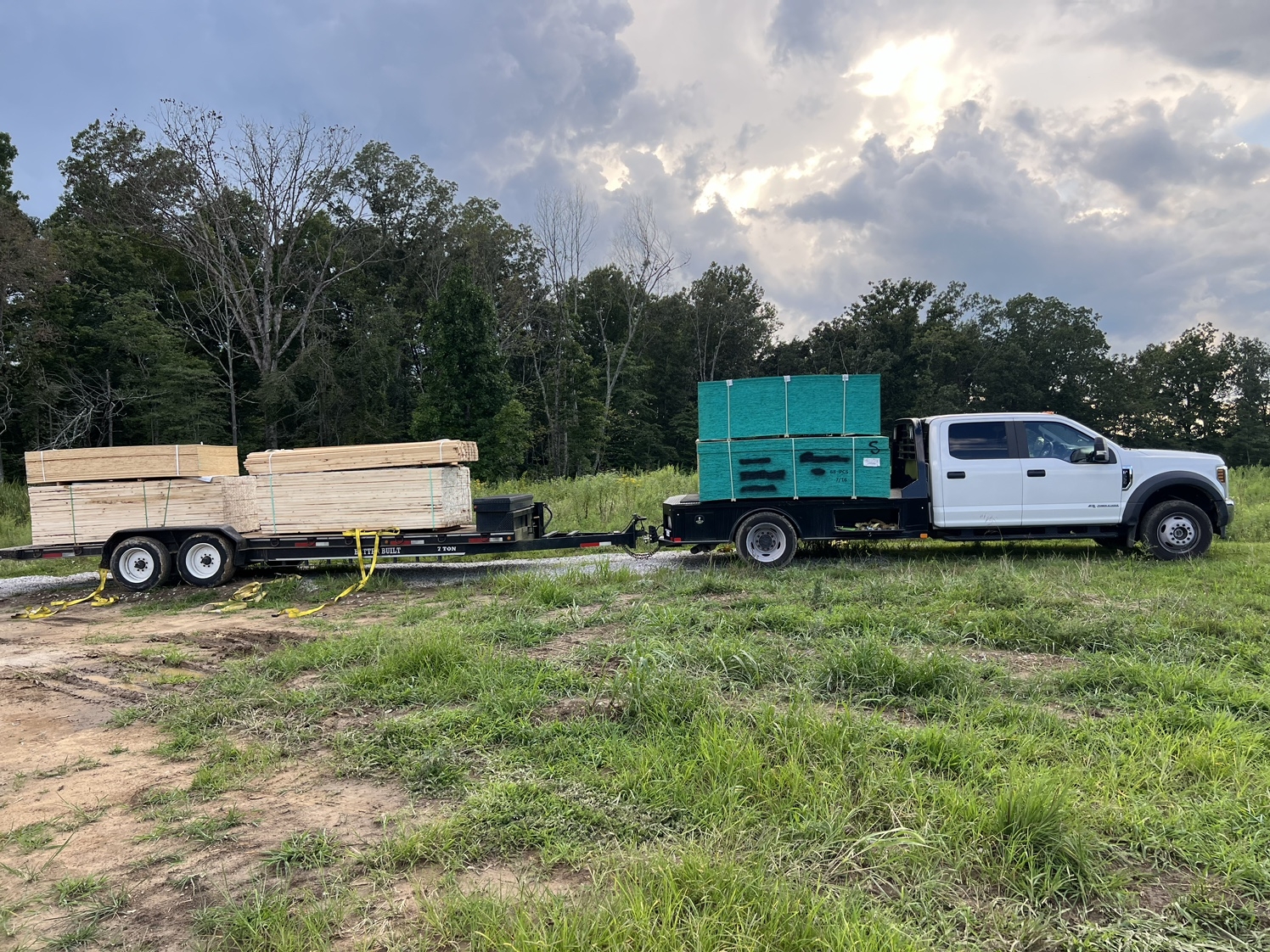

If it wasn't a dually, I would change the emblems on my truck to F150 just to make people wonder!
