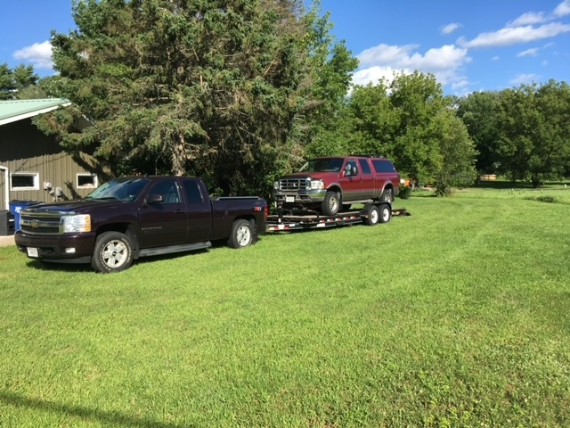

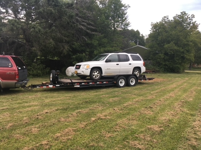

I have owned a manual tilt 23FT (17ft tilt, 6ft deck)trailer foe about 21 years now. The trailer has worked great for me for hauling implements and ok foe hauling vehicles. I say only ok for vehicles because most I have hauled have been too long for the manual deck to tilt correctly. If the vehicle wheel base is long the trailer will tilt before the back wheels of the vehicle are on the trailer bed. I overcome this issue by using the ramps usually used for oil changes where you drive the front of the vehicle to gain ground clearance to work on the vehicle. I place these just under the rear of the trailer and drive or tow the vehicle to be loaded up these ramps onto the trailer. The only winch I have used to load a disabled vehicle is a cheap harbor freight 2000 pound atv winch mounted to the top of the trailer jack post and a snatch block with the cable back to the front of trailer. I have jumper cables that clamp together that reach the winch for power from the towing vehicle battery. Or a come along. It seems to be light for my purpose but has worked well for me. I was always going to add a receiver winch mount and a larger winch but with the rolling loads I have needed it for I no longer feel the need. I will try to attach some pictures of some of the vehicles/equipment I have hauled. IMG_2468.JPG
