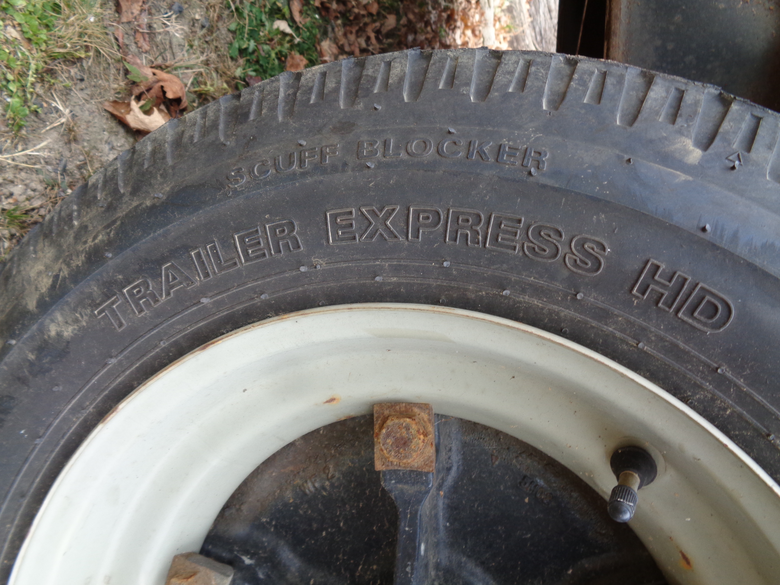

That trailer appears to have house trailer wheels/axles.
If so, they are rated for a very limited life usage.

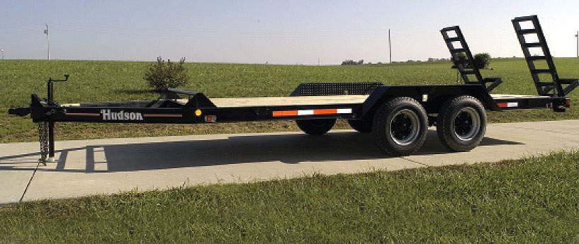

No, go to the Hudson trailer website and look at the HSE-18 trailer. They still use these axles and wheels on them today. The mobile home axles have thinner tubes and no camber bend. Equipment trailer axles have heavier tubes with a camber bend in them. The tires are equipment tires, not mobile home tires.

It is not possible to determine the axle type just from your pictures.
The tires certainly may be equipment trailer type.
The wheels do appear to be standard house trailer wheels however.
The HSE-18 trailers shown on the Hudson Trailer website, most definitely are not shown with the same style wheels as those in your picture.

You might want to look at their "PRO SERIES - HSE DELUXE 4 TON" found at: Hudson Brothers HSE DELUXE 4 TON
628906d1573954916-trailer-buy-hudsontrailer-jpeg
Those are Dayton style rims, that is also the type used for mobile home tires, but they are not necessarily mobile home tires. I would bet that those axles have bolted on (vs welded on) brake backing plates and all parts are serviceable.

Aaron, Thanks for posting up that picture from Hudson's website. That is my trailer just like the picture that I put up on here. YES, the "RIMS" on these trailers and mobile home trailers are one and the same. The tires however are not. Mobile home tires are clearly marked "FOR MOBILE HOME USE ONLY". If anyone doesn't believe that just go look at some. My springs are also serviceable with replaceable brass bushings which is another plus as I am going to update them with grease-able bolts. I don't think anyone is going to fork over $6,000.00 for a new trailer like this if it came with non-serviceable brakes.

One thing I noticed about my trailer is that the loading ramps are much longer than the standard ramps. Hudson's website does list optional longer loading ramps.

They MIGHT be. They make that style wheel and tire in a "trailer" non-mobile home trailer tire as well as in a mobile home rated tire.
Here is a Kenda Load Range G in that size for a "trailer tire" (ie: not a mobile home tire): Kenda 8-14.5LT Bias Trailer Tire - Load Range G Kenda Tires and Wheels AM1289
Here is the same size and rating Kenda Load Range G "Mobile Home" tire: Kenda K391M Mobile Home Tire - 8-14.5MH - Load Range G Kenda Tires and Wheels AM1327

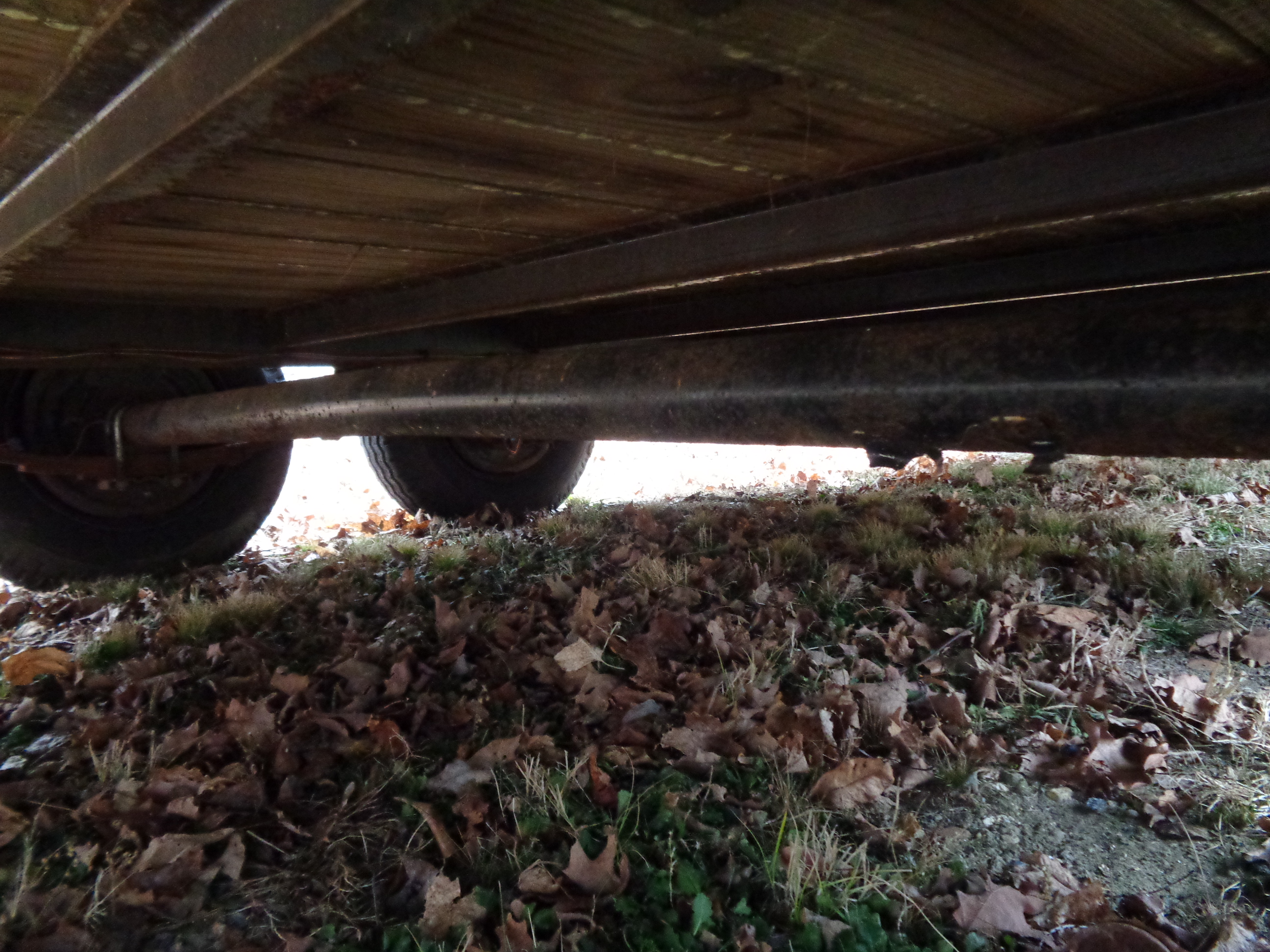

Thanks Aaron for those links. Anyone reading this and looking at the tire links will notice the MH after the tire size which means Mobil Home and the LT after the trailer size for Light Truck/Trailer. Here are some more pictures of the tires, axles and backing plates on my trailer. The backing plates are held on by five studs, I think. I wasn't laying down on the ground to make sure. The axles are sprung in the center for wheel camber. Aaron ?? for you. Are the 7-14.5 and 8-14.5 mounted on the same width rims? I have 7-14.5's on my rims. I found where the 8-14.5's are one inch taller. My guess is that the tires are the same width. I can't seem to find any information on rim sizes for these tires.. I'll keep looking though. My ramps have an added section 2 feet longer than standard. They are 6 feet long total. They will be getting the helper springs added to them for easier lifting.

Seems like this discussion keeps going round and round about TIRES.
If the tires say "trailer only" or "LT", and are of proper size and weight rating, they are just fine.
My post#40 intent was to discuss the style/type of AXLES/WHEELS....ONLY!

They make that style of axle/wheel in both non-serviceable "mobile home grade" (cheap, undersized bearings, oddball spindle size, welded brake backing plate, straight axle tube, etc) which are intended to be used once or twice and serviceable "trailer grade" (full sized bearings, standard trailer spindle size, bolted backing plates, cambered axle tube, etc) which are intended to be used day in and day out.
Both are generally rated for around 6000# per axle, one is made to be used once, the other is made to be a heavy duty low profile axle.
One is junk, the other is not.
