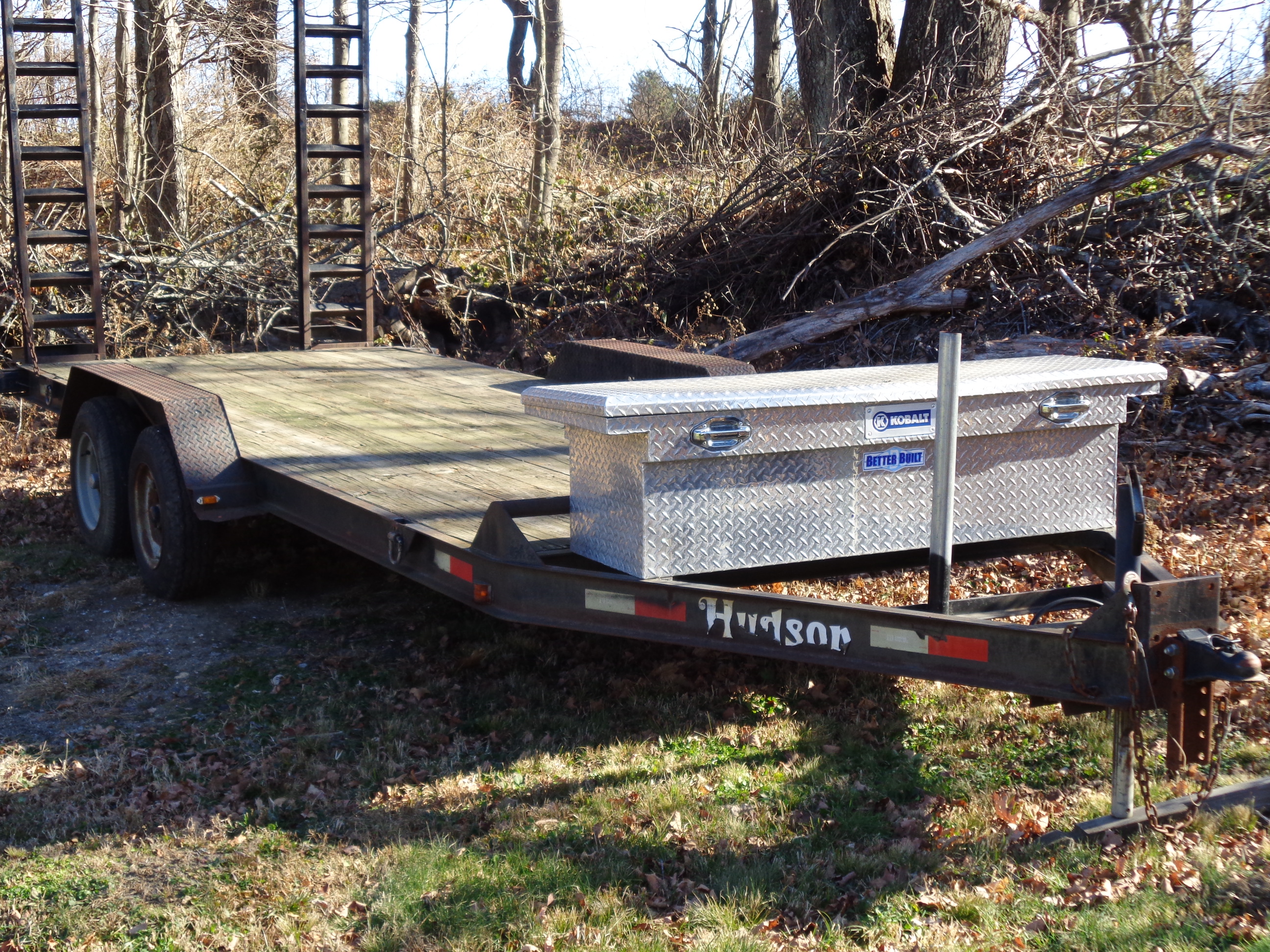

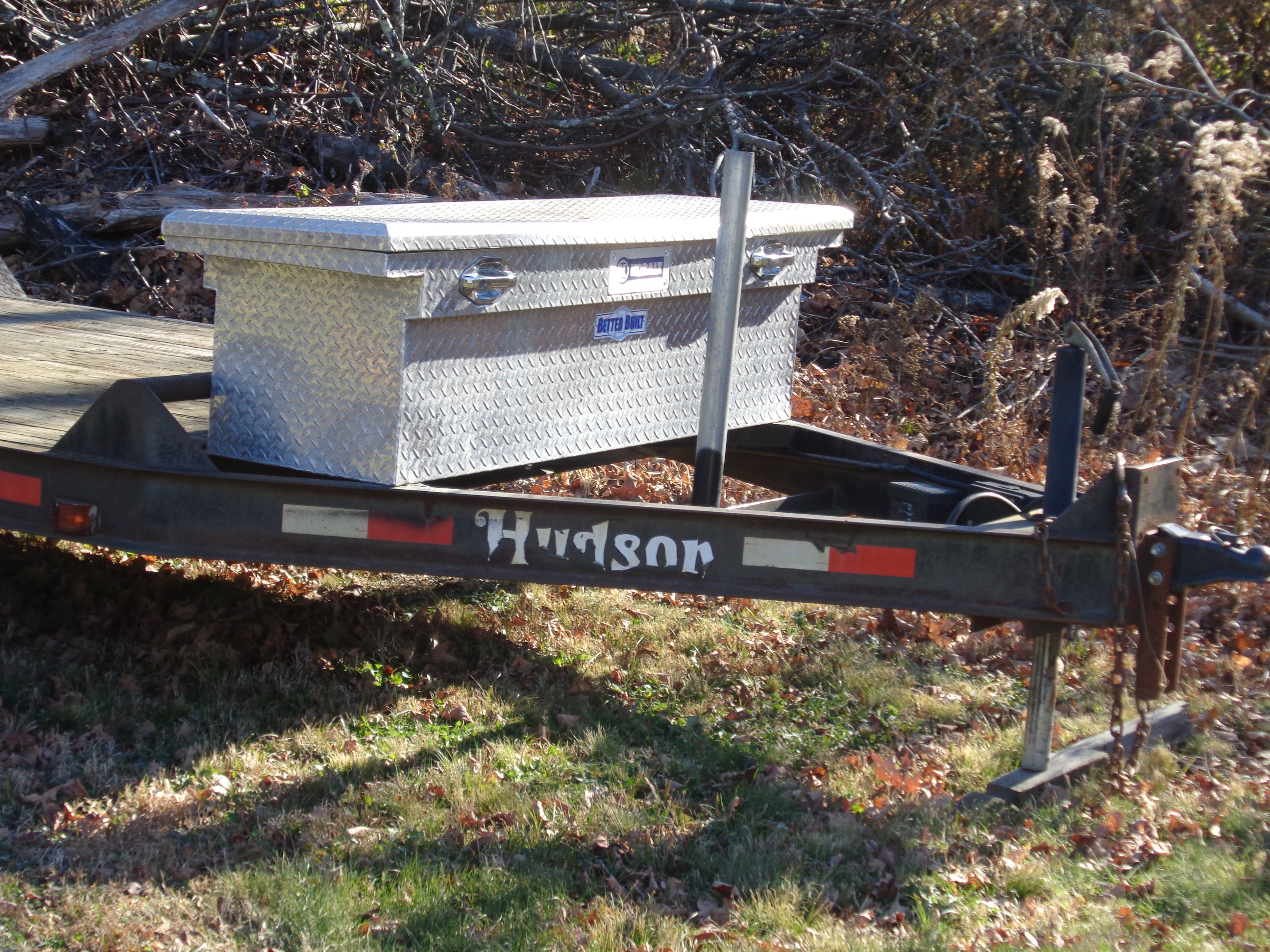

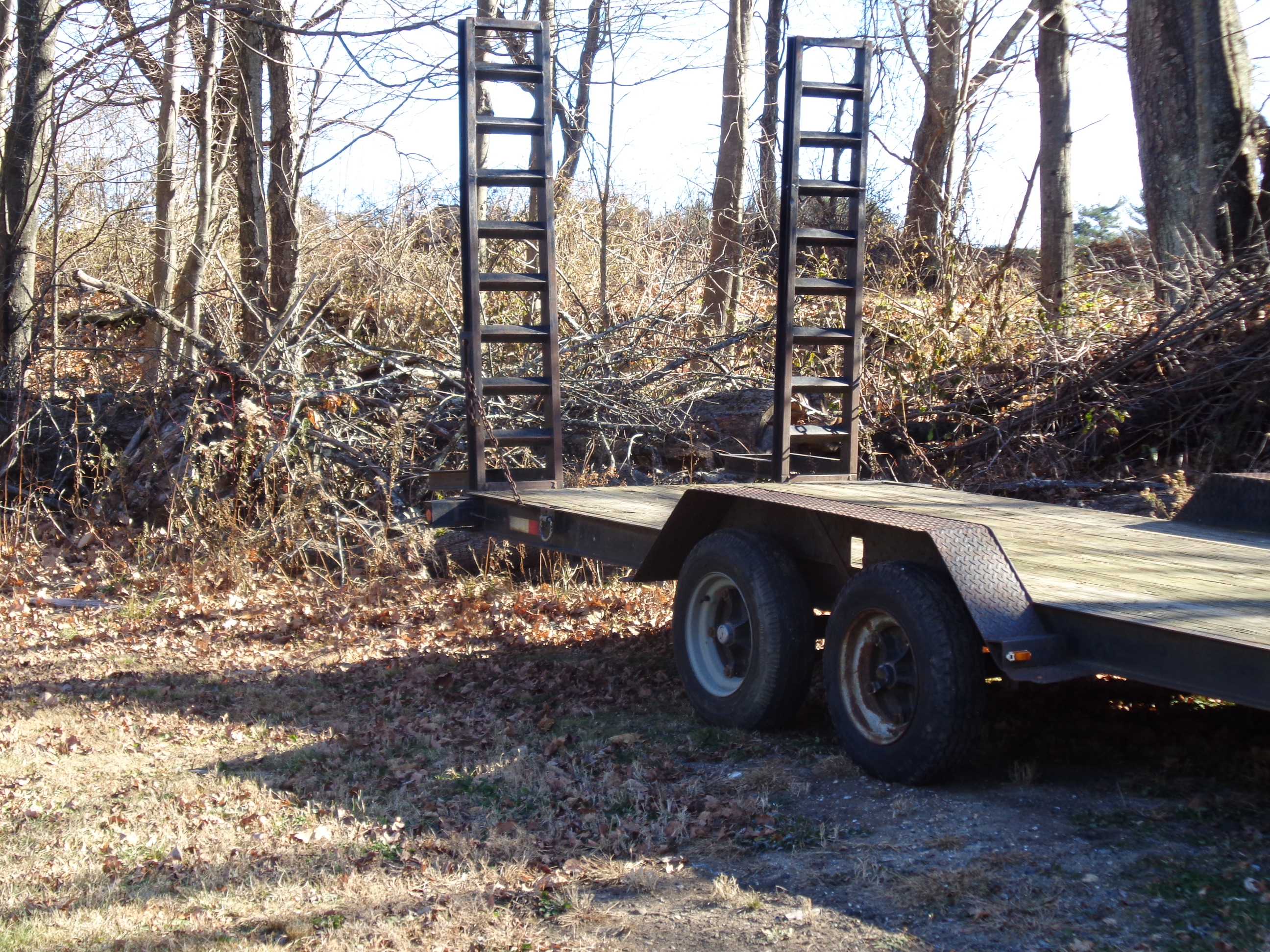

#38

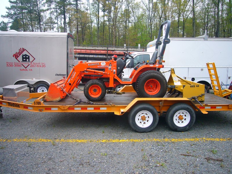

My trailer.
/ Which trailer to buy? #39
Sweet!
/ Which trailer to buy? #40
My trailer.
That trailer appears to have house trailer wheels/axles.
If so, they are rated for a very limited life usage.
