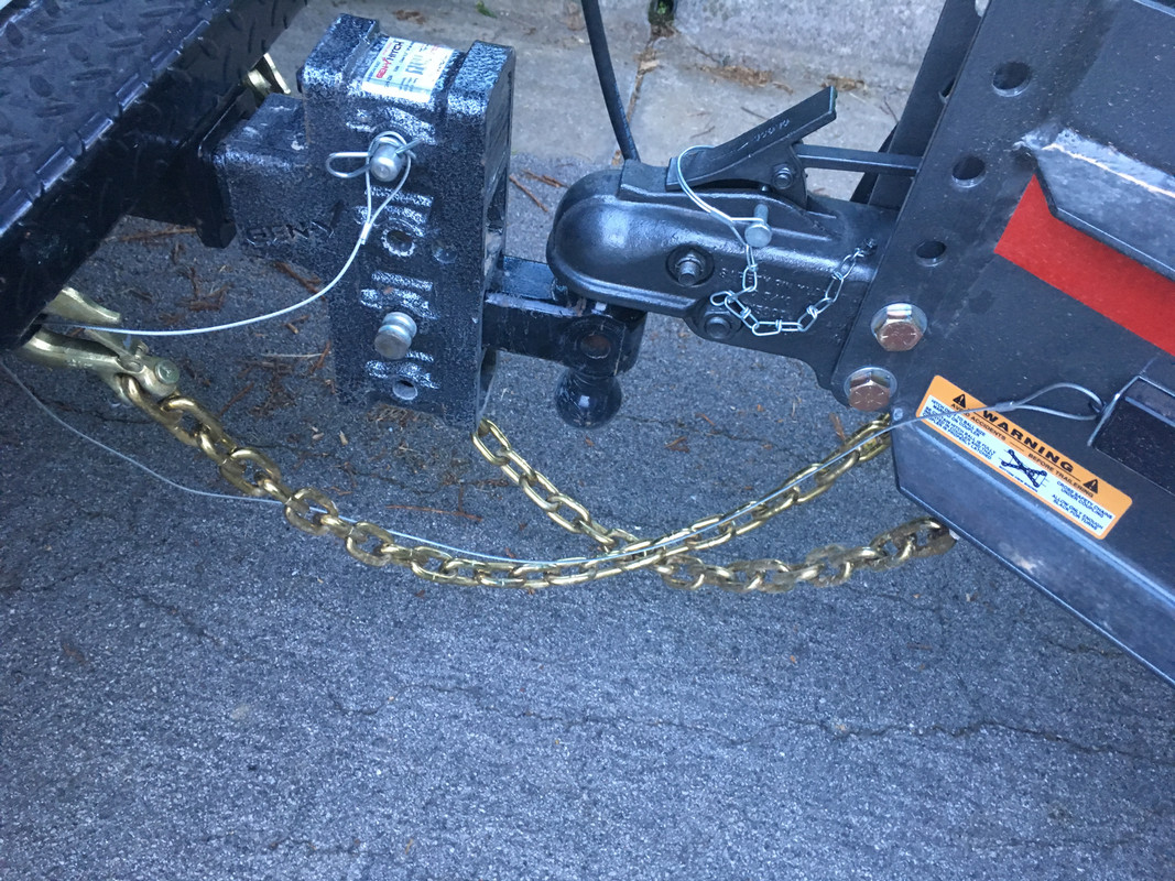

If it’s solely for personal/private use, there is no Federal DOT required, regardless of weight. I don’t know Massachusetts’ State laws.
Instead of an adjustable coupler, why not get an adjustable ball mount;
My trailer is adjustable, but I find it easier to have an adjustable ball mount.

I have multiple trailers with multiple hitch heights. Some are adjustable some are not. An adjustable ball mount saves time and hassle. Unless you have multiple trucks with fixed mounts pulling the trailer you will be better served with a heavy duty adjustable ball mount. I have a Class V B&W 3” drop/rise adjustable ball mount with a combo 2” and 2-5/16 ball. All you do is pull the pins and adjust and/or swap ball size. Best thing I have bought in a long time.
I already bought a deep drop ball to use my friend's trailer. Good deal to have both for multiple trailers. I think Mass has a 10K limit for personal use. I will look into that.

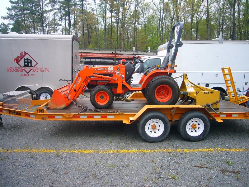

/ Which trailer to buy? #16

Thanks, That looks just like one I am considering.
If you are hauling tractor with front end loader plus brush hog I would go 20ft.Not enough room on 18ft trailer IMHO.
/ Which trailer to buy? #20
Yep. I have an 18’. Go 22’, if possible. It’s amazing how often stuff hangs off the back of the 18’.
