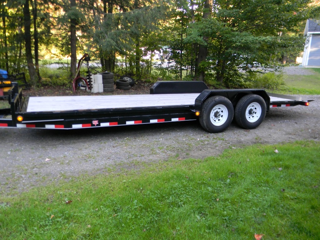

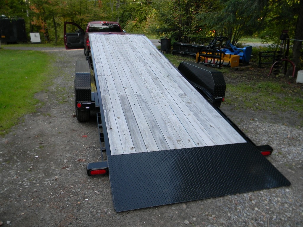

Yes, I prefer the tilt bed. I've had many conventional trailers with ramps in the past but as I got older ramps were no longer fun to use and seemed to get heavier too, plus with ramps many smaller low clearance cars have a hard time getting over the hump.
My current trailer has a 22' wood deck and the 2' tail is steel. I do have a 8K winch installed (not shown)
I also agree with others that a 10-12K trailer would be better for your application.
