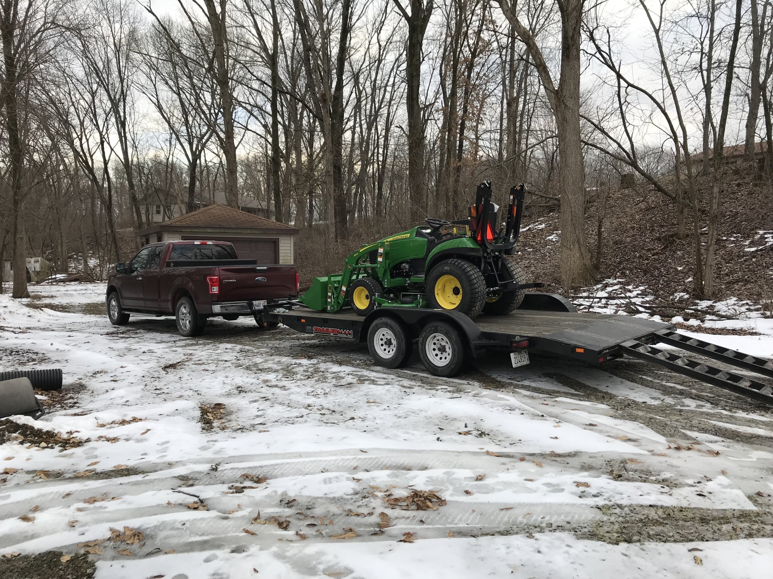

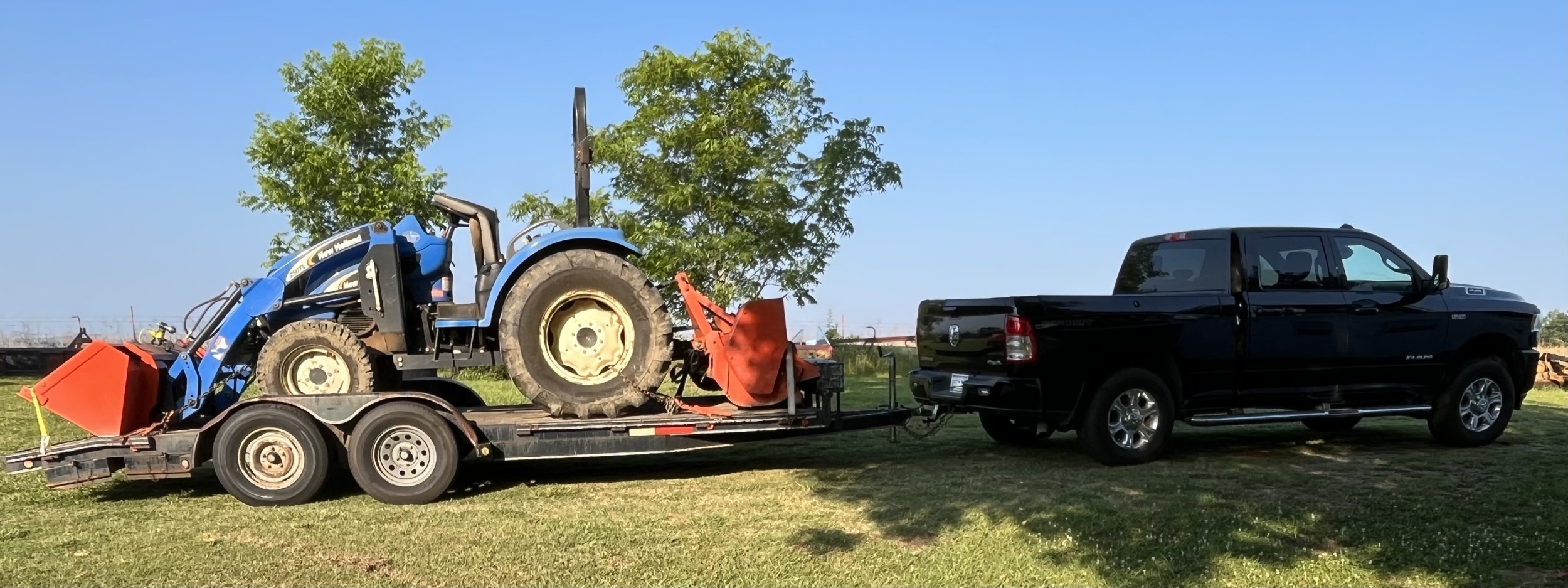

I wish my 18’ trailer (16’ flat plus 2’ of dovetail) was longer as there’s little room to really adjust the placement .

I would think a 18 foot trailer is plenty long. You don’t want to small a trailer but why buy bigger than you need. This is my JD2025r on my trailer. It’s a 16 foot with a 2 foot dovetail. You can see there is plenty of room on the back. My tractor is probably smaller than yours.
diselscout80
thanks for the picture as it points our an 18 foot tailer leaving no space for adjustment
Dodge man
Thanks for the picture. Nice looking trailer, truck, tractor, and land with the snow. Looks like the trailer ramps are plenty long so not too much of an incline for a tractor.
My Kioti CK27 HST might be a slight bit larger than your JD 2025 R but I bet they are pretty close. From memory My tractor has around a 60 inch wheel base. The 65 inch flail mower does not extend out as far as a rear rotary cutter.
Thanks
