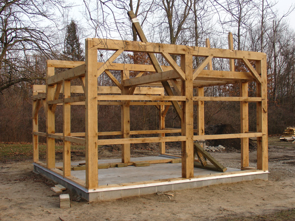

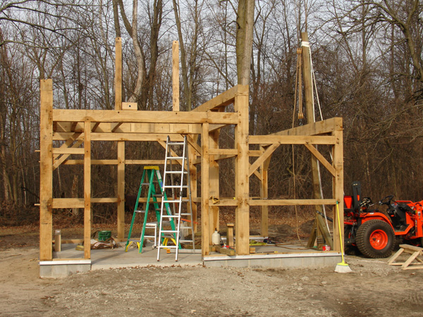

One question: Why did you lift the really heavy stuff by hand (2 guys at 250 each) instead of using the tractor or the Dodge pickup in the first pictures to do the heavy lifting? It appears you did use the tractor for some of the later lighter stuff.
Thanks Joe:
The manual work was done as an experience thing, i.e. the old way of doing it and the experience of rigging everything up. Plus there was no good way of changing the pull direction on the gin pole and still be able to keep the pole upright under load. It was really not that bad and was quite enjoyable as an experience.

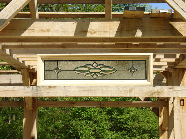

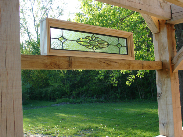

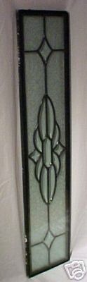

Still making slow progress but getting things done. I got the front gable soffits framed in and the fly rafters on. I don't have enough time this weekend with Mother's Day , etc. to get everything out and since I needed to get the windows framed to be able to cut and install intermediate framing I decided I'd better get them framed out. If you remember I started with leaded glass panels sealed between two layers of safety glass. Some door frame stock and some moldings later I have one of the windows framed.
Over the winter I picked up a few e-bay goodies. I got an 8 x24" redwood tombstone gable vent for the back gable wall peak. I also picked up 3 15" lightning rods probably from the 20's or 30's. The barn will have a working lightning protection systems. Last week I found old copper woven lightning cable. It already has a nice verdigris patina and I think it will look good against the galv. roof. There will be one rod on each end and one in the middle then I'll use white porcelain insulators to support the cable between rods and keep it off the roof. I got 50' for $40 delivered which probably saved me $100++ over new and the verdigris finish was free.
Here are pics of the completed framed window and its placement. First pic. is what I started with, the last three are the finished window.
Regards,
Kevin

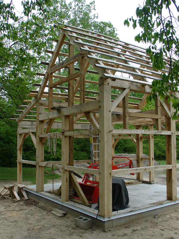

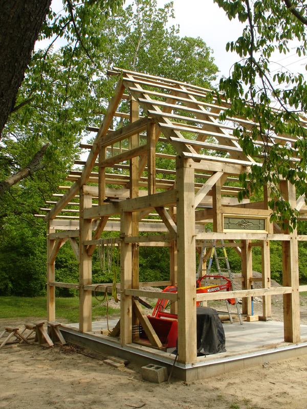

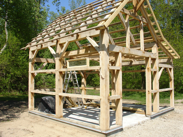

Only got a half day this weekend to work on the barn but I got most of the intermediate framing done which frames out the windows. Good thing I left the gin pole standing in the back as the back wall framing for the transom probably weighed about 100 lbs. so the gin pole made it easy to get it up there.
Finally got the 1x6 T&G for the soffts delivered this week. Even though it doesn't look like it, it is getting close to being roofed and sided. I can't seem to get off the want of having a cupola so it has to be ordered and shipped before I get the roof on so I can make sure it is framed out properly. Next weekend is memorial weekend and I already asked the boss to let me have all three days to work. If I get them I will be able to finish up the fascia, soffits and intermediate framing and then be ready for roof and siding.
Pic. 1 shows the intermediate framing in, rear gable and side back bay. Pic 2 shows the two windows set in to get a feel of what it will look like and Pic 3 shows the rear transom window looking up from inside.
Regards,
Kevin

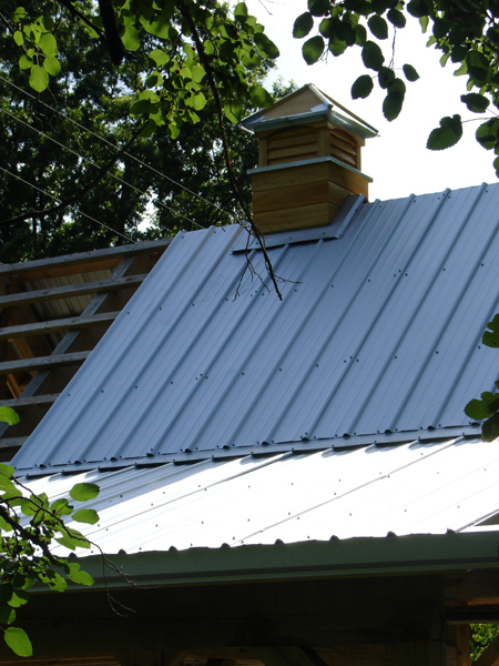

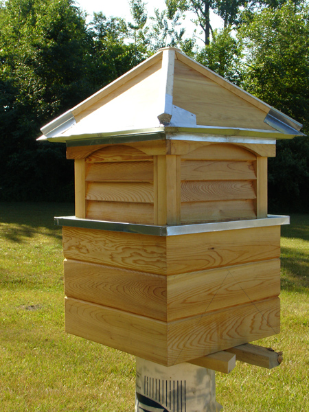

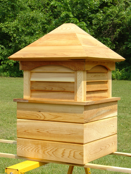

Still making slow progress but she is coming along. In the last installment I said I couldn't get the want of having a cupola out of my mind. Because all the metal is galv I wanted to be able to do a galv roof on the cupola. I found an all eastern white cedar cupola with a wood roof that would be just right to do a custom galv roof (Boy them things aren't cheep). Pic. 1 shows what I started with after its first coat of oil. I have an article reprint from the 20's that explains traditional batten metal roof work so I started custom bending up a roof. First I installed battens on the corners which took hours because of the compound, compound cuts that needed to be done for the hip roof (I'm compound angley challenged). Then I bent up the cornice and then did the end caps of the battens. I only have a 24" brake so I had to do the cornice in two pieces per side. All the joints are soldered and water tight.
I still have to do the roof pans and the batten caps which will hold the roof on with a double lock seam no nails. Pic 2 shows it this morning waiting for the rest of the roof. In Pic 2 you can also see where I bent up and soldered a skirt for the ledge below the louvers as this won't shed water very well.
Regards,
Kevin

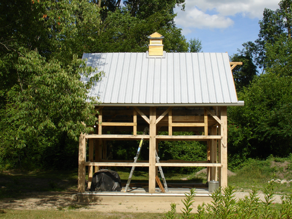

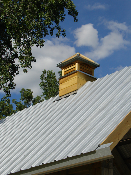

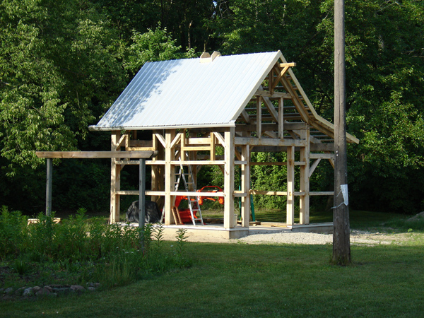

I have been working on the roof and it is 90% on. I left two panels off so I can still get out on it. Teetering on a 12 / 12 roof with tin isn't very fun. I think it is coming out very nice. At this stage I needed to get the base and louver portion of the cupola on so I can do the rake trim and ridge cap.
Pic 1 shows the first side of the roof on. You can see the cupola mount framing up top. The last four Pics show how it looks tonight. The cupola is on and secure. The cupola roof is just sitting up there for now as I still have to complete its tin as previously mentioned. Pic RoofCupola3 shows the transition from main to lean-to roof.
The Fourth of July is Wednesday so I'm hoping to get most of the rake trim up which means I will lose my access to the roof without climbing. The ridge cap is going to be the real challenge.
Regards,
Kevin
