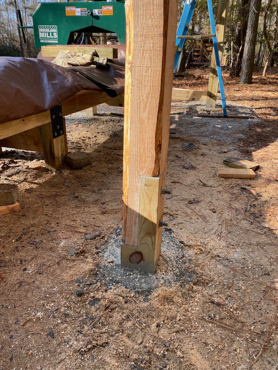

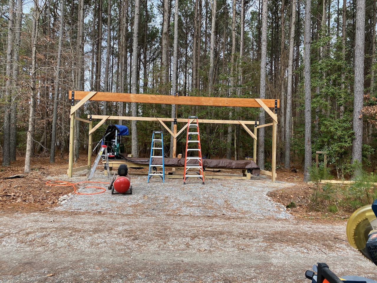

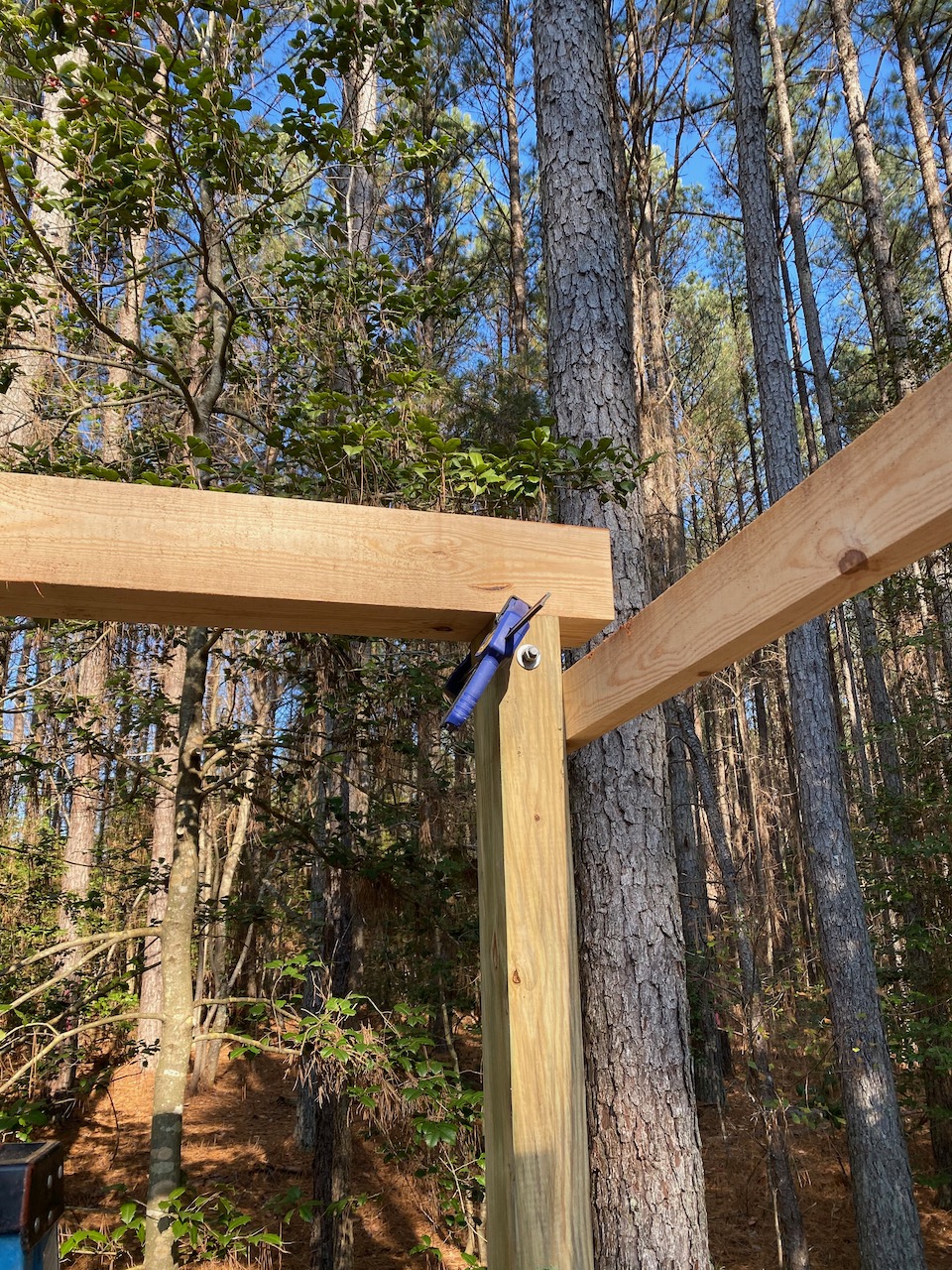

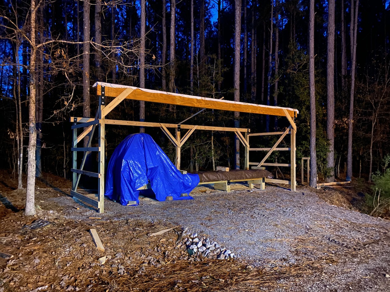

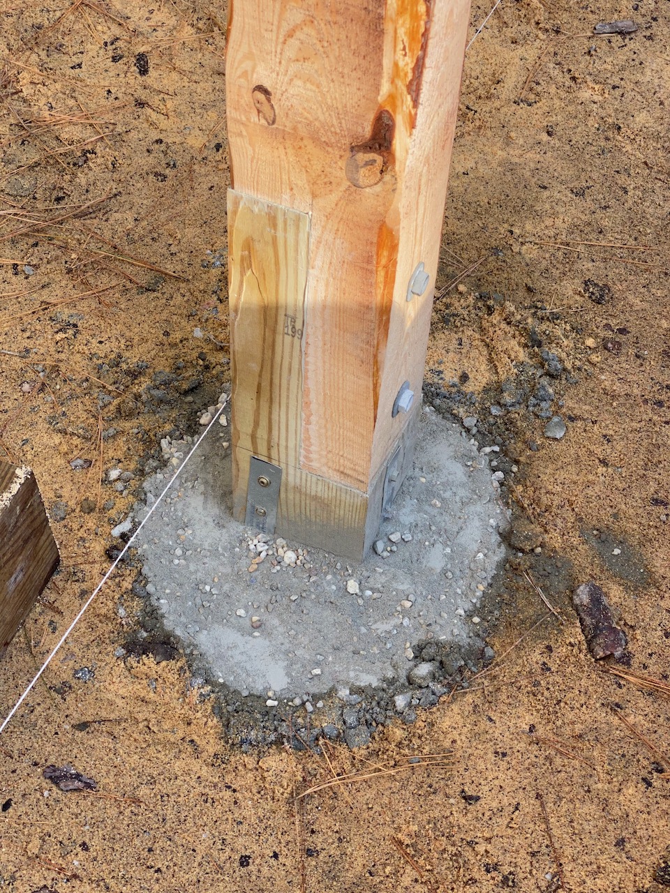

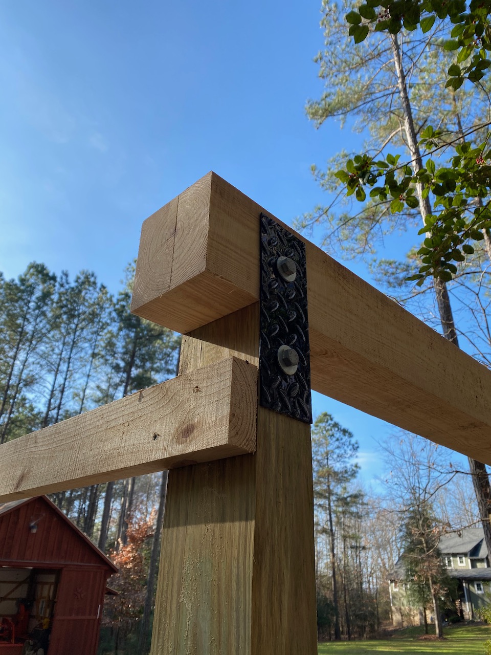

I'll post more pics as this progresses, but here are some so far. This is an 8x24' building that I am constructing around my Woodland Mills sawmill. It's a mix of pole barn, post & beam, and a couple modern elements. I am sawing up Loblolly pine from my property as I go along and building with that whenever possible. It will have a 3/12 shed roof, about 12x28' depending on how I frame it out (may add a front awning-style overhang, not sure yet).
For posts, I am using mostly treated 4x6 that I had, but the rear center post is a rough sawn pine top that I bolted to a treated 6x6 base:

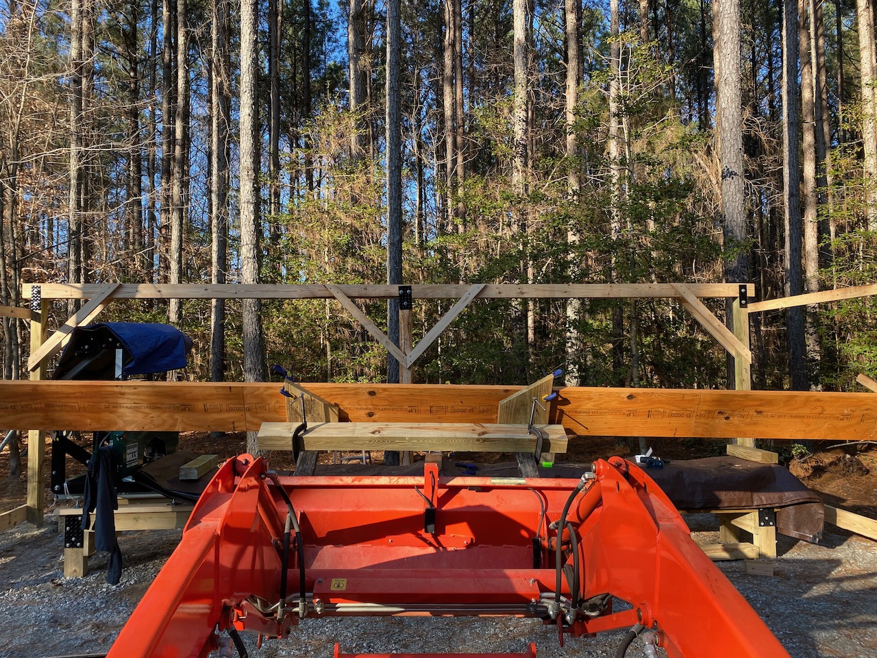

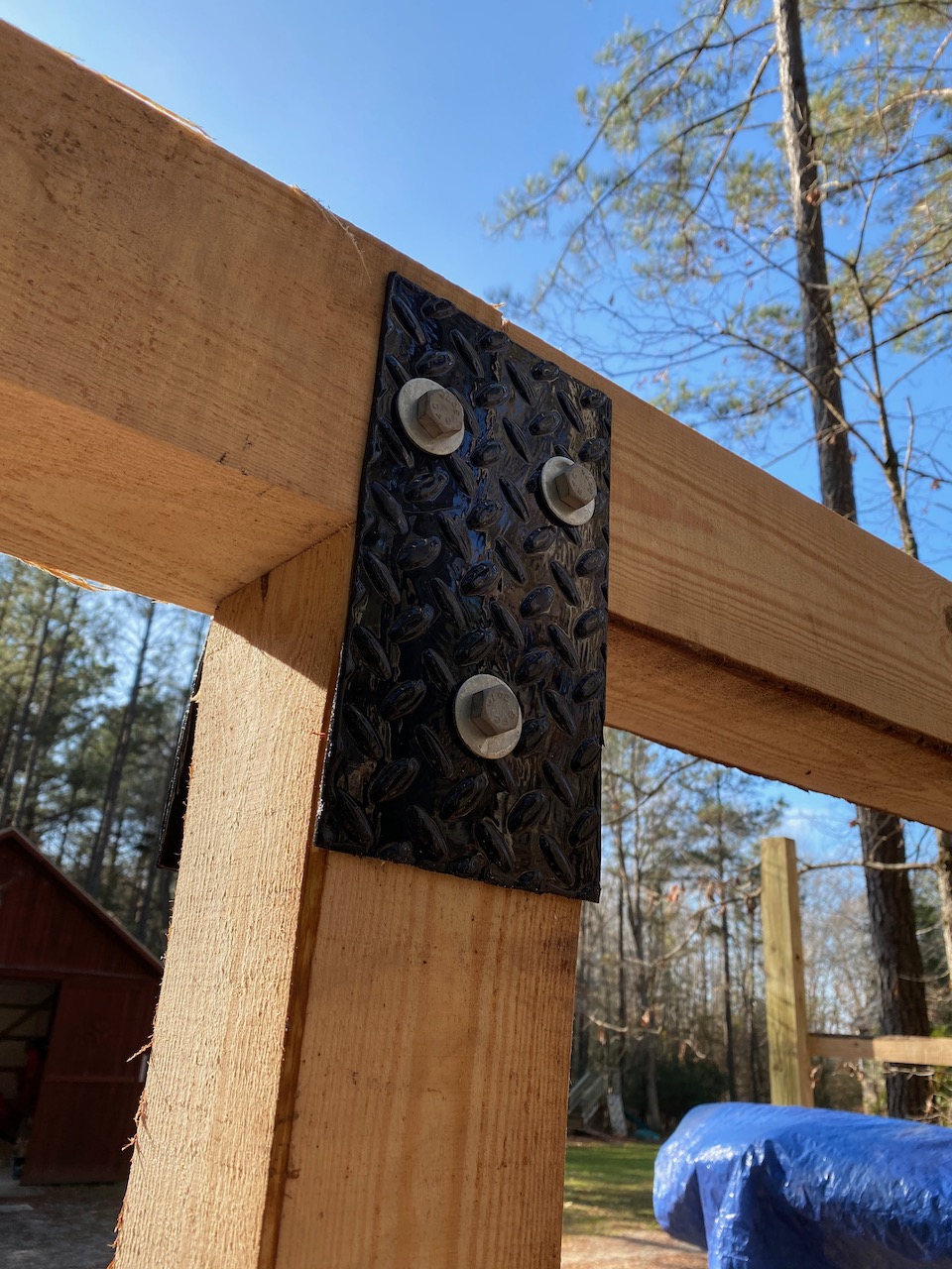

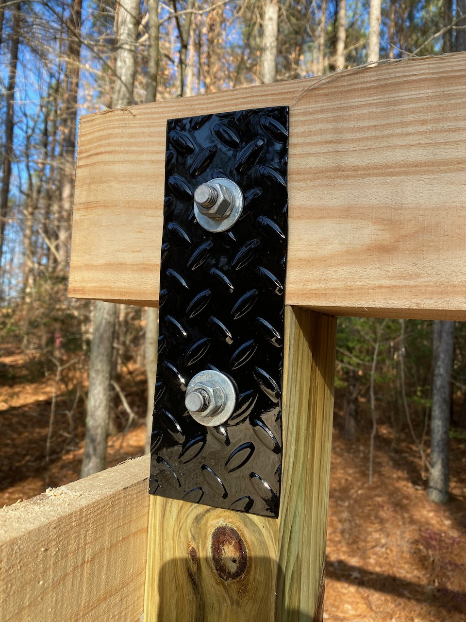

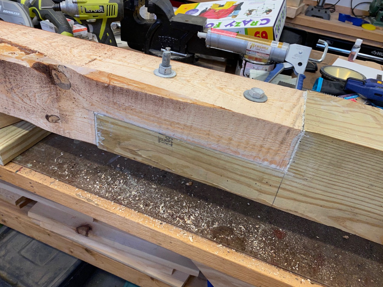

Rear beams are rough sawn pine 6x6 12' long, attached to the posts with steel gusset plates (made from scrap diamond plate I had) and 1/2" bolts:

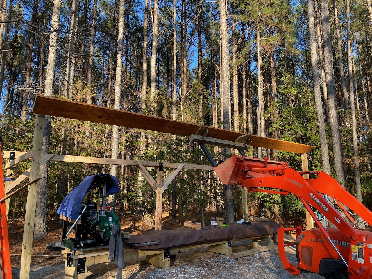

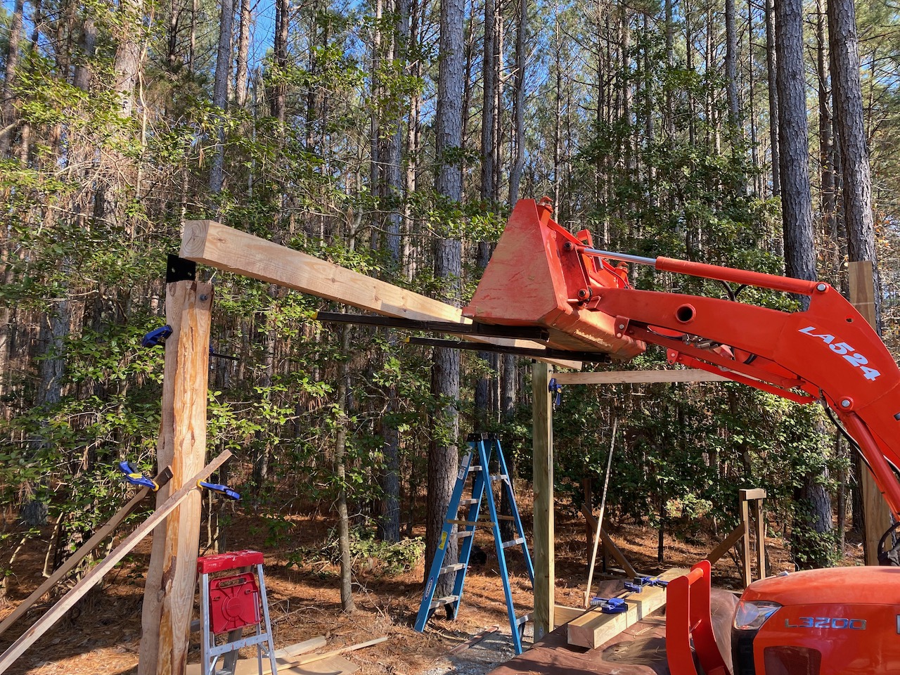

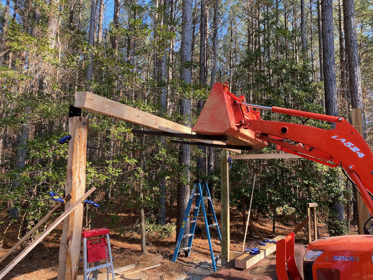

The front beam was originally going to be rough sawn pine, 6x14 by 25' long, to go the full 24' span between the front posts. I went as far as cruising my timber and picking the tree I would fell to make the beam, plan the skid route, etc. Then I did some math and realized that the beam would weigh almost 800 pounds when fresh cut. I didn't like the idea of lifting something that heavy and long with my front loader and I figured it might be impossible to horse it into final position while working from ladders by myself. So I checked around, and found I could carry my roof load over the 24' span with just two 1.75" x 11.875" LVL beams, which weigh just 150 pounds each. Not crazy about spending $276 on LVLs for a sawmill shed (seems ironic, right?) but it looked like a no-brainer, and I have to admit, was a lot easier than it would have been to make the large beam myself.

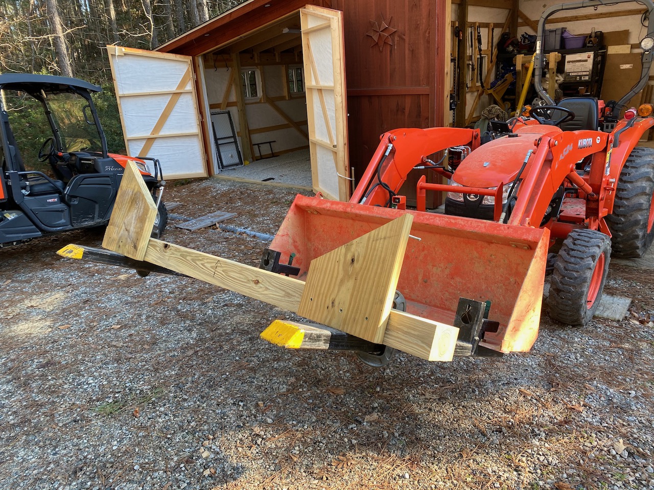

I rigged up a bracket on my forks to lift the LVLs into place. They have a protective coating and are slippery, so it was easy to slide them off the forks, onto the posts, and jockey into final position. They were sistered together with about forty 16D nails, and notched into the posts and attached with gusset plates and 1/2" bolts.

I spent today sawing 2x6 lumber for the roof rafters and 2x4 lumber for the roof purlins. We're about to get heavy rain and rain/snow from a Nor'easter this week, so I probably won't get much done. I tacked some scrap house wrap on top of the LVL for extra protection from all the weather until I can get the roof on. Roof will most likely be galvanized 5V panels.
Will keep updating with progress. Hope to be done by Christmas, or at least done enough...

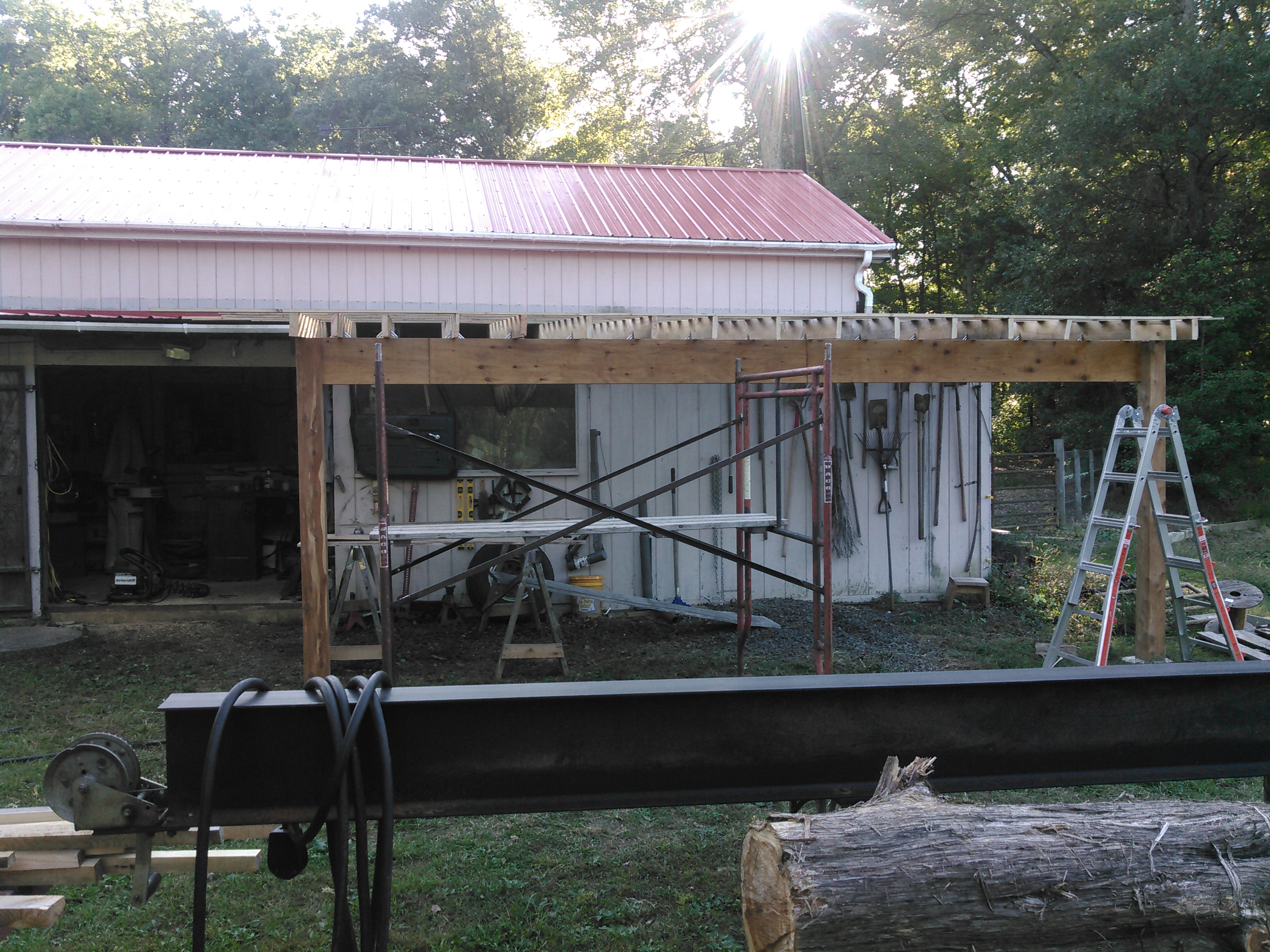

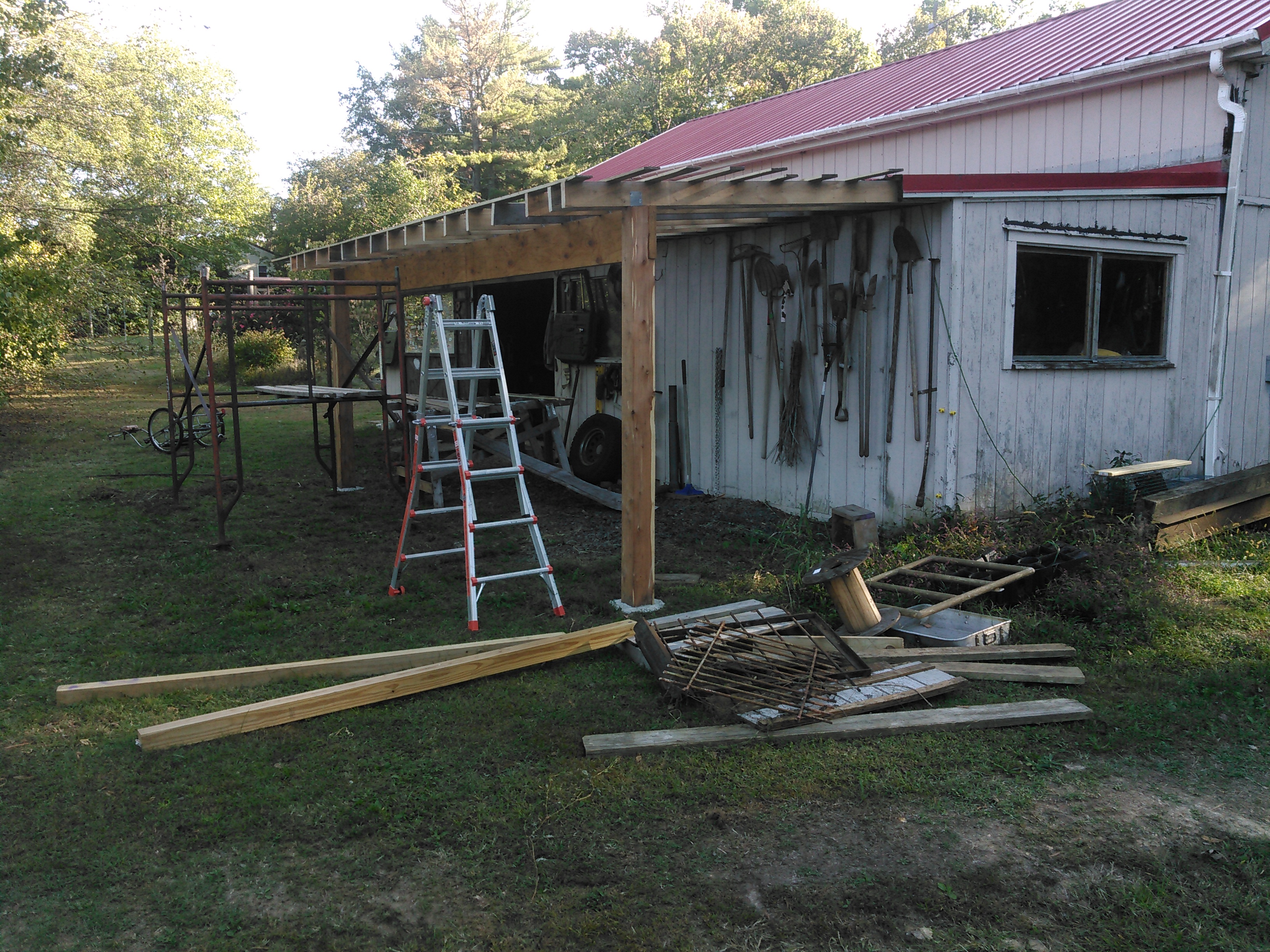

I used single beam for 19' span. 20' beam and ERC posts 6". But I was attaching it to existing structure.
I built my shed in 1991. Used yellow pine 6x6's for posts. Soaked the ends in used motor oil/diesel fuel, and planted in ground. They haven't rotted off yet !
Yep....rigging stuff to "git-er-done" :D
The LVL beams are interesting. Spanning 19 feet is something I need for a project I’m thinking about.
I do have to include snow loads into account for a span that far though.

... 24' span with just two 1.75" x 11.875" LVL beams, which weigh just 150 pounds each. Not crazy about spending $276 on LVLs ...

Well, I designed it to the same local specs we use for everything else here, 25-30 PSF snow load, so it ought to be fine (none of my other stuff has caved in yet!).
The LVLs can handle about 2.5X higher bending stress than my yellow pine beam would have, so a double 1.75x11.875 LVL is all it takes. More resistant to grain compression at the end supports too. And they are a fraction of the weight. They really are amazing beams.
I suspect wind loads and uplift are the bigger risks. I took every precaution I could, including steel straps in the footings that tie into the poles. But with only 5 poles in the ground, that is not a lot of anchoring. I am going extra crazy with bracing and diagonals, since that helps a lot. If you can keep the structure from folding, that lets the poles and anchors do their job. I have corner braces on all the posts, diagonals on the end walls, and I will put some diagonals nailed under the roof rafters as well. Combined, those will resist shear in all 3 directions. So if wind gets it, this shed will have to launch vertically into the air to fail. Knock on wood of course...
