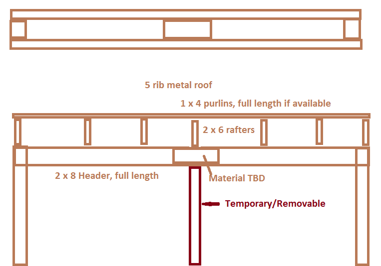

Another option might be to build as heavy as you can, then have temporary props to support the center. You would have to do use them religously though, as others have mentioned all that it takes is one snow load. Around here at least, those 12" storms with snow that melts in a few days is usually wet and heavy.

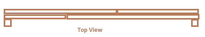

I'll probably use timber screws instead of nails, or maybe even carriage bolts through all of it. For now, planning on 1x8s, wood, metal, wood, metal, wood. I can get 6" x 50' galvanized flashing fairly cheap, then use a double thickness for each of the two layers. I know flashing isn't a very heavy gauge, but doubling it should help.
Posts are well anchored against kick out or lift. I typically use rafter ties also.
/ Simple Framing Question #24
Right now plywood is expensive but rips of 1/2" (4 ply) plywood would be much better that using galv. flashing as a flitch plate (if I understood correctly?)...to be effective a piece of steel should be at least 3/16" thick...
Be aware...no joint in the beam should be any further away than 25% from a post/bearing point..

^^ I have some pieces of OSB and other materials, but none are longer than 8'. Since the 1xs will all be spliced, I was thinking that full length (12-14', whatever it runs out to be) metal would help more.
/ Simple Framing Question #26
I would try to get full length 1x's and laminate them in place with osb or plywood in between the boards...put an 8' rip in the center and fill in the ends...even at 14' the breaks in the plywood is within the 25% rule...
use glue and clamps...(bolts make good clamps for laminating beams)

If you are getting milled oak boards ,have the guy mill some 4x8's or whatever? Built up beams, box beams, and flitchplates are alternatives to real beams IMO. Less work to just use a real beam.
/ Simple Framing Question #28
In one of the OP's posts it says a single member beam is too heavy to place flying solo...
#29
I've been thinking about a single beam. I have a couple of 4 x 4 x 8 oak posts and it's hard enough to lift those very high. I don't see being able to handle a 4 x 8 x 14 to a height of 8' without some kind of machinery. I could do it one end at a time and place scaffolding to support it. But then I'd need some kind of specialty hardware to anchor, or I'd need to notch the posts.
Plan for now is as shown. 2 x 8 headers on each side of the posts. Center post would not normally be there, but could be installed if we get a heavy snow forecast. Fill between the headers to support on top of the temporary post might be a couple of pieces of 2 x 8 or 4 x 4, whichever I have available. This way, I can use more standard brackets and timber screws or nails.
I can use my normal method of ratchet straps to lift each end of the headers into place so I can drive anchors.
/ Simple Framing Question #30
Just make braces or props
/ Simple Framing Question #31
I made a jib pole from an old drive line and use my loader bucket to lift up logs or beams. I have used scaffold on one end and then the other end to lift a 6x16 x16 feet long for a garage header in place. But I was only 50 at the time on that one.
