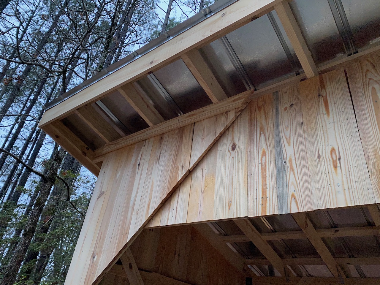

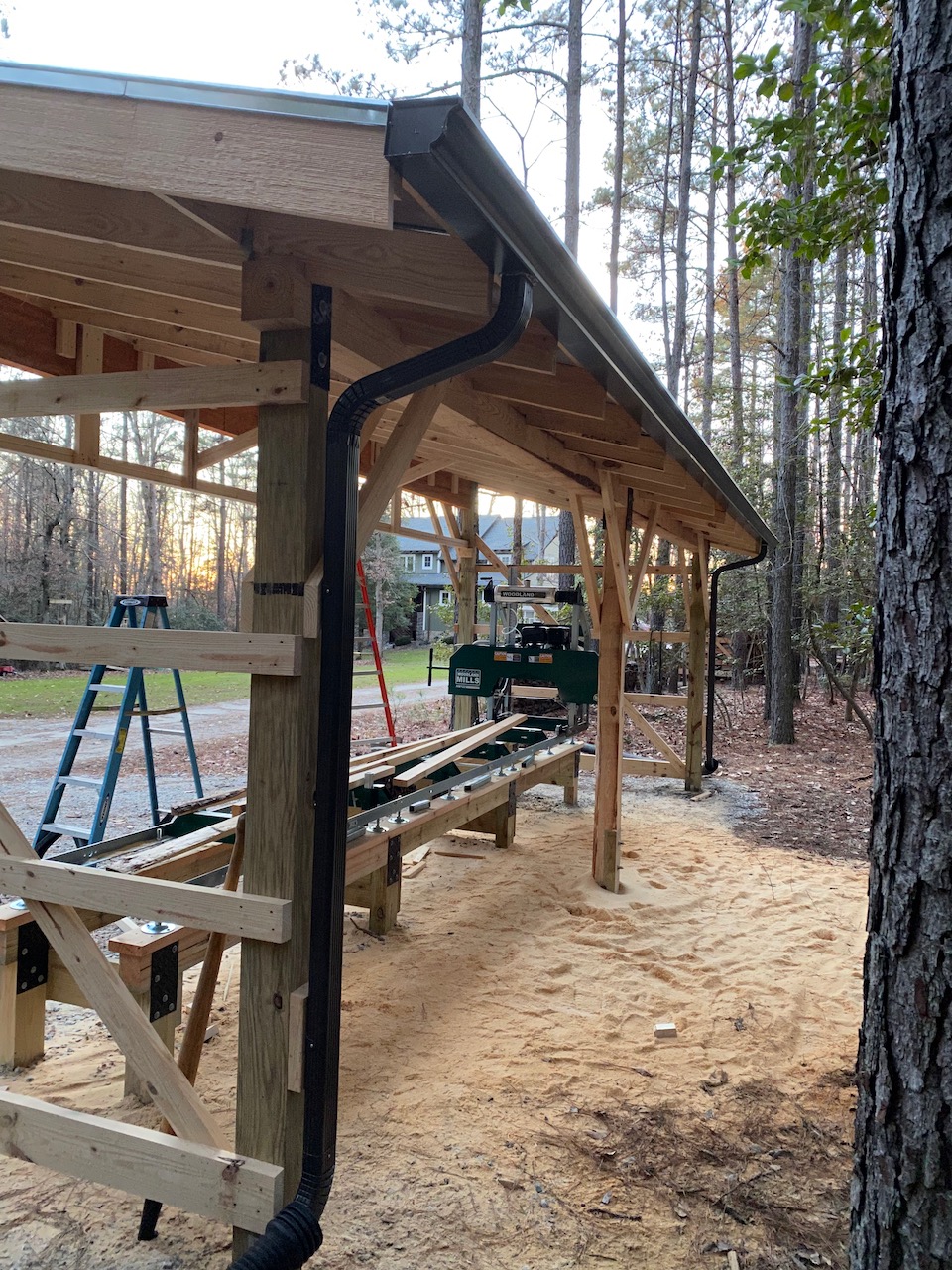

Got a gutter on the rear edge of the roof earlier this week. I had planned for one downspout, but after doing the math for the roof area, I went back and bought a second downspout.
We're forecasted to get rain for the next 4 days, so I'll get to see how this works out.

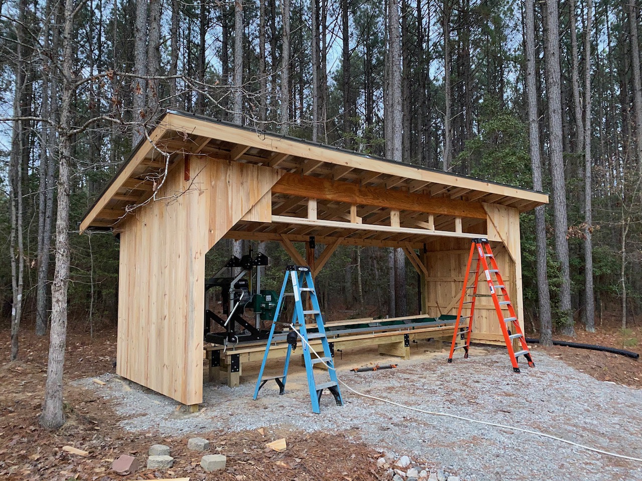

Yesterday I framed up the front upper wall and installed blocking in various spots so that I could put siding up.
I got a start on the siding this morning, and got everything done except the center section of the front wall. I hope to get that finished between rain storms over the next couple days, then need to put battens on all the joints.
I nailed all the siding boards to the wall girts with 2.5" ring shank siding nails placed directly in the center of the board's width, to allow the edges to float as the wood shrinks. When I remembered, I oriented the grain so the board should crown instead of cup. The battens will do the final job of holding down the edges. I may use my framing nailer with 10D 3" ring shank nails for the battens, or maybe hand nail them. Some people also recommend using 3" deck screws. Need to think about the best option. The framing nailer would do a nice quick job but it's awful heavy and could be awkward while handling battens.
On the front wall, I let the siding on the gussets float above the center section. Joints were lined up above and below that character line, so the battens will also line up. I think this will give a nice look in the front, as opposed to having the siding all in the same plane.

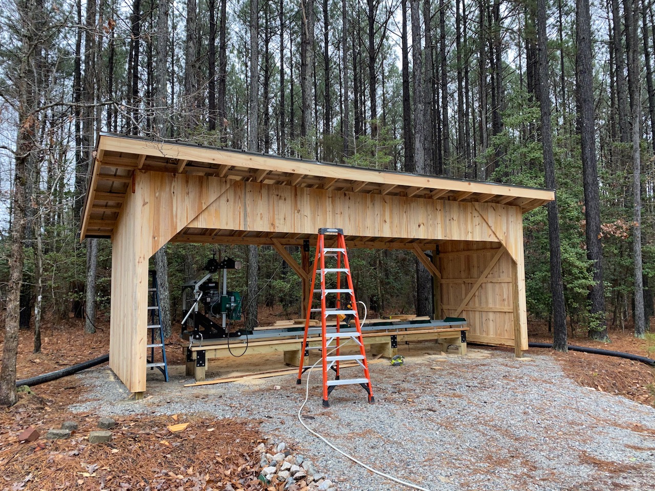

Between rain showers, I finished up the front siding, made caps to protect the exposed ends of the LVL, and started putting trim on the top edge of the siding. The switch on my portable tablesaw died, then it started raining again, so I didn't finish trim or get to any battens. I figure the battens need to be cut and put up immediately, otherwise they'll twist and curl. So I'll wait until we have a dry day and I can make progress.

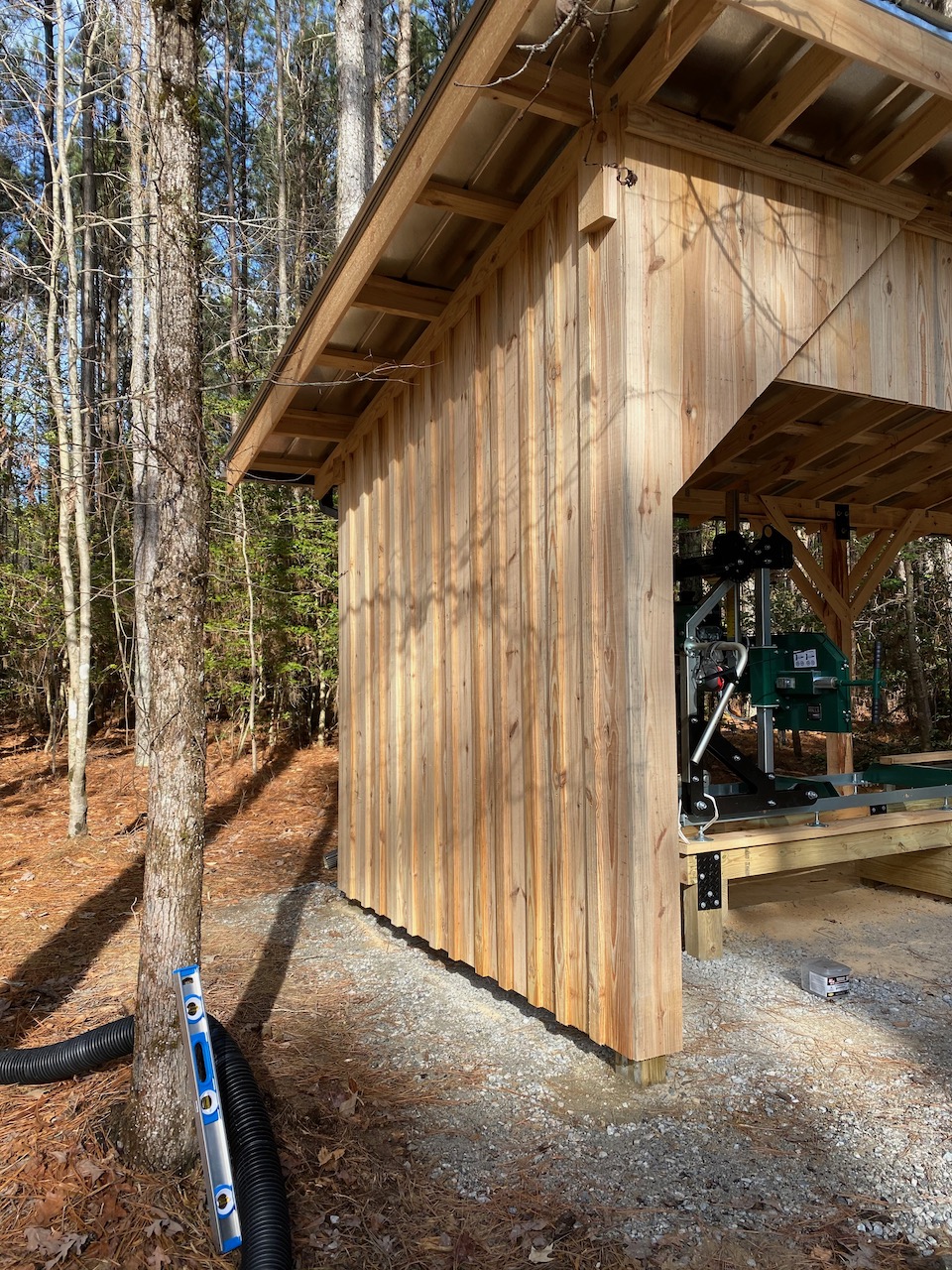

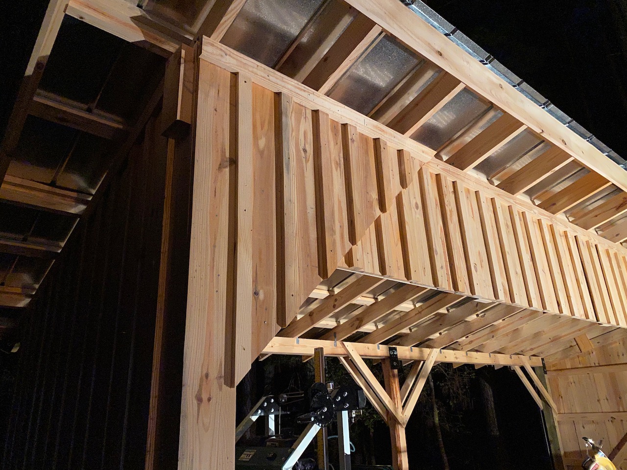

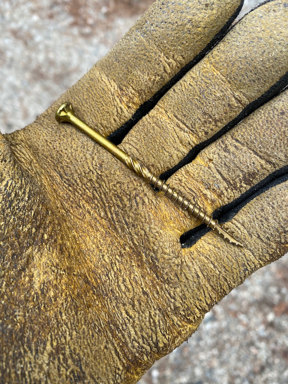

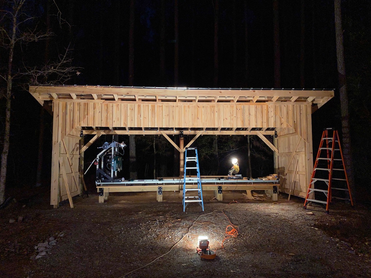

Got all the battens on today and had to work past sunset to finish up the front. Rain is coming tomorrow, and I was so close to finishing it would have been a shame to put away all my tools with just a dozen battens remaining to put on. So I broke out the spotlights and kept going until about 7pm. Looks real good.
I used GRK construction screws to put the battens on, #9 (slightly narrower than a deck screw) 3-1/8" long. Worked out very well and gave me nice control.

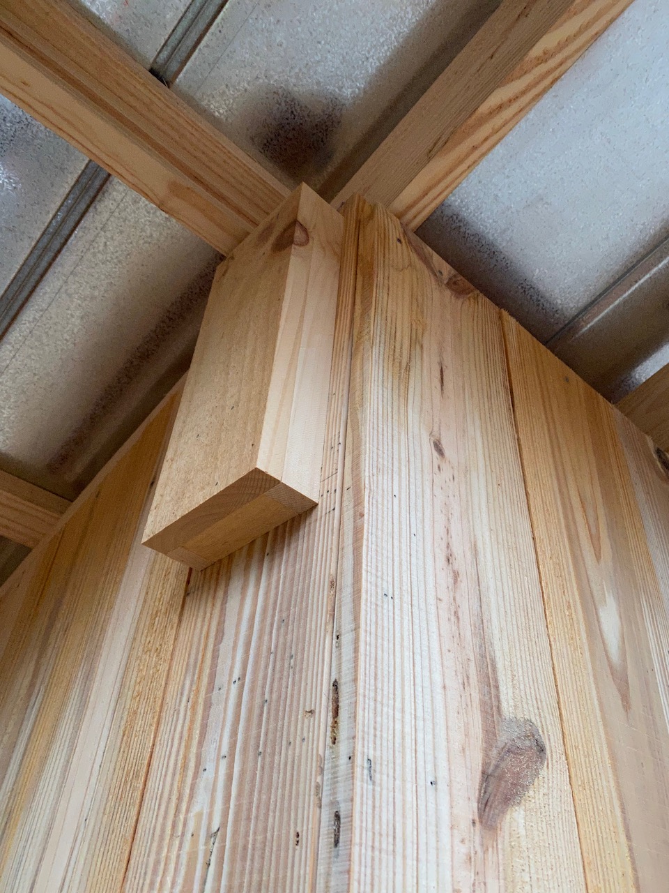

Last thing to do -- I need to figure out how to put on some corner trim that will adapt as the wood shrinks, and not tear apart or gap. I have a few ideas that might work, need to ponder a bit...
/ New Sawmill Shed #73
Make an "L" with two pieces of trim stock with closely spaced fasteners, then mount them on the building with just a few?
/ New Sawmill Shed
#74
Yeah for sure I would pre-fab an L. What I am leaning towards is making the corner trims out of seasoned white pine (have a few boards left over from siding my barn) then attach them with screws that pass through the siding boards. I can either aim the screws through the joint between the corner boards, or I can drill holes through the siding and wallow them out (to make a slot) so those screws don't fight against the siding when it shrinks. I am estimating 1/2" to 5/8" shrinkage for the siding boards in width.
Other option is to do nothing for a few months until most of the shrinkage happens, and deal with the corners afterwards. I have read that most of the shrinking happens in the first 2-3 months.

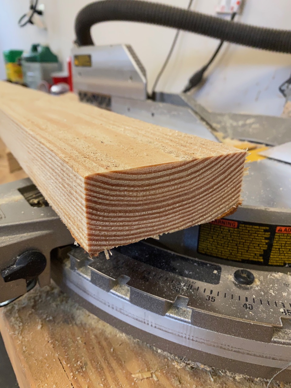

By the way, I cut the battens on the mill yesterday by stacking and clamping 9 boards up against the log stops. The boards were 7" wide and I planned to cut them into three 2-5/16" battens with two passes. The first pass cut nice but the 9 battens spread out like spaghetti. Second pass was even crazier. It was like the Play-doh barbershop with the hair squirting out in all directions.
I had seen a little bit of movement while sawing the boards last week, but the wood really went wild when cut down into battens. These were from logs that had sat a year, and I was told that builds up a lot of stresses in the wood. Sure enough, when I ran out of those battens and cut another dozen from a fresh green log, they stayed completely stable and straight.
Ha. that was my question :)
Looking great, I especially like the over lapping corners up front. Nice, clean and elegant solution.
