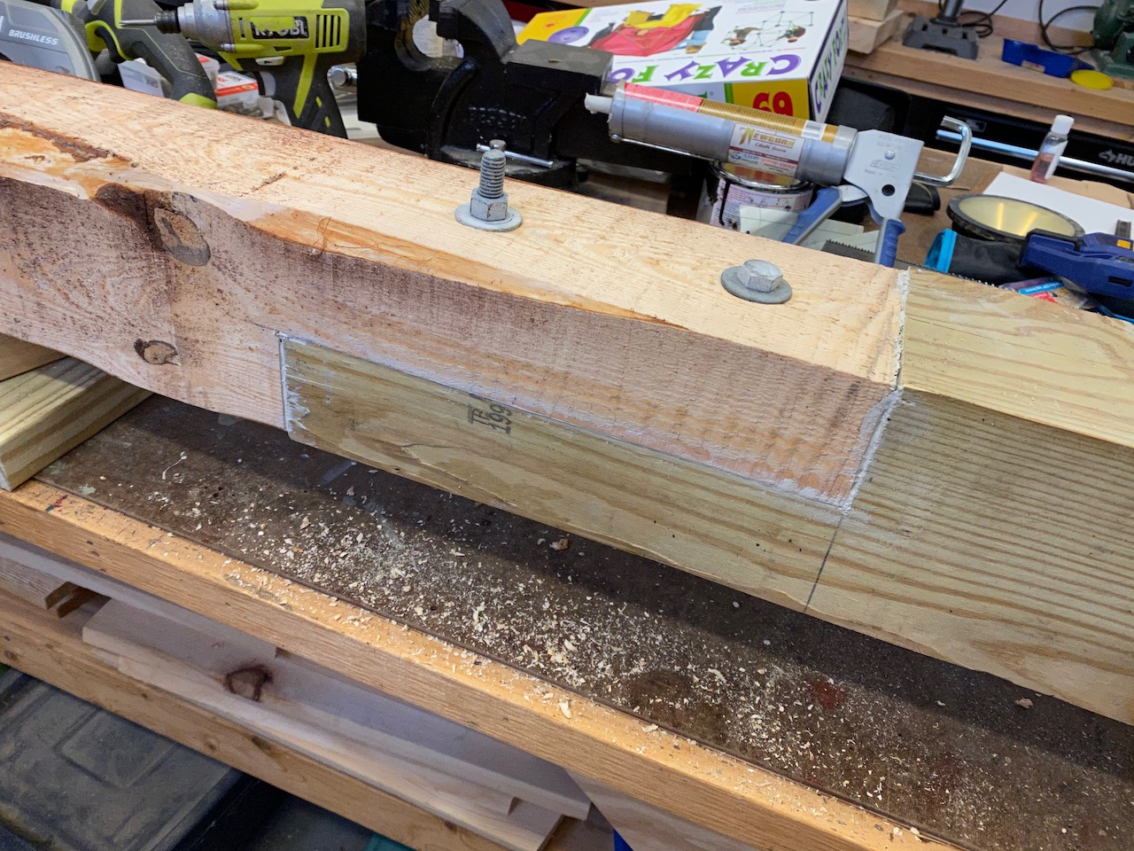

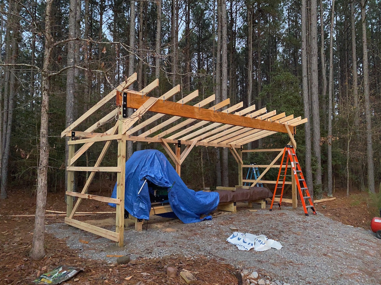

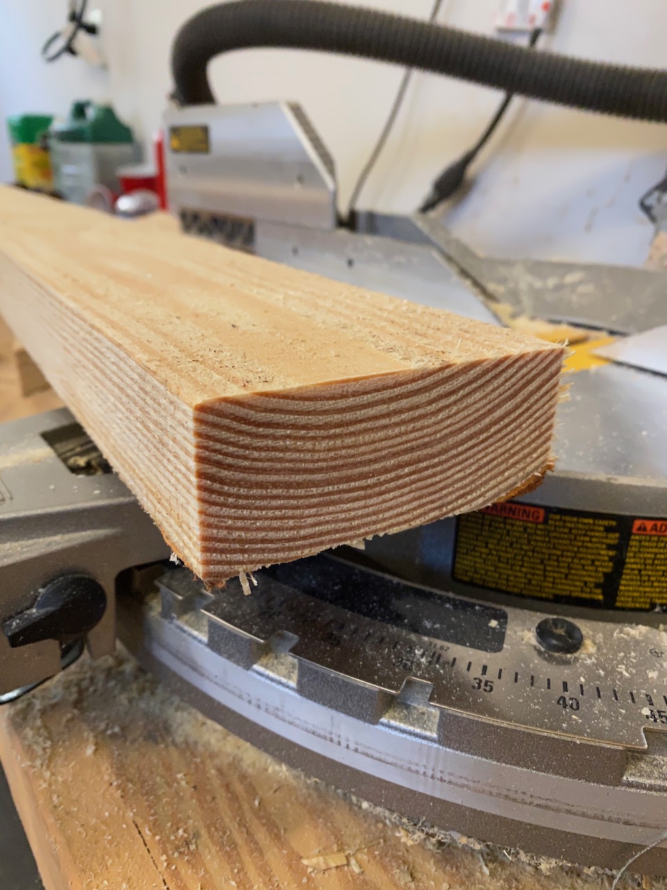

That's a really good price for two of them. Here, they cost $210 each. Shop 1-3/4x11-7/8"-24''' LVL at McCoy'''s
Your building is very similar to what I want to do for hay storage. I want a 24 foot opening and the best price I've seen is for a glulam at $270 Shop 3-1/8x14-24''' Glulam at McCoy'''s
I'm looking forward to seeing how you do the roof. My plan for my hay shed is to run 2x10 rafters from the back wall, out over the from glulam beam and extend it another 4 feet for a little extra protection from the rain.
I bought mine at local Home Depot, actually the one closest does not carry it but the one in Manassas does. Based on the pieces they have, it seems you can have it cut to size, too. It was only about hundred bucks, I was really surprised.
https://www.homedepot.com/p/11-7-8-...ine-Laminated-Veneer-Lumber-2100150/205301927

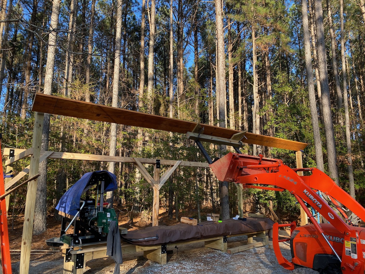

1 and 2 for me only, but thats plenty of reason. Covering with tarp gets old fast.

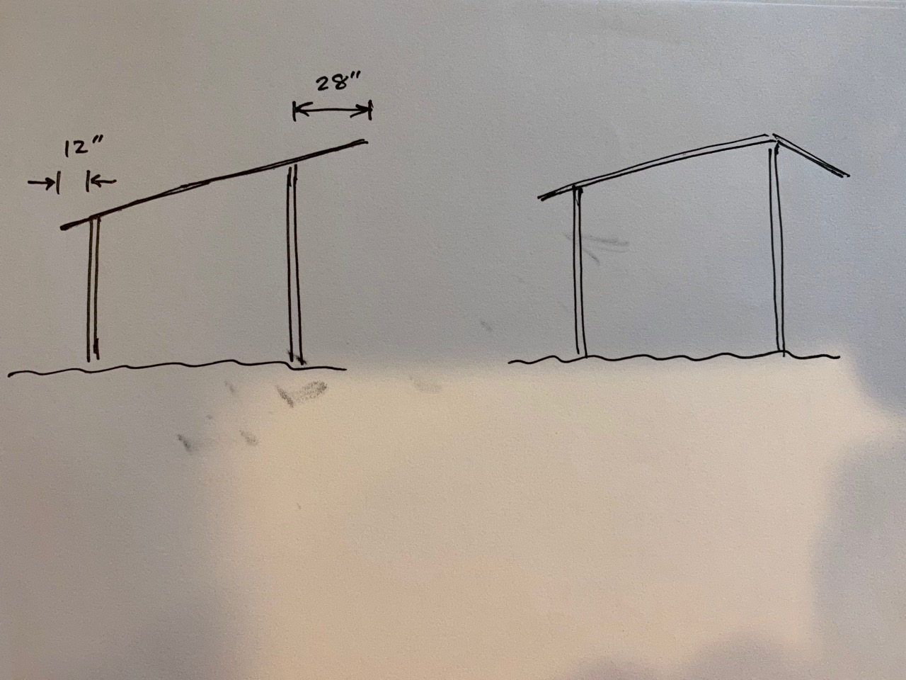

The LVL beams are interesting. Spanning 19 feet is something I need for a project I知 thinking about.
I do have to include snow loads into account for a span that far though.
If I had the overhead room, i would build a truss from 2x4s but the existing structure was my limit. We got some snow in VA, but never too bad or lasting too long.
/ New Sawmill Shed #30

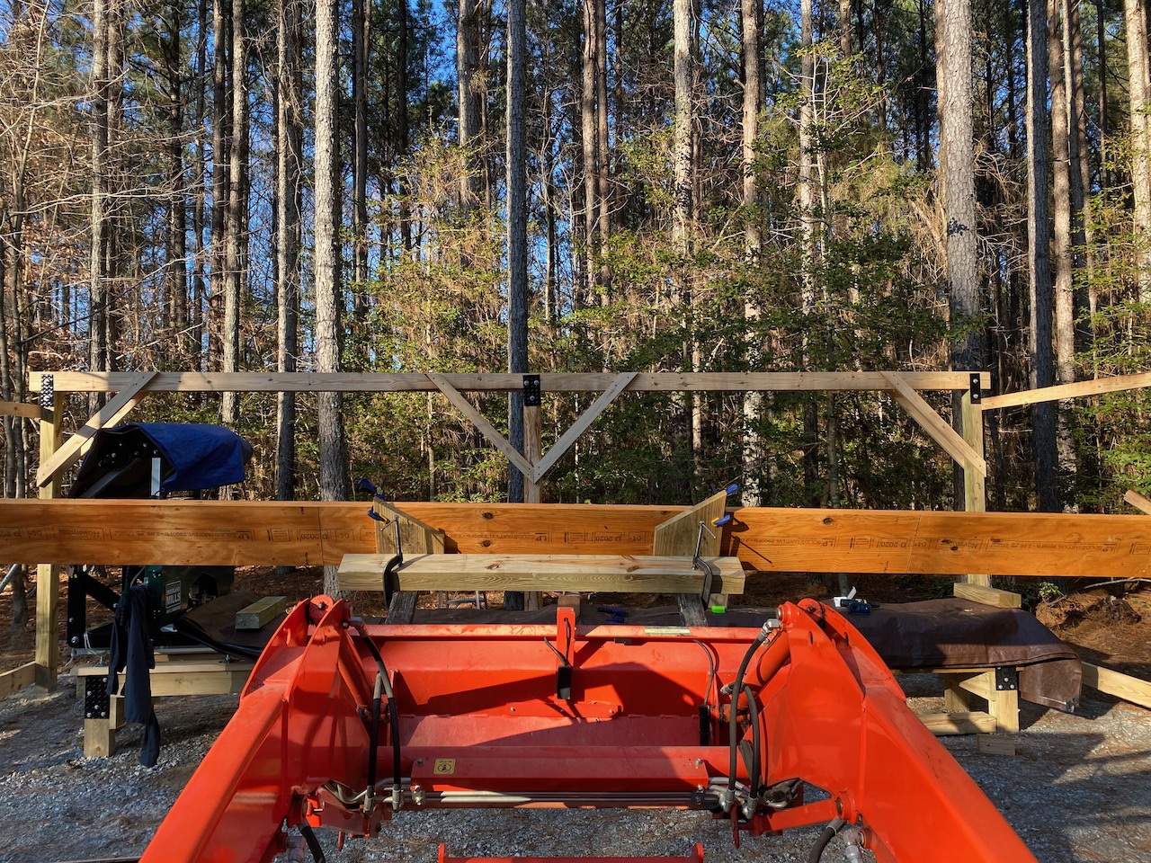

The front beam was originally going to be rough sawn pine, 6x14 by 25' long, to go the full 24' span between the front posts. I went as far as cruising my timber and picking the tree I would fell to make the beam, plan the skid route, etc. Then I did some math and realized that the beam would weigh almost 800 pounds when fresh cut. I didn't like the idea of lifting something that heavy and long with my front loader and I figured it might be impossible to horse it into final position
I have an old barn here (hand hewn, mortise and tenon posts and beams) with one beam 12"x16"x 36 feet that supports a section of the loft. I can't imagine how much effort it took to get that fitted and in place!

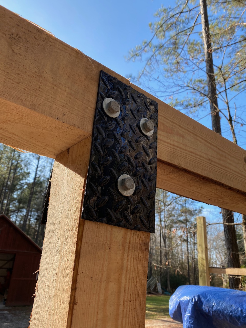

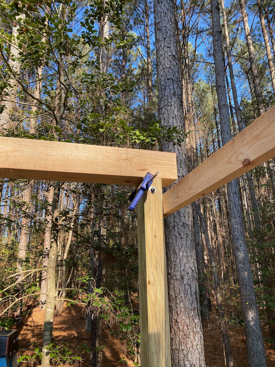

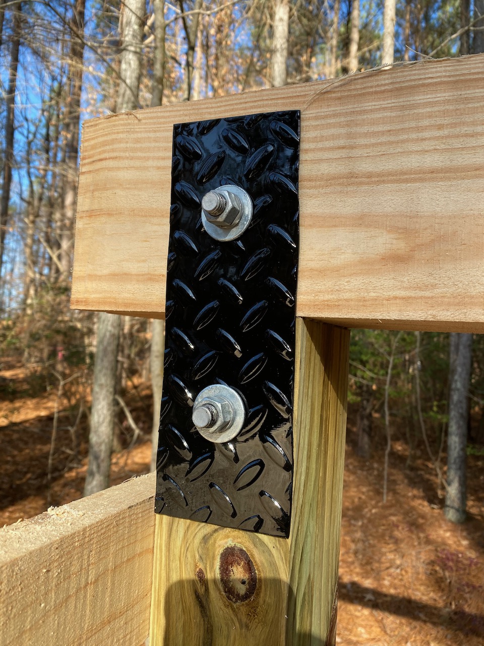

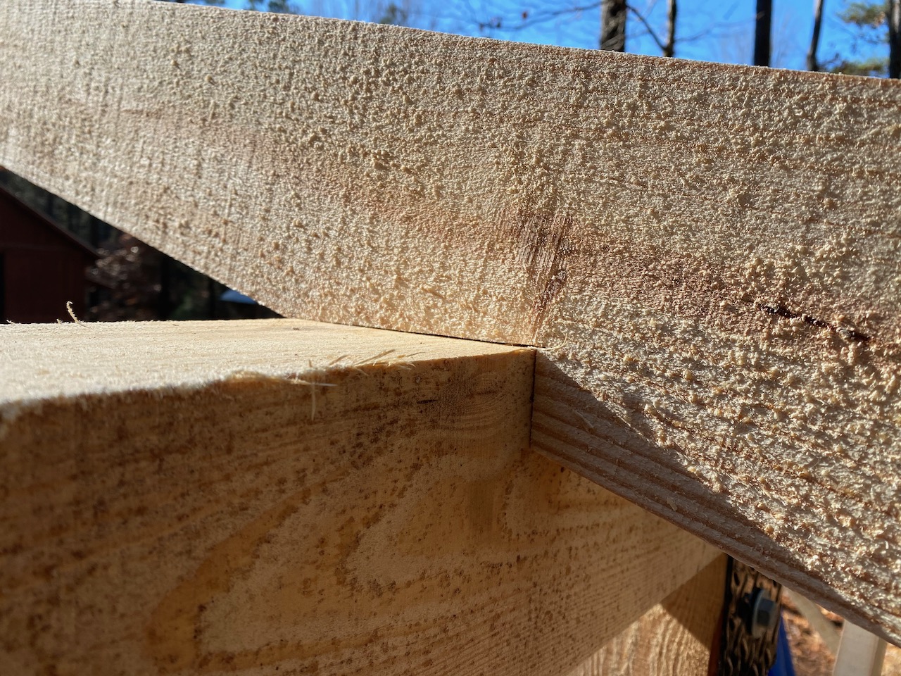

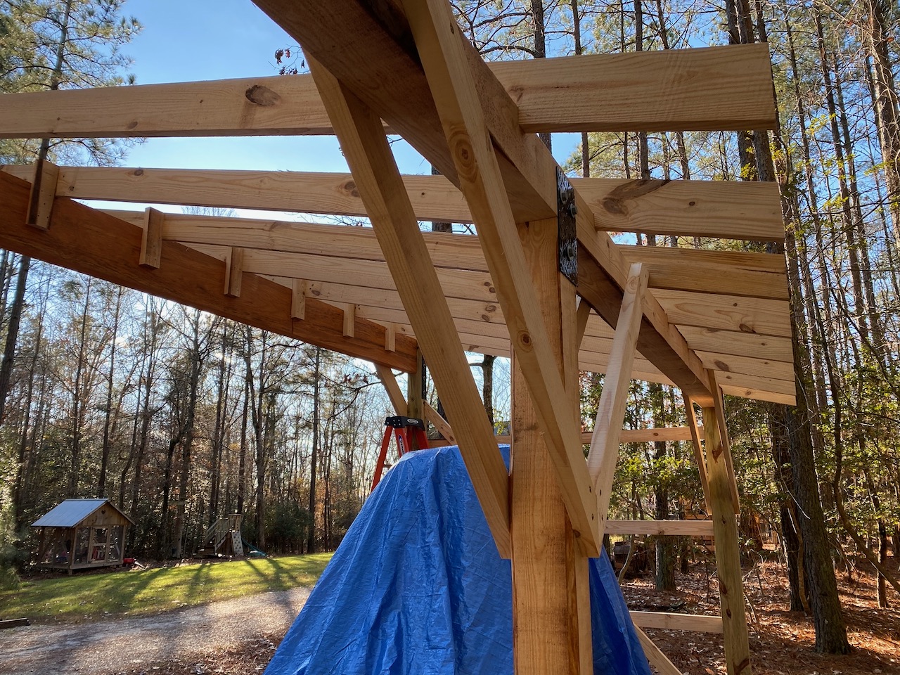

Nothing happened yesterday while we got pounded by a Nor'Easter, but I was back out early this morning getting the rafters up. The tail end of the storm was rain that froze overnight, so everything had a thin glaze of ice but it burned off by about 10am.
Got a real nice precision fit on all the birdsmouth cuts, although since this is green lumber I bet they won't look that nice for long.
This fresh sawn SYP lumber is very nice, most has very tight grain and is nice to work with. That's a 2x4 in the photo below. Smells great too. Only problem is sap everywhere. Will need to figure out how to wash it off my clothes at some point.
Tomorrow will be the roof purlins, fly rafters, fascia, and drip edge, then I'll be ready to start putting up the metal.
