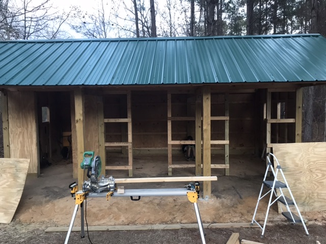

Just an update - thank you to everyone for the insight. Roof is on, still chugging away at the rest of the barn. I'll post plenty of pictures in the next week!
Anyways, here's what I ended up doing for the roof:
2x6 Rafters 24" OC
5/8 Plywood
Synthetic roofing felt (Black plastic roll, don't know what brand), stapled to plywood
Galvalume from local metal roofing supplier.
I added a ridge vent and some rake trim, it looks great. Very happy with the extra money for the 5/8 plywood...made all the roof-work a lot safer IMO.
