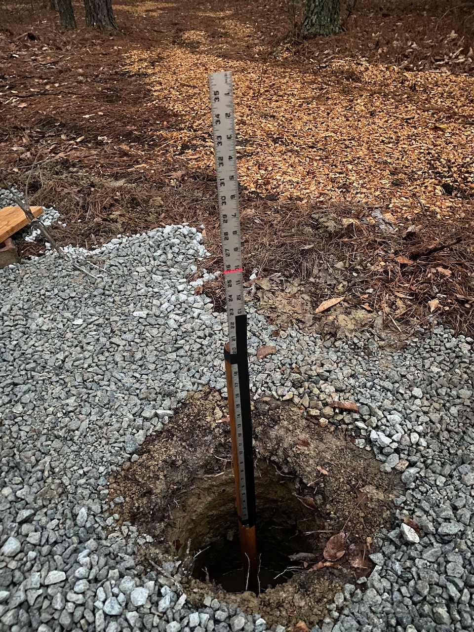

The reason I do not like crushed rock inside a hole with a post is that it gives water a place to go to. Virgin soil around the hole is harder and then inside the hole. By creating gaps inside the hole with rocks, you provide a place for water to gravitate to, and remain for extended periods of time. If there was no rock in the hole, no water would go into the hole.
I agree with you on this. My theory is that at least with crushed rock the water can also percolate back into the soil. When there is cement around the post it's like setting a post into a bucket of water.
I got the idea form the power company's around here. They set power poles into the holes with crushed rock. I said if it was good enough for them it was good enough for me. And I really like the self tightening properties of crushed rock.
/ Timber Frame Carport Project #22
For drainage to work their has to be a path for water to drain. Putting gravel in a hole is just like putting gravel in a bucket. The water just sits there with or without the gravel. But if you fill that bucket with concrete, or compacted soil, then water does not go into the bucket. The gravel just allows the water to remain in a hole longer that it should never have been in there to begin with.
When I auger a hole for a post I end up with an open top cylindrical hole that is similar to a bucket pushed into the ground. But your analogy doesn't work, because my augered hole is only the same as a bucket if the bucket has holes in the sides and bottom. If I auger a hole in the wet season, say 2 feet deep, it will slowly or quickly fill with water up to the level of the water table at the time. If it's the dry season, and the water table is lower than the bottom of the hole, any water that I might put into the hole will run out, either slowly or quickly. The speed the water enters or leaves the hole is determined by the permeability of the surrounding materials, but nothing that I've ever encountered is absolutely impermeable like an intact bucket, not even a really heavy clay.
So I don't see what difference it makes what you backfill the post hole with, concrete, crushed rock, the spoil from the hole, water is still going to come and go depending on the rising and falling water table. Water molecules are really small and they get into everything that is not totally impermeable. You'd think a vehicle's hydraulic braking system would be impermeable, but water still gets in there.
Tell me why I'm wrong about this.

In some parts of the US that have well drained soil, you can use pea gravel (or similar) to backfill the posts and it will help longevity. But here in VA with our clay soil, when you auger a hole in, it is literally like a bucket. It will hold water. Pea gravel won't really help in that case. Concrete (wet or dry mix) will at least "plug" the hole and displace water.
There are parts of my property where I can hit sand about 1-3' down, and those areas never hold water and post holes drain well. But where I am doing this carport, and most other parts of my property, the clay is bad. I have one area to the side of this carport that is wet and muddy, and I am thinking about seeing if I can drill a deep hole with the auger, then go further with my handheld post hole digger to see if I can hit sand. If I could get down to the sand layer then I could fill the hole with #57 gravel and it ought to help drain the area. I know the sand must be 4-5' down or more.

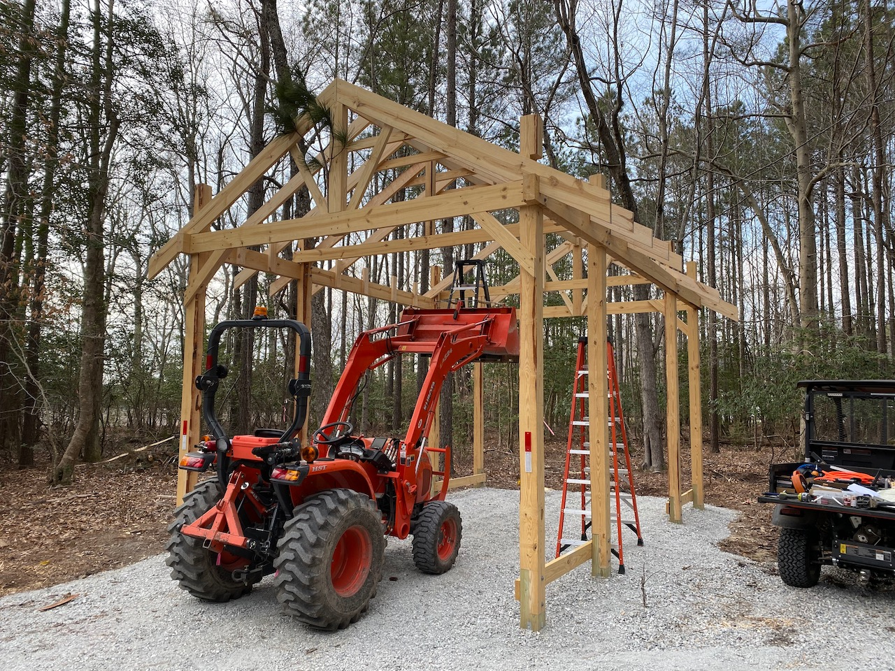

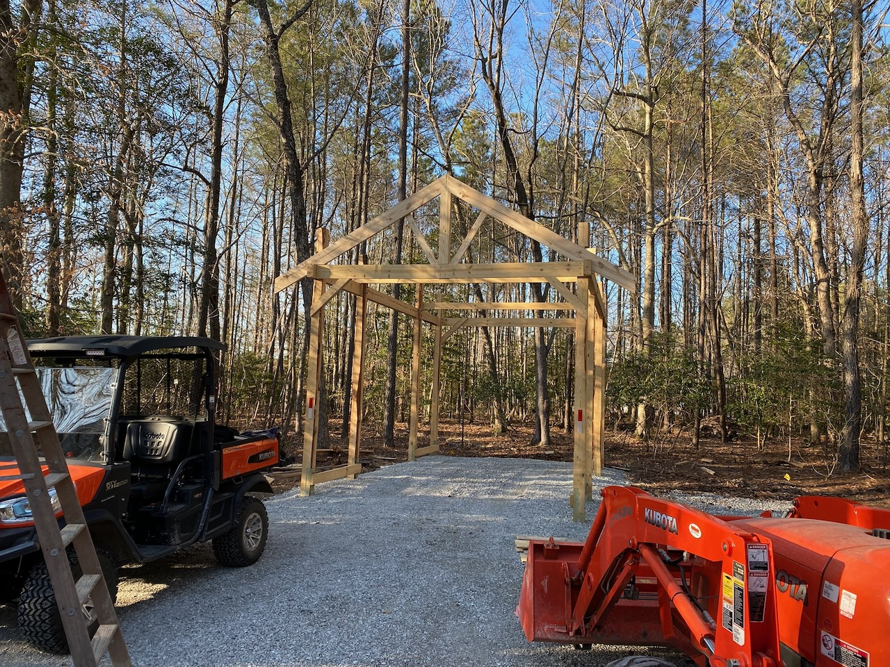

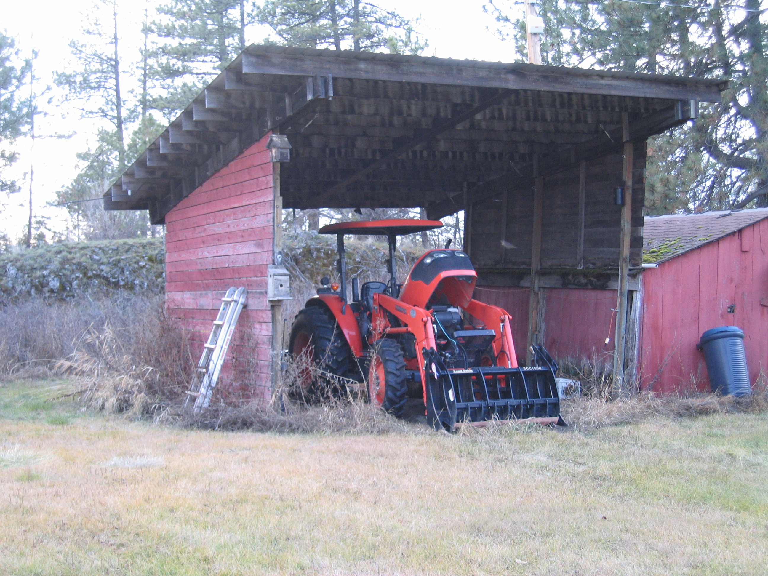

I have two carport structures. One really large and tall for the tractor. One is four stall and "normal" car sized. I used treated 4x4 posts on all of them. So far, after 39 years, only one of the treated posts has required replacement. The remainder are all rock solid. The unique one rotted off right at ground level. Why - who knows. It was replaced eight years ago and is still solid.
I dug each of the holes with a manual post hole clam shell tool. I put a single shovel of gravel in the bottom of each hole. I don't think it made a hill of beans difference. Just made me feel better.
/ Timber Frame Carport Project #27
Very nice, everything I build is timber frame, 30+ yrs of experience. And 6/12 pitch is my favorite, right at the limit for what you can walk/work on. Wish I was closer, I'd help you make some sawdust. :)
/ Timber Frame Carport Project #28
s219, There's special satisfaction cutting you own project. (as you know):thumbsup: Very nice job!

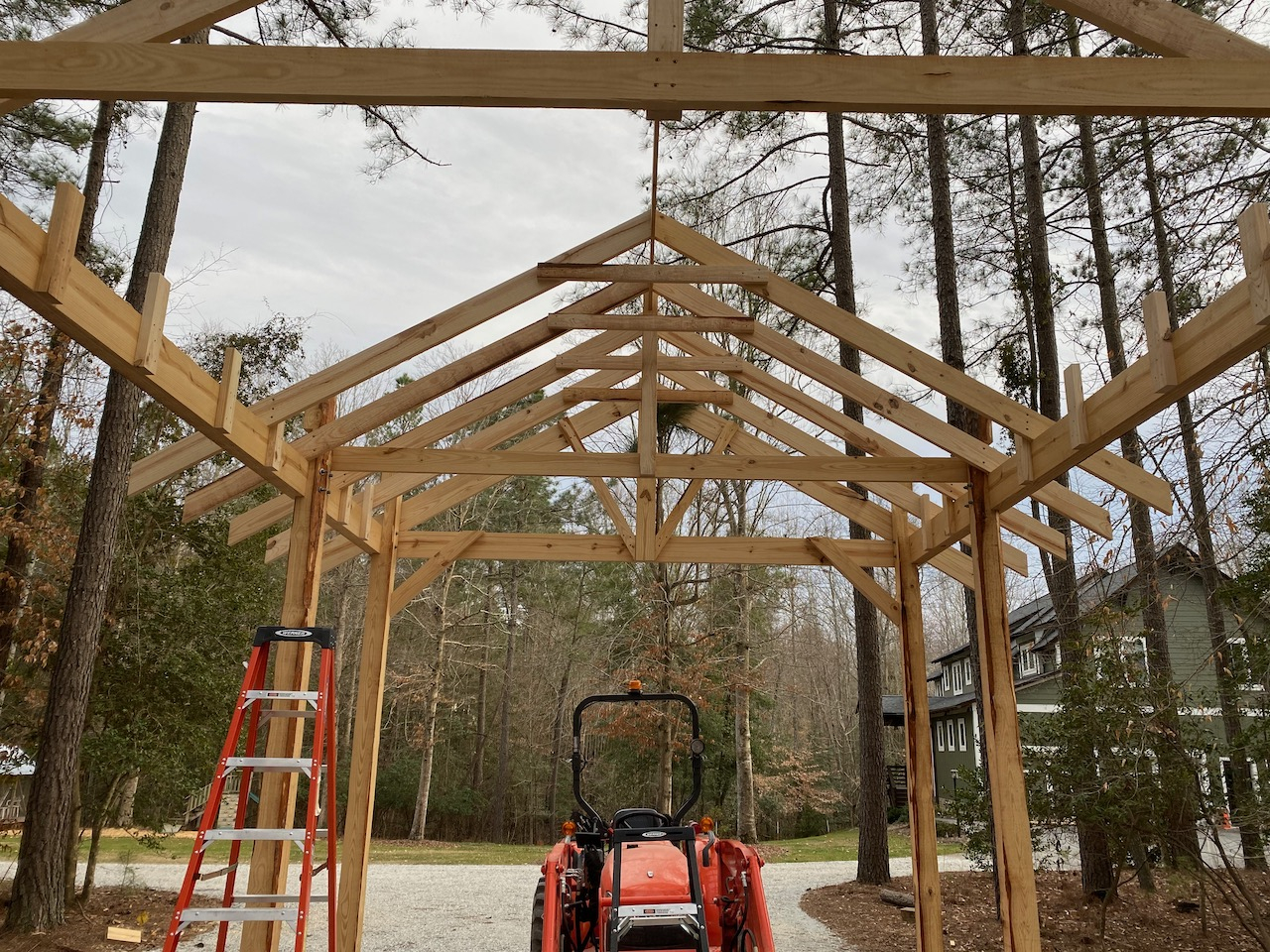

Got the gable rafters cut and put up today. Need to fell some trees to cut a bunch of 2x6 boards for the rest of the rafters.
/ Timber Frame Carport Project #33
Framing is always when a building looks the best!!!!

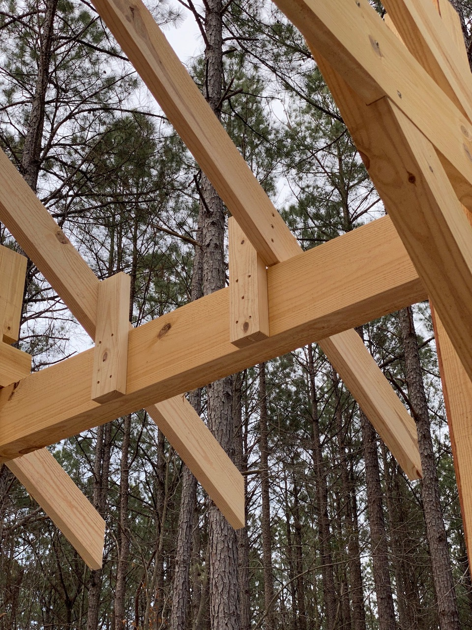

Nice to see rafters bein tied in proper instead of little tin clip.
I always try to use blocking to attach them if possible. Gives a lot more lateral support too, so the rafters won't fold over during the rest of construction when climbing around on the roof. And you don't need the hurricane clips since the nails and the cross nail pattern is good for hundreds of pounds of uplift resistance (but some inspectors will want the clips anyway).
I think the hurricane clips are mainly a safety fix for when rafters are toenailed in, since toenailing has poor uplift resistance and most people butcher it. Simpson spent a lot of money and lobbying to make those clips required by code when the real problem is toenailing.
I don't like to toenail, but do it on some projects when blocking isn't practical (for instance, nailing rafters to top plates in a stick-framed wall). I always toenail with a hammer and pre-drill the rafters to get the angle right. Doing it with a nail gun just makes a mess and usually splits the wood. It's almost worthless.

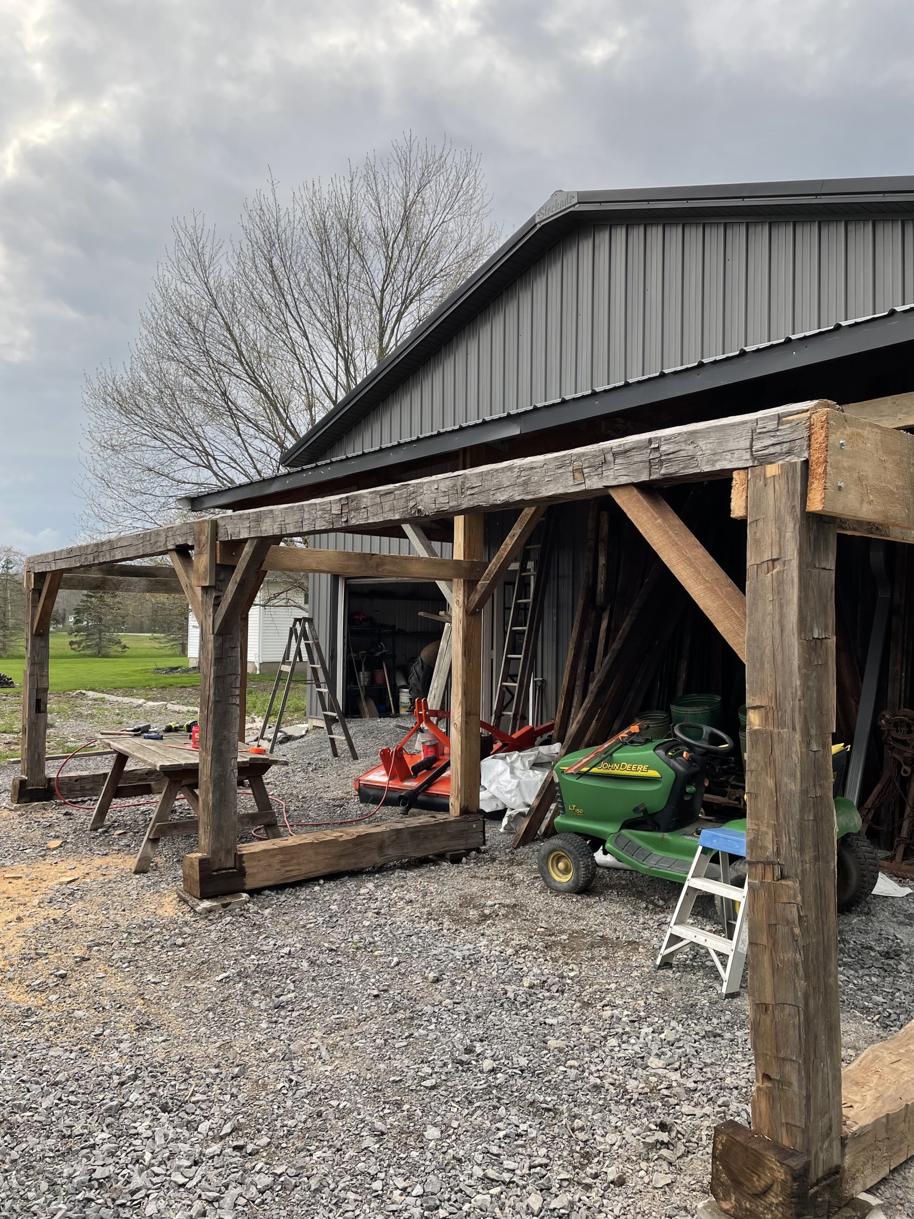

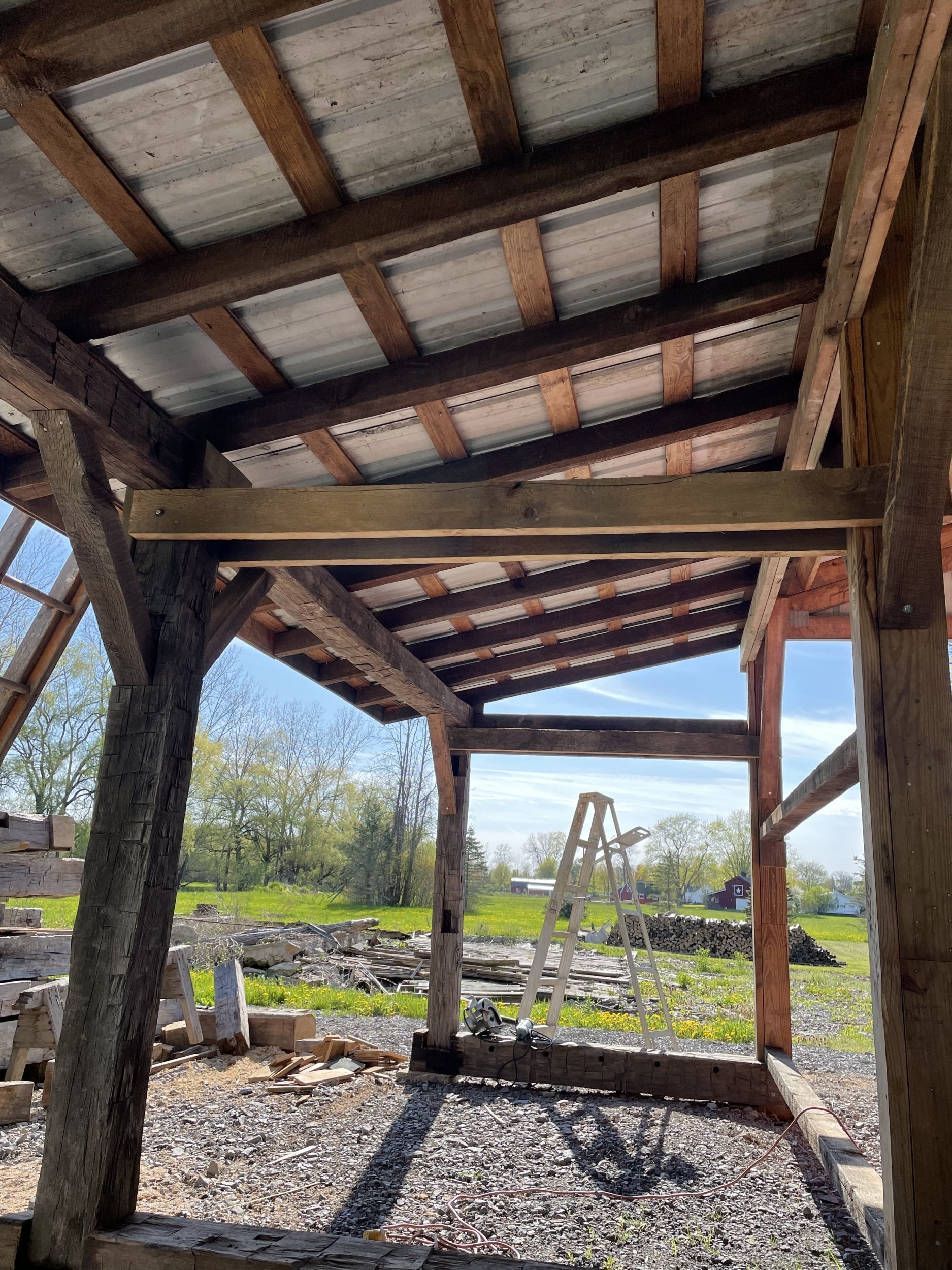

I recently added a timber framed woodshed lean to on the back of my metal pole barn back porch. That back porch was to be my woodshed, but I acquired some more “stuff”, and it seems that you can never have too much inside or covered storage areas.
Covering firewood with tarps outside just wasn’t working out well for me, so I really needed this woodshed. The timber’s that I used were mostly hand-hewn American chestnut from a couple old barns that my great great grandad had built in 1883. I took them down when the roofs and foundations began to fail. Repair costs would have greatly exceeded the cost of the 36 x 50 metal building I put up, with (2) 25 x 10 porches.
On my lean to, I attached 9” square beams to the back porch posts. The porch posts are fabricated from pt 2x6’s and have concrete below grade. I “floated” the other end of those base beams on concrete blocks, set on top of compacted crushed stone (20” deep).
I built the 7 x 25 ft woodshed at a cost of less than $ 20 in materials (bought just some lag bolts and a box of nails from TSC). The steel for the roof was leftover from the pole barn. Stockade buildings shipped the bundles of grey steel for that, each topped with a same gauge sheet of green steel. I made the woodshed as big as I could with that “free” steel roofing. It has a capacity of (24) face cords of firewood, which is (4) years supply at our current burn rate.
The 6” square and 9” square beams, 3x4” sawed white oak rafters, and 3/4”x 3” pine purlins were all recovered from the old barns that I took down.
