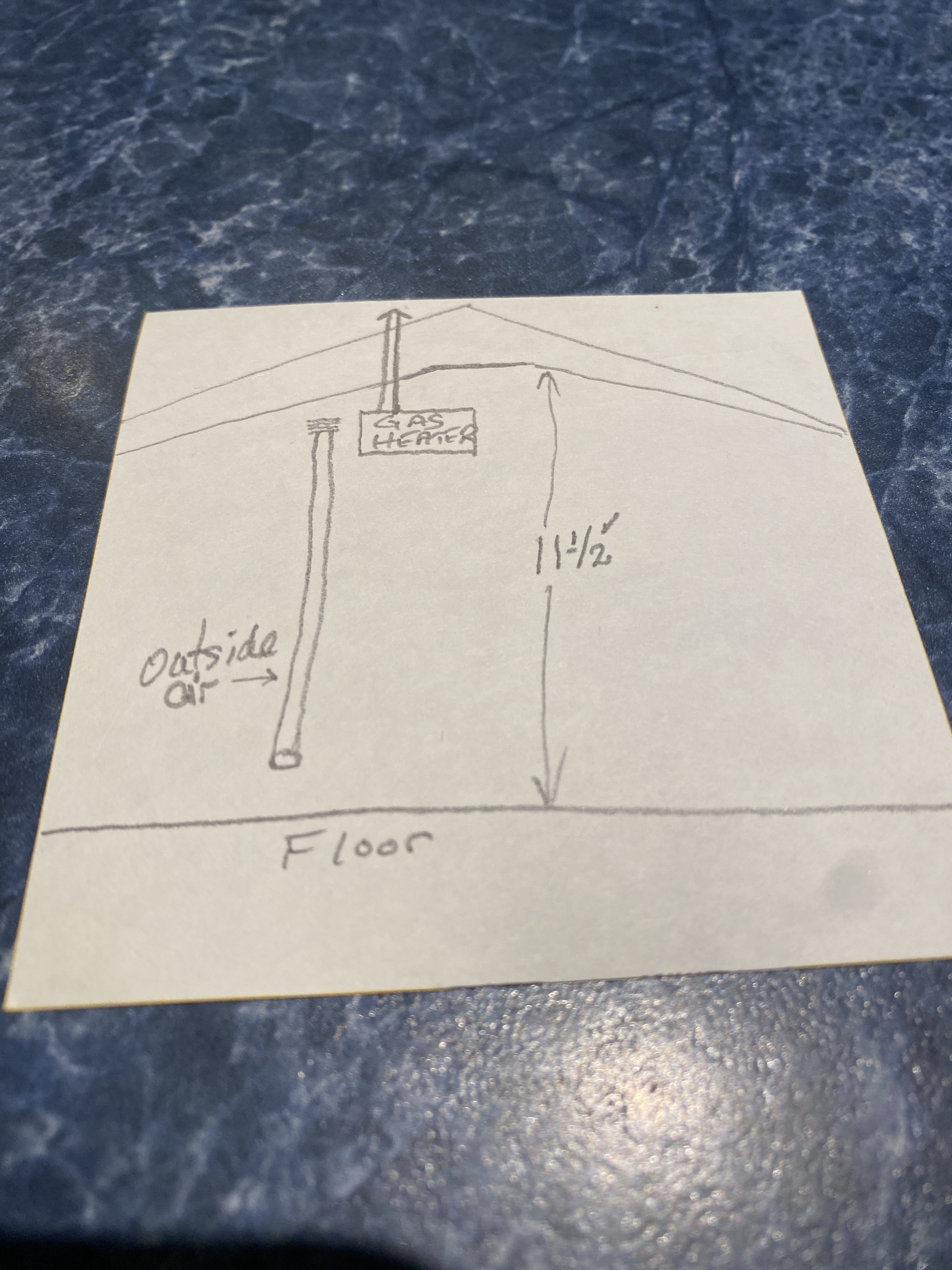

Like yourself, I to would like to know the best way I can provide outside air to my Gas Heater in the shop? I want to add a 4” pipe from floor to ceiling so when Gas Heater is burning, it can pull passive air through the pipe, burn, and out the flue. Wondering if something like this drawing would work?

I should have added, For you, if an outside air source with a flapper vent would pull fresh air for you? Drawing air from a low point, getting it near the combustion?

Like yourself, I to would like to know the best way I can provide outside air to my Gas Heater in the shop? I want to add a 4” pipe from floor to ceiling so when Gas Heater is burning, it can pull passive air through the pipe, burn, and out the flue. Wondering if something like this drawing would work?View attachment 4692536
if you can find an install manual for the make/model number of your heater and it will tell you what they think proper venting and air intake should be.
Also since you be from B.C. your local code will also have some spec's that will need to be met. I understand B.C. reg's are very strick.
just a few weeks ago i upgraded my gas shop heater (same size just newer) and needed to replace its air intake and chimney to meet code and pass inspection. Without my insurance would not have been valid and here we are not as fussy as B.C. is.
