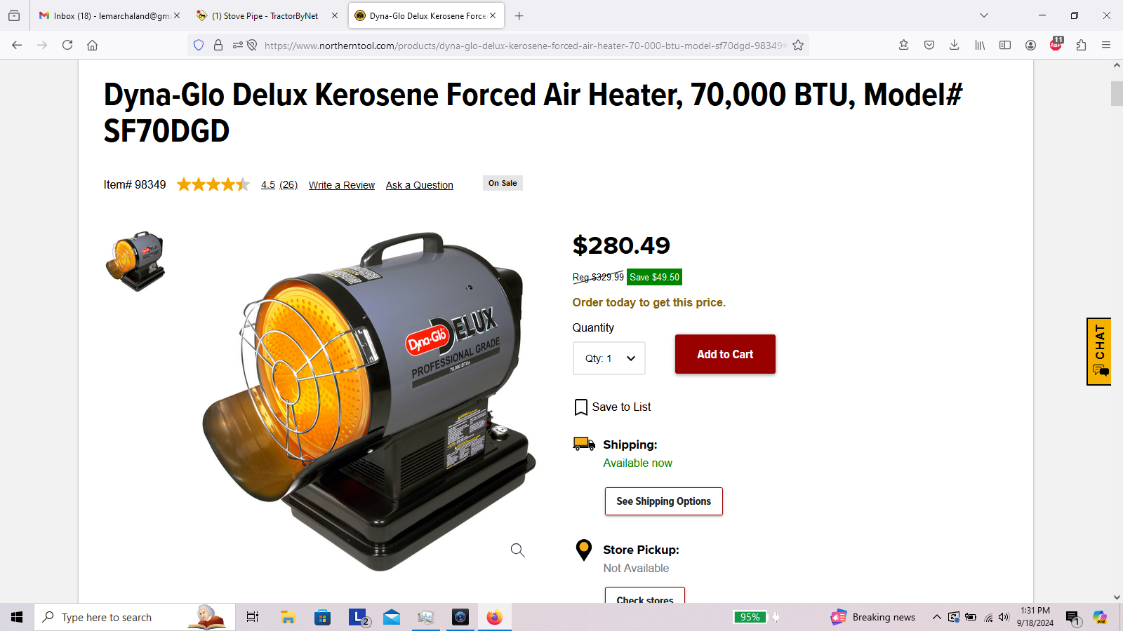

There is much that I have learned from this thread and from my own research. For example, it never dawned on me that burring a kerosene or diesel heater would be the cause of so much condensation. After doing some pondering and discussing the issue with SWMBO, we have decided to go in an entirely different direction.
This year, since I wont actually be home much, I will use the kerosene heater when I need to work out there. The things that I'm afraid will be damaged due to the cold, we will move into one of the room with electric heat.
Once we have the funds saved up (I hate credit) we will purchase a large natural gas shop heater. I am hoping to install this by this time next year. At $1800, it is not something I can run out and purchase right now. Once we get the heater, we will plumb in the natural gas line. My house is pretty close to the shop where the gas line enters the house. It's about 30ft. That will be another expense as I have limited experience with installing gas lines and do not have the tooling to do it. I can however, dig the trench.
Once the natural gas heater is up and running, we will then shift our focus to insulation. Right now, the shop has a little insulation, if you can call it that. Its that thin layer of foam and plastic between the wood supports and the sheet metal. The roof also has this, but its all so thin and barely does anything. Pricing out insulation these days is mind boggling expensive! So, this will be done in sections when I can afford it, until the job is done.
We think that doing it this way, spending the money on something that we don't have to fuel, clean, worry about, etc is the way to go. It's expensive, but offers peace of mind.
I thank you all for the advise. You honestly saved me from doing something I'd later regret. This forum is amazing! I've learned so much here. Thank you all again!!
