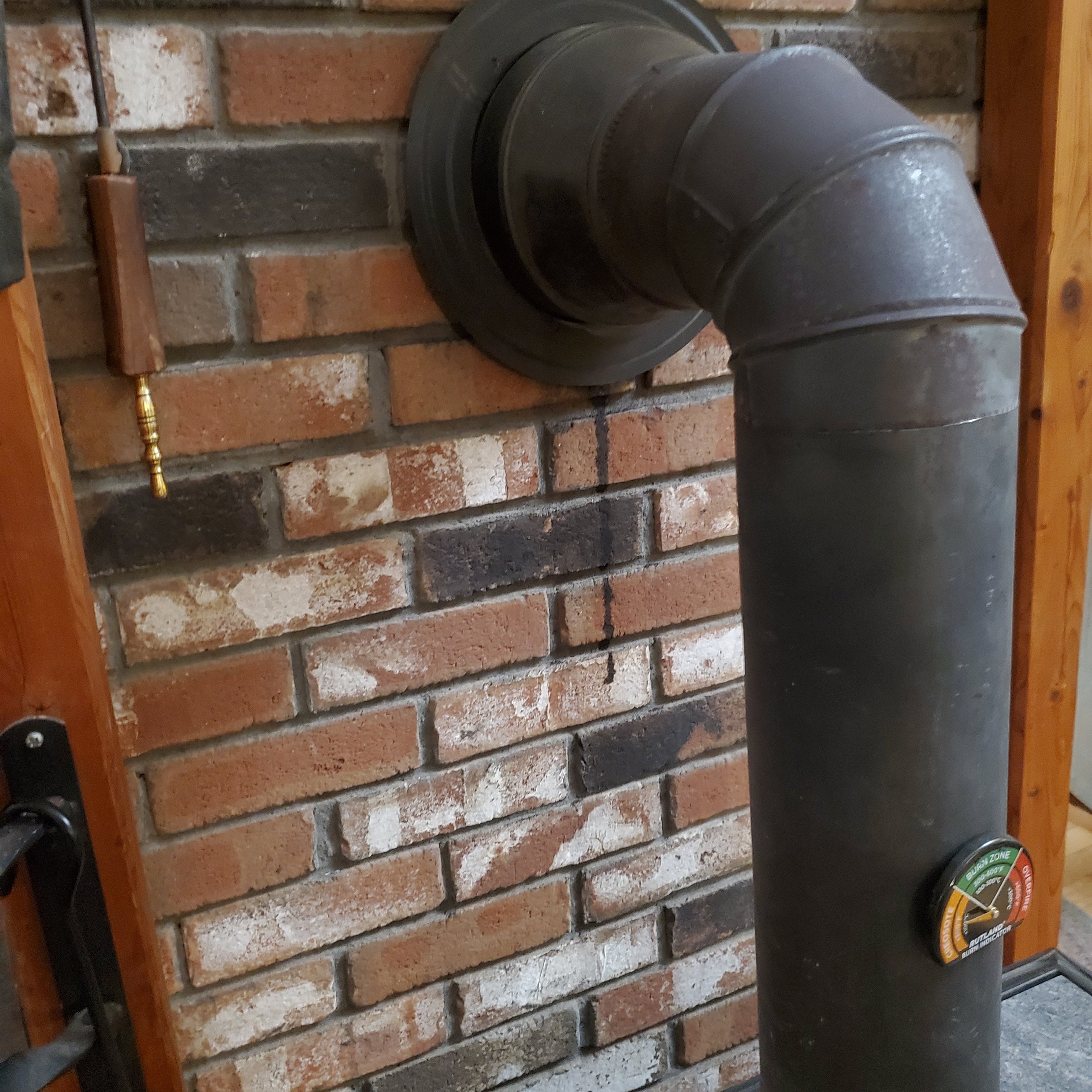

On the Duravent DVL double wall pipe I am in the process of installing the female end points towards the stove. And regardless, if you have creosote liquifying with enough volume to actually run out the bottom of the pipe you are doing something way more wrong than having your pipes in the wrong orientation. Larry said it best above...
Tell me about that "wrongness" when it's 30 below, and the stove is running with all it's got just to keep the wife happy.
This was from two winters past, a cold snap...
/ Wood stove pipe size VS draft #38
Ouch!
Do you feel like your wood was seasoned adequate? Also maybe it has something with the horizontal section of pipe. The creosote that does accumulate runs to the bottom. Not sure.
