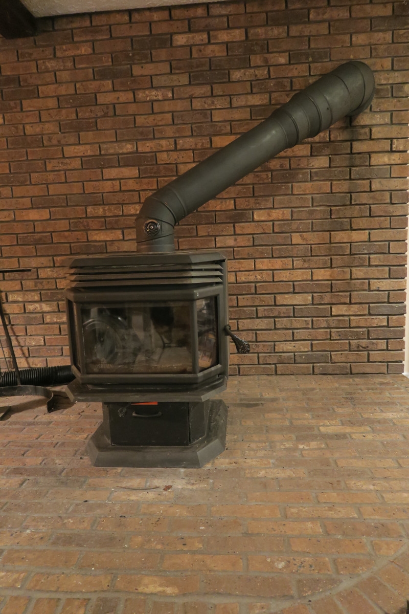

My BIL and I were talking over Thanksgiving about him replacing his wood stove. They have an A frame house with a too big wood stove and an 8" pipe. It goes up 3 sections then through ~6' of double wall stainless and then through the roof. So a new stove will be a 6" flue. What is normally done to have a proper draft? Pull the whole works and run the 6" all the way up or if it is reduced @ the double wall or?
/ Wood stove pipe size VS draft #2
The "right" way to do it would be to change it all out to 6". However, I have a small wood stove with a 6" connection that I then adapt to 8" and it goes into an even larger masonry chimney and it works fine.

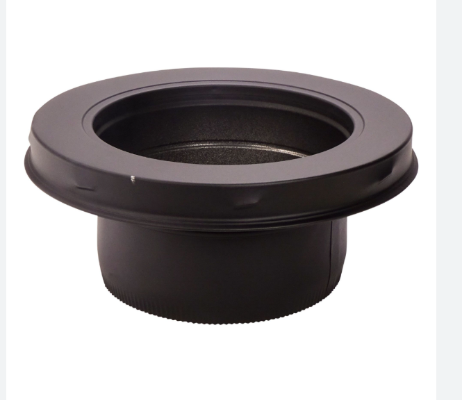

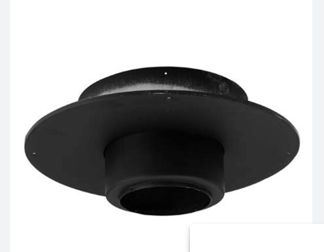

Hopefully if the flue is supposed to be 6" all the way up, it will be easy to deal with the roof flashing.
/ Wood stove pipe size VS draft #9
I would lower the new 6'' pipe inside the 8'' put a finishing plate to seal it all... this plate goes in the 8'' and the 6'' goes through no changes needed on the roof...
or this

I'd keep the "too big" stove and just make smaller fires or be hot. Adding some thermal mass somehow might help the hot/cold of a big stove. I had a big stove in my cabin in Oregon (years ago). It was perfect at full chooch when it was -10 outside. But you had to keep the fires small and short if you just wanted to take the chill down a knotch on a rainy morning. I put a bunch of brick around it for thermal mass. I prefer more short hot fires rather than a constant slow simmering fire. Keeps the chimney clean.
I should make a thread about my stove dilemma as not to derail the OP here.

I would say if you can change it to 6'' all the way up until it penetrates the roof and leave that section 8'' you should do just fine. The thing about oversizing the vent pipe is getting the pipe hot enough to establish a draft. But just a short section through the roof should do just fine
