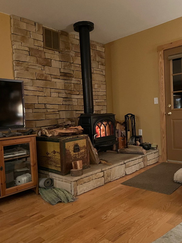

Once the living room is comfortable I have the ceiling fan on gently moving air up and the thermostat set to "fan on" which runs the air handler at slow speed to circulate the heat throughout my small 2-story house. Note the return above the stove.
That is the best solution. If you have a ducted forced air furnace, just run the furnace fan to move the wood stove heat throughout the house. Once I discovered that, I quit using the ceiling fans.

I agree. The objective with running the furnace fan is to distribute the air, not necessarily blow hot air . It takes the excessive heat from the room with the wood stove and moves air throughout the house. In order to work well, you need to program the fan to run at least every 30 minutes for awhile and leave it running 24/7.
