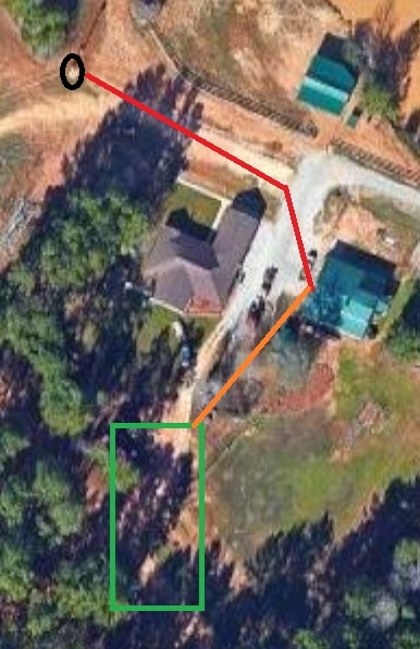

I didn't consider connecting the existing wire with new wire underground. Is that possible? Would I need access to the connection after it's done? Or bury it and forget it?
I just drew this with Paint from Google Maps. It doesn't show the garage addition on my house, but it gives you an idea of how where everything is.
My house is the metal green roof.
The black circle is where my meter is. I have a 1,200 amp breaker box with six 200 amp breakers. I'm using three of them right now, including the one we're talking about.
The red line is approximately where my line is buried for my house.
The orange line is where I plan to bury the line to my Shop. The green box is where I will build my Shop.
The trees behind my mom's house are a great shade barrier for the summer heat and they are staying. The path around the trees, to where the Shop will be built is longer than the entire red and orange run combined. This is the very shortest way to get to the Shop location, and over half of the wire is already in place.

Where do you plan on placing the whole house generator since those wires will also have to have access to the main breaker box.

I believe that what you want is under NEC is a splice rated for direct burial. You could pull the shop wires back from the house to some convenient spot, and cap them with a direct burial rated splice kit. When you are ready, then run a spliced cable back to the shop. If no code, I suppose that you could pull the wire back a bit, bury in a vault to open up when you are ready to run the power to shop. If it were me, in the mean time, I would pull the 200A shop breaker to keep anyone from accidentally powering the buried line up.

If it were me... I'd find a way to terminate the wire outside in either a box on a riser, or in a vault until you get ready to run the new shop wiring. If the breaker is off, there's not much risk in having the wiring underground. When you run the new wire, use an inline splice kit for wet locations, about $40 per conductor.

Put the 200A terminals block or “power terminals” in a buried, cover flush (with ground) mounted “handhole box” outside the wall where the feeder presently enters. Not sure how big the box cover would be (8” x 10”?). Flush cover makes a nice birdbath or flower pot platform. And keeps the terminations accessible like the Code wants.
