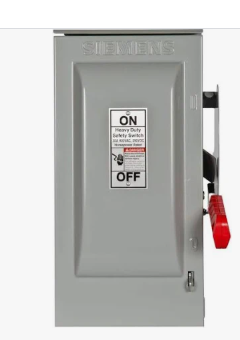

With the 200 amp breaker off at the meter, I'm not worried about just wire nutting it and leaving it in a box. But it seems to me that now is the best time to install what I want to be there forever. My first thought was to install a Disconnect Switch like what I have for my HVAC system. It's only 60 amps, but basically, it's a big heavy duty on off switch. I need one for 200 amps, and that seems to be where I'm having issues.
Lowes has this for $210 which should work. https://www.lowes.com/pd/Square-D-S...e-Outdoor-Enclosed-Circuit-Breaker/5001782473
I can install conduit down the bottom of it so I can run my wire to the Shop in the future. I just don't want to spend over $200 for a switch that has a cover and will be hard to hide once it's installed. I could install it on the outside of the house, but it's right next to my new fancy front door, and it will be ugly and obvious.
My thinking for a disconnect is that it would allow me to turn off the power to the entire shop from inside the house in case of a fire. I don't know any other advantage to having a switch. I don't want a breaker. To me, that just adds to where problems could happen. There is already a 200 amp breaker at the meter, and there will be a 200 amp breaker inside the panel that I'll install in the new Shop.

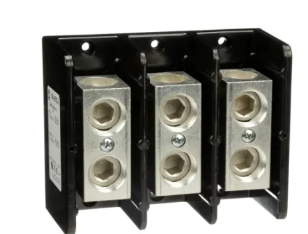

If you just wanted to splice in an enclosure you would want something like this. Just a terminal block.
These are the only disconnects that I'm used to working with. Generally they are fused but you can get them non-fusible. If I'm understanding correctly whatever you get will be in the living room. I would personally go with a breaker or terminal block. With the thought process that they would be easier to hide. Breakers are tried and true, have you had problems with your current panel mains?

I have a 200a manual transfer switch for my PTO generator like the one pictured above. It is a big beastie.

The ON/Off switch that you posted wouldn't work with sheetrock on my interior wall.

Breakers are going to be smaller and less obtrusive than a disconnect. However, I think that a switch requires a label indicating where the upstream breaker is.

Can you remove the panel for use later in your future shop, put a splice block in a small enclosure in its place, and cover it over as you want? That wire TO that panel already has a breaker feeding it somewhere, so that's where you'd kill power to the splice block for now, and the future shop later.
That's what I'm hoping to do. I'll google spice block. That's a new term for me.

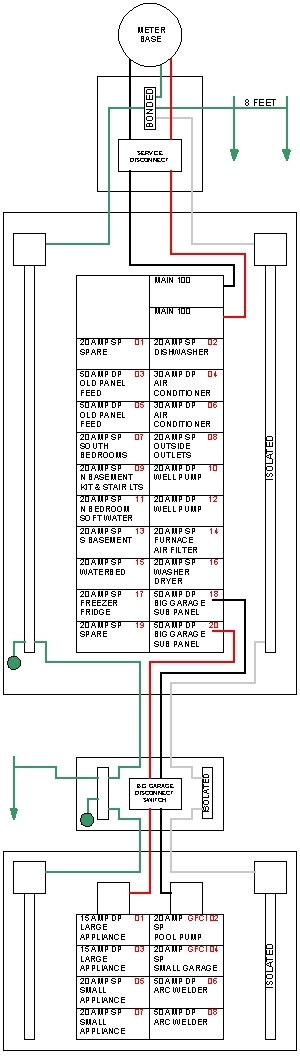

In our current (no pun intended) house, we had an old 100 amp box. I wanted the meter moved to the other corner of the house and the box replaced. So the electrician installed a new meter base and head, and I had him put a disconnect under the meter. That kills everything and that is considered the MAIN panel. Then he fed a new wire from that to a new 100 amp box, which is a sub-panel. I moved all of the appliance circuits to new 20amp breakers from the old box to the new box. Then moved the old meter feed from the old box to a new 50 amp breaker in the new box. That was all goofed up lighting and outlet circuits and outbuildings. Then I could take my time updating the old wiring and eventually remove the old box.
I also installed another 50 amp breaker in the new box to feed a disconnect in the garage that feeds a sub-panel there.
I fed one circuit from the garage sub-panel to a shed.
So I can kill all of the outbuildings and swimming pool from on breaker in the house if needed.
So what you're wanting to do is very similar to what I did, just higher amperage.
