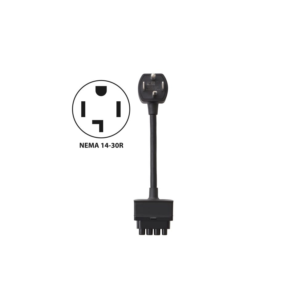

This would suggest that the 30A circuit requires the GM 30A dongle (shortie cord) for the brick to turn down the charge current;
E.g. this shorty cord for her brick;
And of course a new NEMA 14-30 outlet...

Sorry I pulled the wrong part, but you want a 14-30 dongle for reduced current. The ones above look like they just adapts
the plug to your socket, but I do not believe it tells the brick to reduce the charge rate. True?
All the best, Peter

FWIW: The GM "cord dongle / shortie cord/adapter " contains electronic smarts that tell the car to limit the charging via an electronic handshake at power up what the outlet is capable of- it is part of the car charging standards. The yellow ones just adapt prongs, and do not have anything to tell the car that the outlet is less powerful.
All the best,
Peter
/ EV Charging - how to adjust charging amperage? #20
All the best,
Peter
That is for the "old" style Chevy brick. The new ones do not have that configuration. (Closed the page before I was done, fat fingers.)
You have found the correct information the "latest" Chevy charger does allow two currant choices when plugged into a 120 volt circuit using the my Chevy app. However it does not on the 240 volt operation, in that configuration it can and will pull a max of 32 amps.
My wife's is plugged into the welder receptacle in our attached garage, which fortunately is wired adequately to handle the constant current draw of 32 amps.
