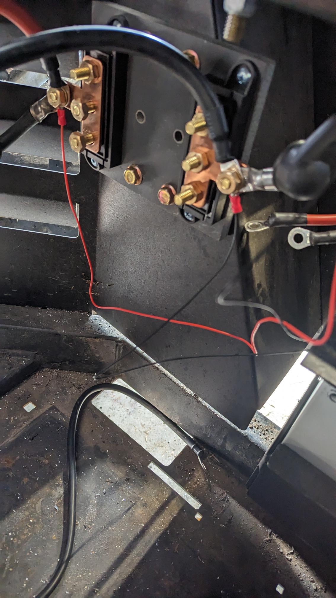

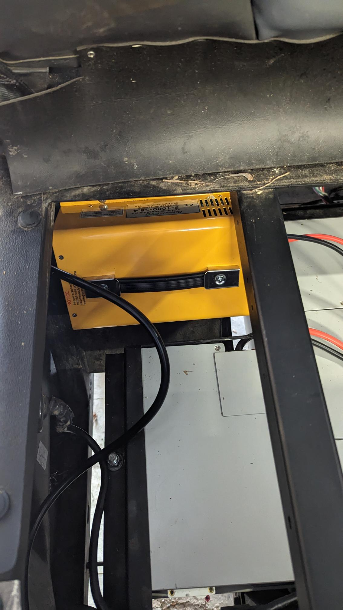

Next I needed to mount the charger and the bus bar, where all batteries connect to. Charger went in on the passenger side, on the rear firewall. This is right next to the stock charger port. I eventually cut the cord for the standard charger, and wired in the new charger.
The bus bar mounted on the driver's side, rear wheel well.

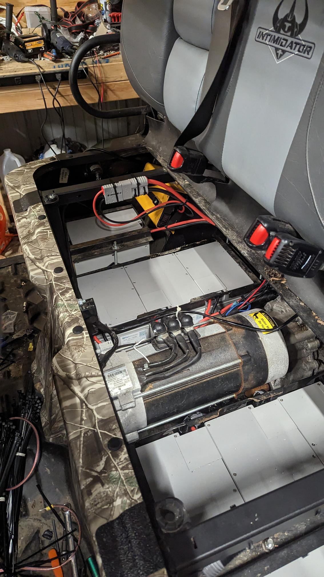

The batteries sit like this: 1 front to back, on the outside, then 3 left to right, stacked next to each other. This is repeated on both sides.
The battery holders needed to be modified slightly, with a little grinding and bending. The 3 batteries are about 3/16" wider than the holder, so I bent the ears a bit. Also, these batteries are connected using a forklift type plugs, on the side, so I had to cut the holders to make room for that, and there is a breaker and display on each battery, again, a little cutting and grinding to make room. The single battery holders just needed to be cut and ground to make room for the connector and breakers.
One of the tricky bits is that the motor is offset towards the driver's side. Through trial and error, I learned I needed to connect the plugs to the batteries before dropping them in. There is also limited space to cleanly wire manage the cables. So protect them, I double or triple loomed the cables. I put 1/4" loom over each cable, then put 3/4" loom over the two cables with loom on them already. Where the cables might rub a sharp area, I added a third loom of 1".

I dropped in the batteries on the passenger side, and that has plenty of room. I still double loomed those, just to be safe. Also mounted the connector for the charger. There is a stock cable that runs from one battery bank to another. That was used to connect the controller to the negative side of the bus bar. The positive side of the bus bar connects to the stock location for the fuse and relay for the controller.

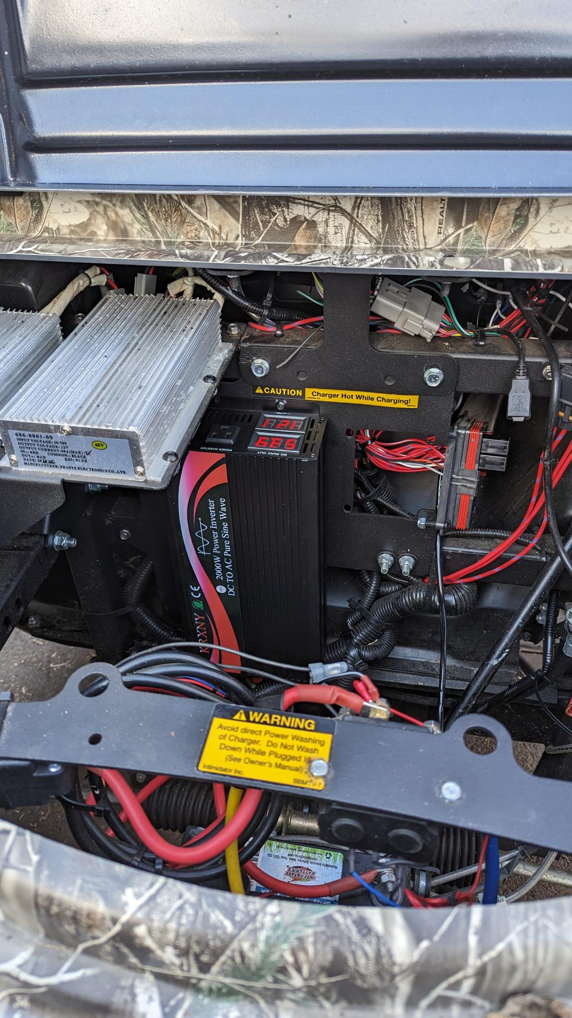

There are three wires that needed to be extended to the bus bar, two for the stock charger (which I replaced with a 2000 watt inverter) and one other for the ground for the onboard 48 to 12 inverters.
Everything was home run to the bus bar and wire managed.
I then removed the stock charger and dropped in the inverter and connected the wires.

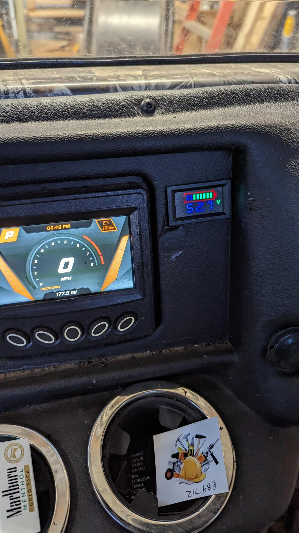

Next I ran the voltmeter to the dash.
