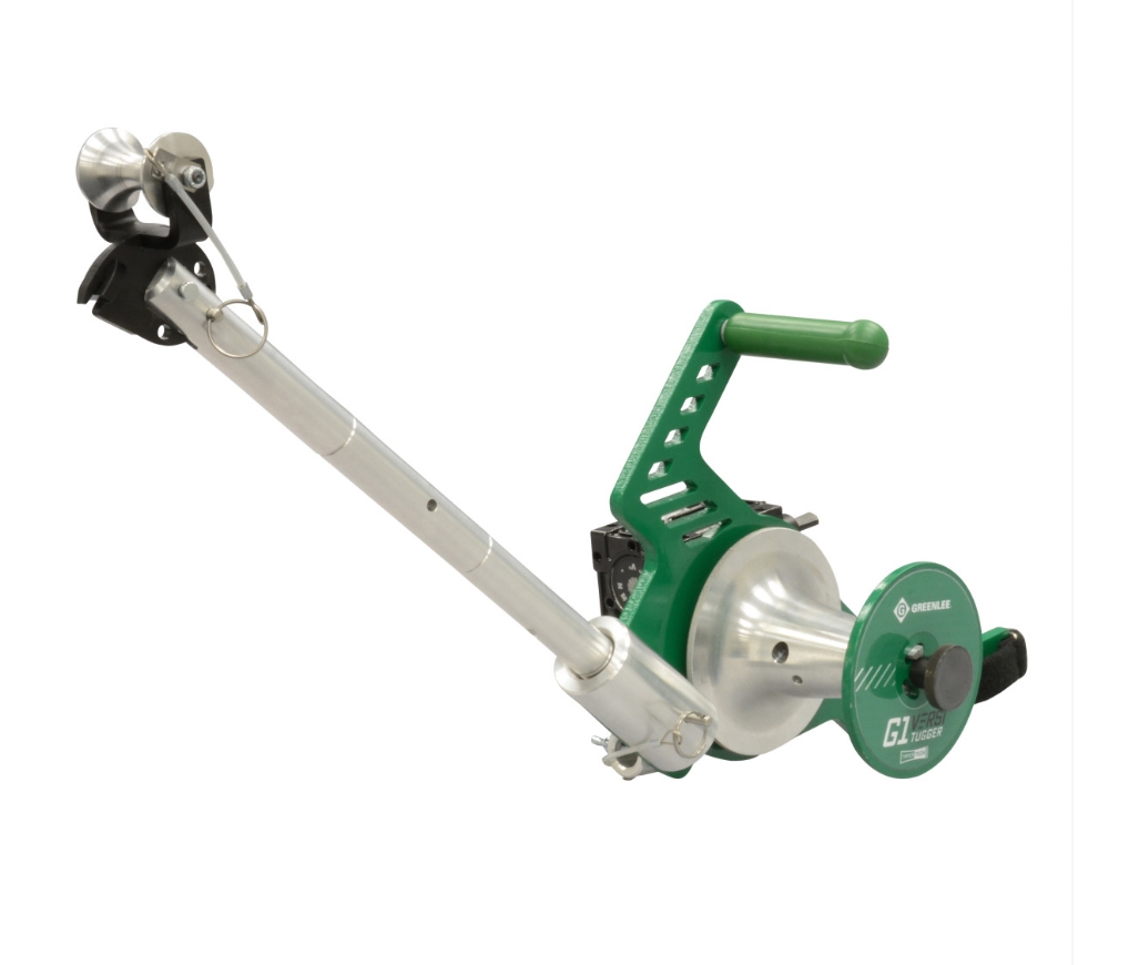

Also, if possible lay out the wires on ground and slip the conduit onto it one stick at a time and run it down wires. Youll hate trying to pull 140’ by hand.
I have a Greenlee wire puller myself, but i doubt anyone rents one of those.
Mine uses a cordless drill to exert 1,000# + pulling strength.

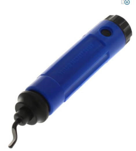

One trick I used was to take one of those wobble-style deburring tools and run it around the inside of the conduit to knock off the sharp edge so it didn't gouge the insulation. I noticed it shaving the insulation on the first stick as it slid along, so on the next one I used the tool to chamfer the inside of the end of the tube on the end I was feeding through. Takes 2 seconds to run a quick zip around the tube. Worked like a charm.

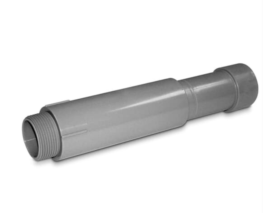

Also, check your local power company. Here, we have to install expansion fittings between the ground and the power box. This allows for expansion and contraction of the pipe in summer or winter. May not be necessary in your neck of the woods.
I also deburr all pvc pipe. Sharp edge will damage wire coatings if pulling 1 stick at a time.

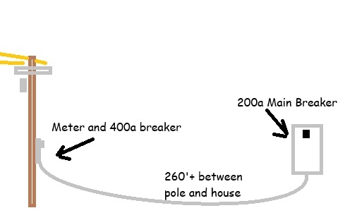

/ Confirming Wire and Conduit size #17
Do you recall what section of code that is in? I knew about sub panels but wasn't aware of the 1st breaker turning my cabin into a sub. I have this (picture) getting ready to happen by the end of summer. I do have a Coop breaker right before the pole month meter that i think is 400amp. A bit overkill. I plan to meet with a Coop guy soon next time I'm over there. Ideally I would like for them to run about 100+ of triplex and set another pole. If I have them put a 2nd service right by my cabin that's another $500+ a year for at least one meter mostly at idle. into a sub panel.
For that long of a run, you will need to upsize the wire that you run due to voltage drop. If it were me, id run a longer primary utility run towards the house instead of a huge secondary wire required for a 260’ run.
At 260’ to maintain a 3% voltage drop you would need to run
400kcml aluminum @ $2.30/ft x 3 plus smaller ground
250kcml copper @ $ 6.49/ft x 3 plus smaller ground
When planning a new service, we try and keep transformer within 100’ of the residence to keep from having to upsize the wire size to account for voltage drop.
